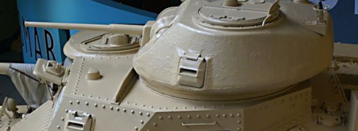

FYI, could be an illusion from the pictures but it seems to me the angle of the mantlet is a bit too steep and the cupola a bit too much up front.

lmcq11 wrote:FYI, could be an illusion from the pictures but it seems to me the angle of the mantlet is a bit too steep and the cupola a bit too much up front.
What part are you talking about? The turret? I just dropped that on the hull, so it's probably the angle of the dangle...

Re: M3 Grant (Lee?) scratchbuilt... or that's the plan anywa
Rob1970 wrote:hat part are you talking about?
The turret
M3 Grant turret
M3 Grant turret
