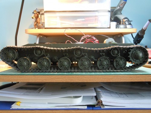

				Painless, pale, this is the newest kit from Juckenburg and it is brilliant as always. This is also my fourth "large" kit from him so kinda knew what to expect, but they are getting better. It took me a while to decide on this one as you know the IS-3 chassis is quite different than the IS-2/KV, and the overall dimension is also quite different (Much flatter and lower). After my KV-122 project which I used a Taigen metal chassis I liked it so much I decided to convert my old HL based SU-152 (Also Juckenburg kit) to the Taigen metal lower hull as well which leaves me with an old HL plastic lower so I decided to go for the JS-3. I was working on the lower hull while the kit is in transit, trying to figure how to lower it and tried all kinds of methods and then decided on the HL T34 solution (inserting a piece to reduce the travel) and lo and behold, when the kit showed up, the instruction from Christian to lower the hull was exactly the same !
The kit comes with all the uppers including the turret, plus the wheel covers for the road wheels and the sprocket, and a complete replacement for the idler. You used the HL KV road wheels inside half with the new cover, and you replace the hub for the sprocket. The idlers on the IS series is just another road wheel which is different than the KV. The kit has complete replacement for the return rollers and you have to relocate them to provide the lower suspension look. I actually think that the lower hull is the most realistic looking part of the whole kit. I kept the tracks the same length as it is so that there is the famous slack track look the Russian loves. Here is the picture of it during the build:

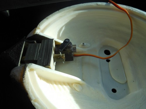

The upper hull snaps on top of the lower KV hull but it is longer and lower than the KV so I have to switch to low profile gears for it to fit which I didn't expect. I managed to find an old plastic set from the Tiger I while I wait for the new gears to show up. Christian always give you the HL size turret ring so I just need to add a rotation unit and a cog ring to the turret. The turret is absolutely massive in diameter (7 1/2") but it is very low profile. No way to put elevation and even the recoil servo has to be very efficient and simple. It is working right now but I need to fix the linearity at some point:

Thank you very much for the inside look at the kit!  That is a massive turret!  Any way that you can see to run a bar or slat back from the gun trunnion into the turret so you can suspend a micro servo from the inside roof to get some elevation going?  The Kit's detail is absolutely beautiful and that he foresaw using a KV hull as running gear and supplied all the wheel mods with it is amazing.  You really should add the headlight (I have turned into a lighting junky after figuring out how to light the spot on my Sherman) and tail lights.  I have been looking at views of the real tank and there are a host of details you can add should you choose. Enjoy, my friend, you really have something rare and extra cool there.  ;o)

I never care much for elevation but the pinion mount is actually much further forward, near the thickest part of the turret and is very difficult to work on. Even if I put in a pivot the travel would be very limited. As is now I can't even rotate the turret the full 320 degree because of the oil drums. It looks like it is at most 270. I will have to check out the reading materials and blue prints again as that doesn't seem right.
