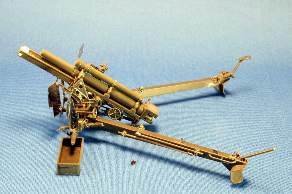

Thanks for the good words guys. This shows the complexity of what I'm going to have to scratchbuild
I'm going to need the 1/35 model to get the pivot points and details right.
Slightly daunting, but hey, I'll just take it a bit at a time. :crazy: :wave: Alwyn

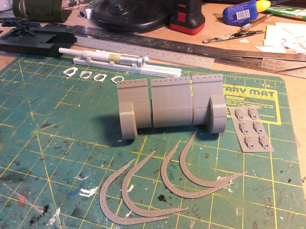

Made some progress while I wait for the 1/35 kit to arrive. Put together a gun barrel and started the cradle, built the back end which proved to be fairly straightforward working from the plans. The tricky part was making sure the upper and lower hulls still separated and went back together. I checked the storage to make sure the electronics all still fitted, but you sure wouldn't be able to get an IBU2 in there, it's a bit cosy! Because I'm planning full detail in the cockpit area then none of that is useable for the electronics. Well plenty to get on with! Alwyn

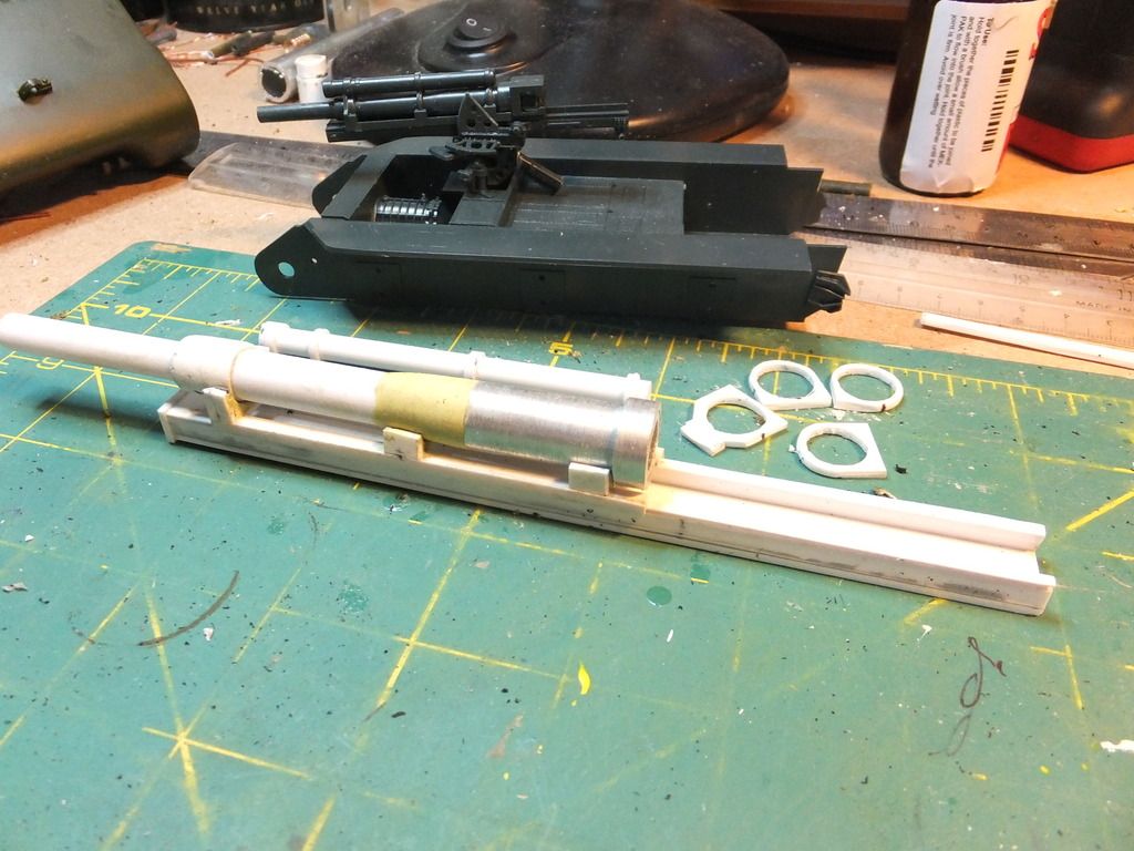

Some progress achieved but not as much as I would have liked. It's at that fiddly stage where it takes forever to work out exactly how things fit together, then fabricating out of styrene. The 1/35 model has arrived and I've put together enough to work out the gun mounting details. The barrel and cradle are almost ready for final assembly.
Just got the breach block to do.

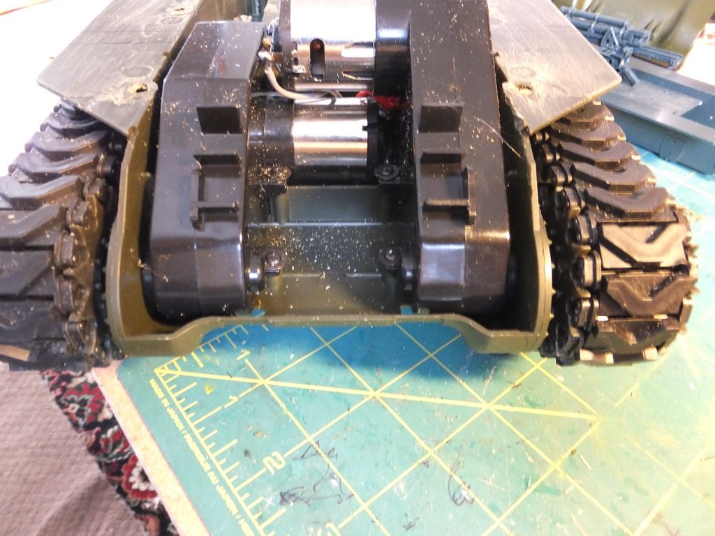

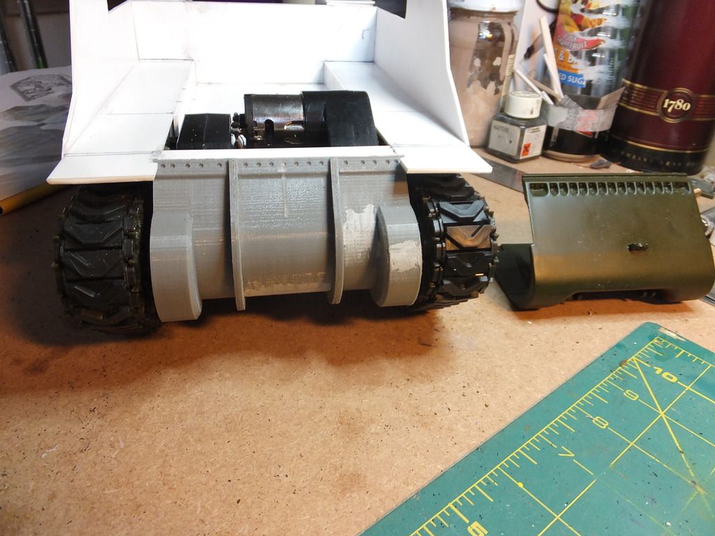

The old transmission cover came off
and after some surgery and general hacking away at the Mato chassis and gearbox covers, hey presto the Priest has a new transmission cover
There's a small gap between the new cover and the transmission but I couldn't hack anymore off the new part and the gearbox cover so it will be a Milliput fix (but only minor).
Next job is to fabricate the chassis mounting frame for the gun, which I can now work out from the 1/35 model. Working from plans is well and good but the complex parts of the gun mounting simply weren't visible on the plans. :wave: :wave: Alwyn

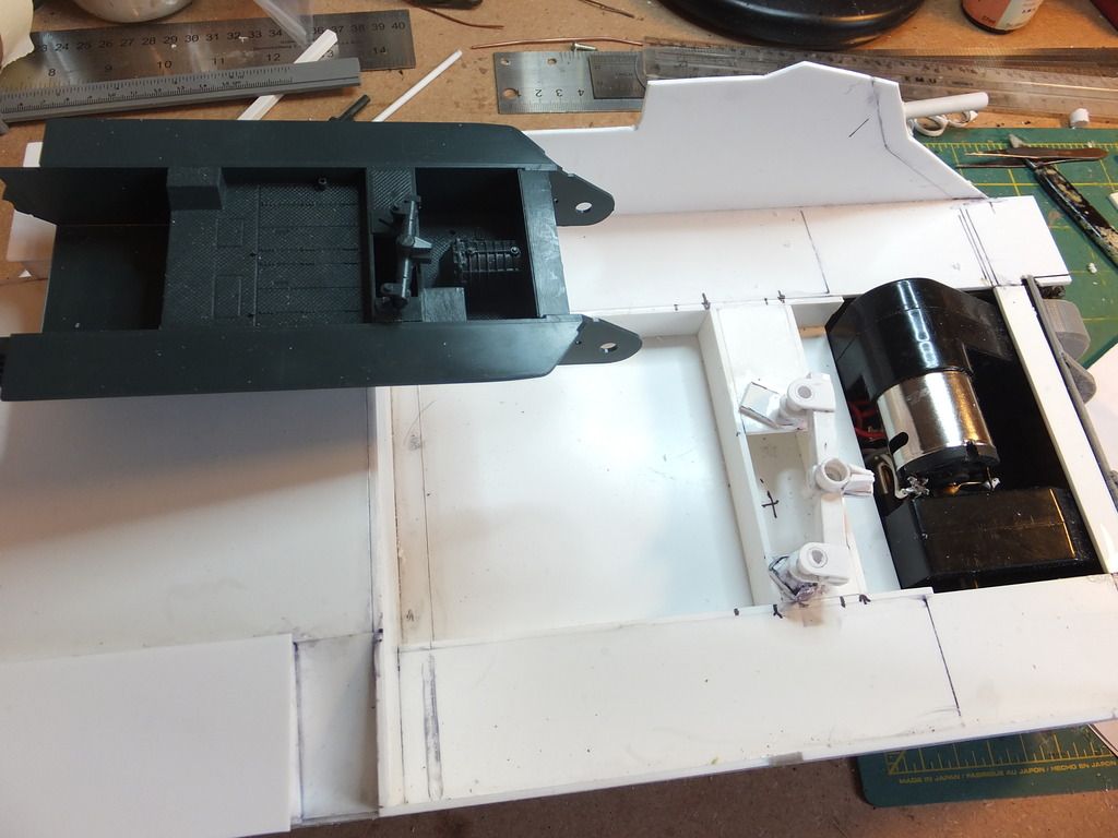

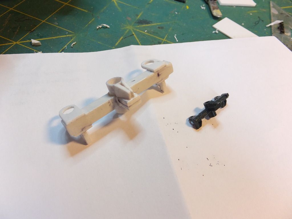

This build is proving 'interesting' in the same way as the old chinese curse 'May you live in interesting times'. I have now progressed to building the gun mount onto the priest body and the mountings are quite complex. Here is the base of the mount compared to it's 1/35 brother on the right.

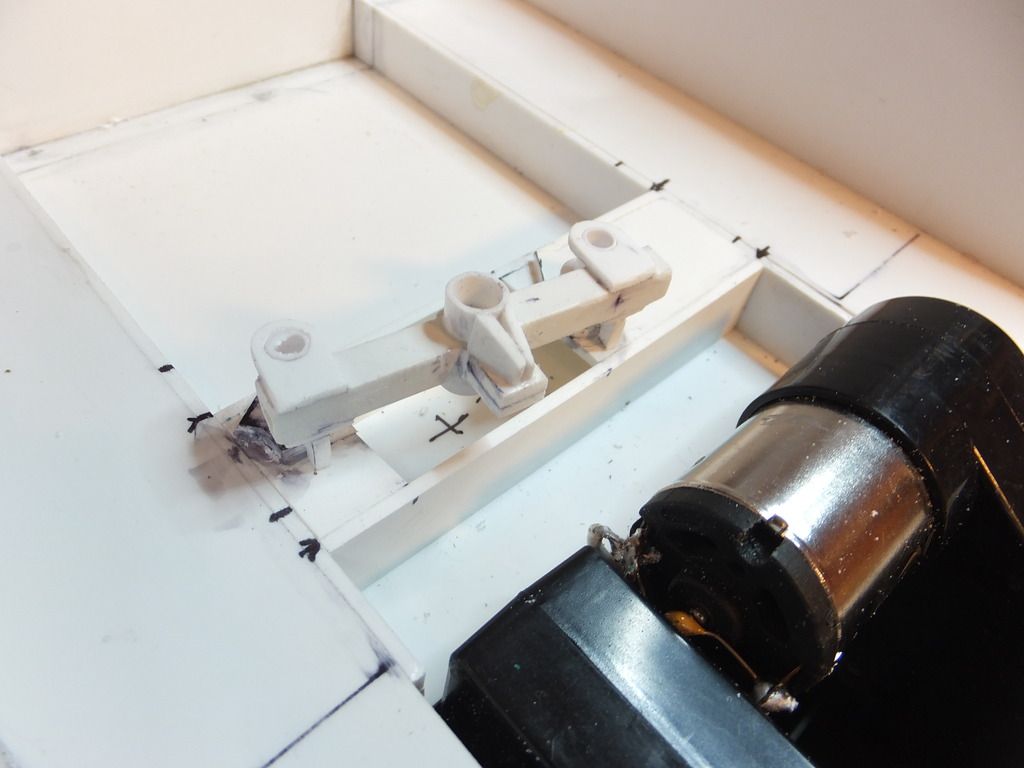

The mount in situ in the body. The body section that the mount base is attached to is removable with a couple of screws so I can remove the gun at any time during and after the build as I will need access to the modified micro servos that will control the slew and elevation of the gun.

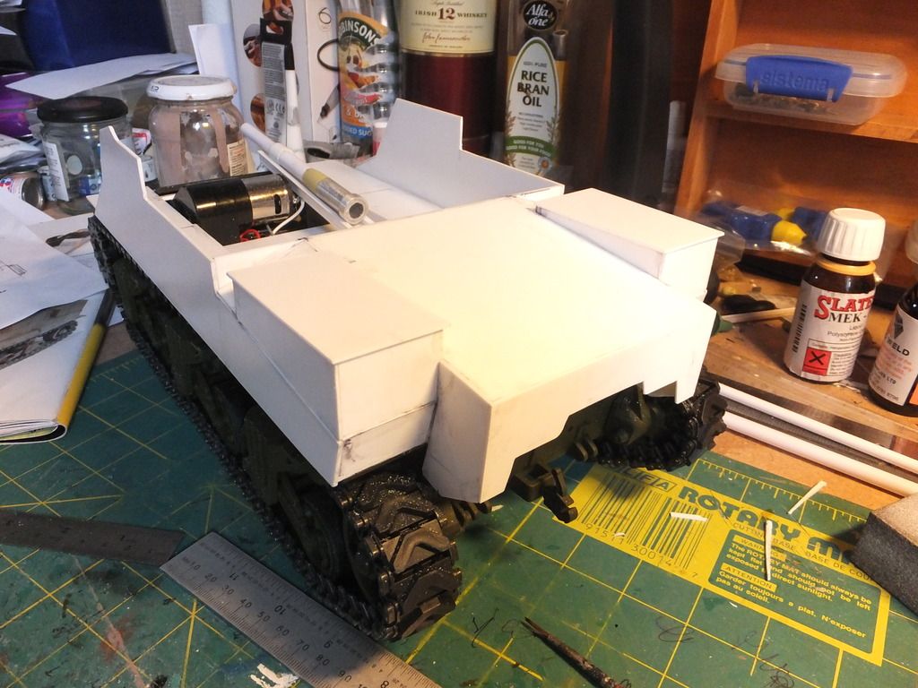

and the 1/16 body compared to the 1/35 body
It's interesting that because the slew of the gun was limited by the drivers cab, that they mounted the chassis at an angle to utilise the full slew capability of the chassis, I hadn't realised that until I got this far in the build. Anyway lots still to do on the gun.
