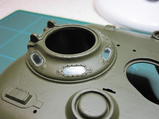

Sat down this evening and made the copula vision panels from clear styrene.
One in...five to go...
Made all six to one template then filed each one to shape as not all the cut outs were the same
Once they were a reasonable fit, I applied plastic weld to the inside ledges, letting it run down into to joints.
I think the scratches and smears that occured during fitting will give it a more used look and will blend in well once all is weathered. Thats my excuse anyway

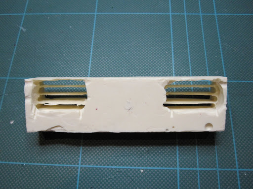

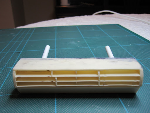

Deflector was a solid cast piece, so Ive already hacked out the back
to make the grilles open for the smoker to blow out of. I will cover the back over again with some styrene and insert some piping in to form smoke chambers.

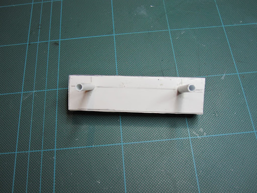

Fitted new styrene back plate and welded in some styrene piping that will extend into the lower hull.

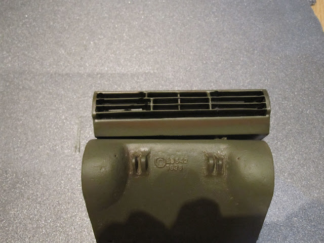

Gave the metal tracks a going over with Blackenit to varying degrees.
And coated up the new Nick Aguilar parts.
BFN
