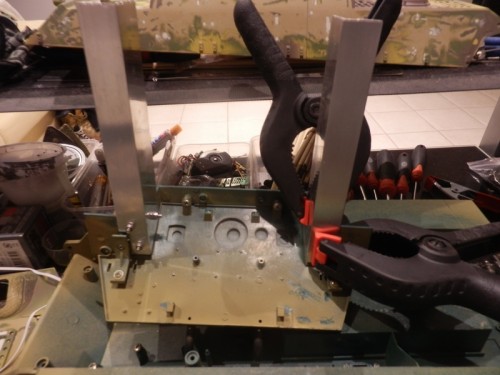

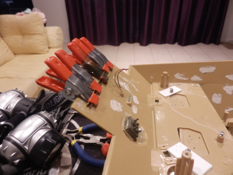

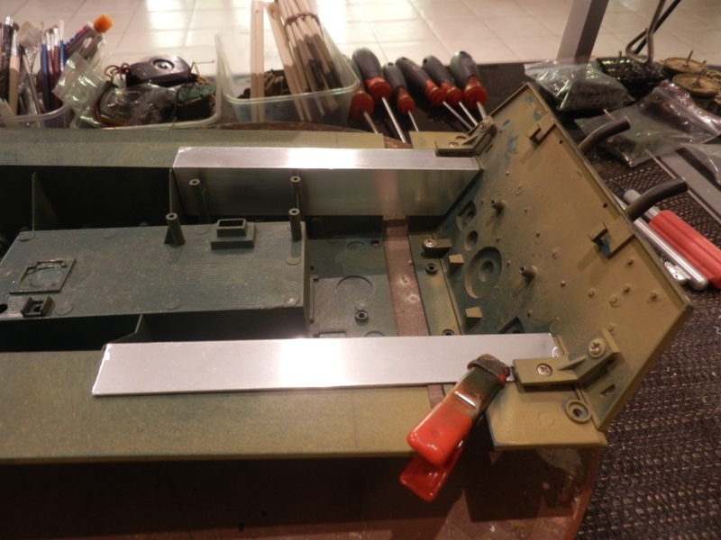

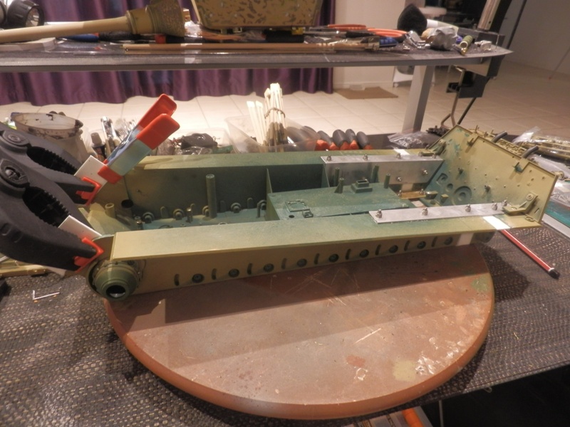

Going to secure the stiffeners to the rear first using 2 part epoxy & clamps. Then drill the bolt holes.
Once they are done I will clamp the rails in place on the main hull and square it off to the fixed points on each corner.
Thats all I can do to ensure the idlers are square and in line.
The epoxy will allow me enough time to square the assembly then clamp in positon ready to bolt once dry.

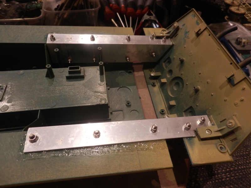

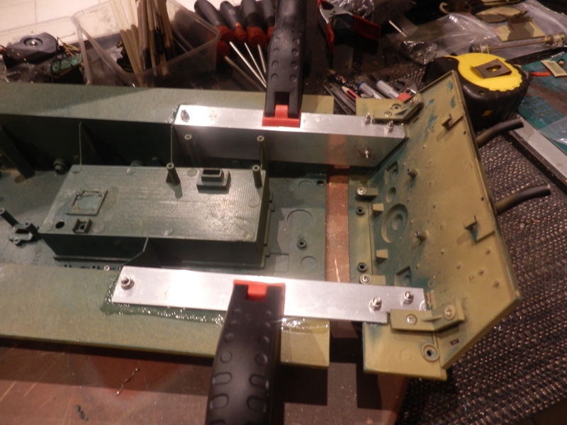

At last my S$%#t is together !
Secured the stiffeners over the epoxy.
No movement any time soon.
Still have to place the lower section and fill the gaps, but it could run as it is.
Measuring from datum marks between the drive & idler centres, cross measuring off the sponson corners, and to two marks scribed on the sponson pre-cut to the rear plate mounting holes I'm within a mm.
The bolts are placed so as to miss the track run on the inner edge, and the lower row be hidden by the roadwheels.
The interesting bit will be getting the tensioner to fit and operate.

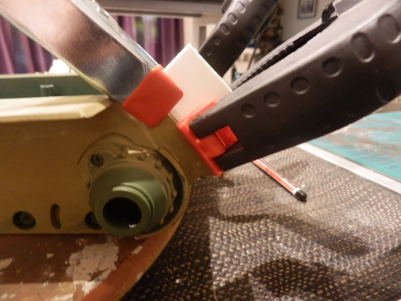

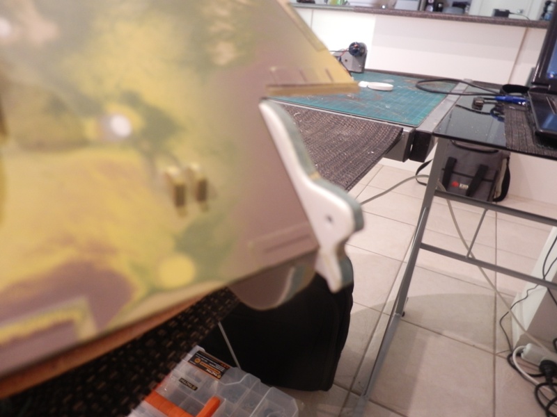

Been mulling over how to secure the front of the hull to the lower once the alterations are complete.
The front plate is slightly bowed, so I etched the inside of the plate, and a length of C-section brass.
Used gel super glue and clamps to secure the C-section to the inside of the plate to take out the bow.
The outer edges lack the moulded in guides that locate the glacis plate in place, so I gel-glued a 1.5mm piece of styrene inside the lower sponson plate profiles.
These will be shaped to match and I will do the lowers as well.
Once the flame marks & welds are done you should not be able to tell, but they need to be there to align & secure the front plate of the Matorro upper to the donated (Thanks again Mr Jackalope) Taigen lower.
As the upper is still going to be secured to the lower with screws through the sponsons and into the factory mounts, I can retain shape and strength of the stretched upper .

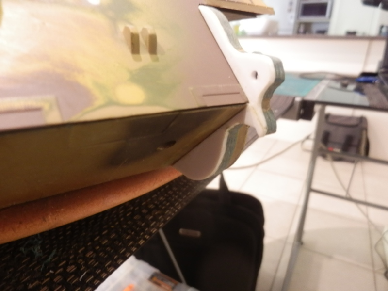

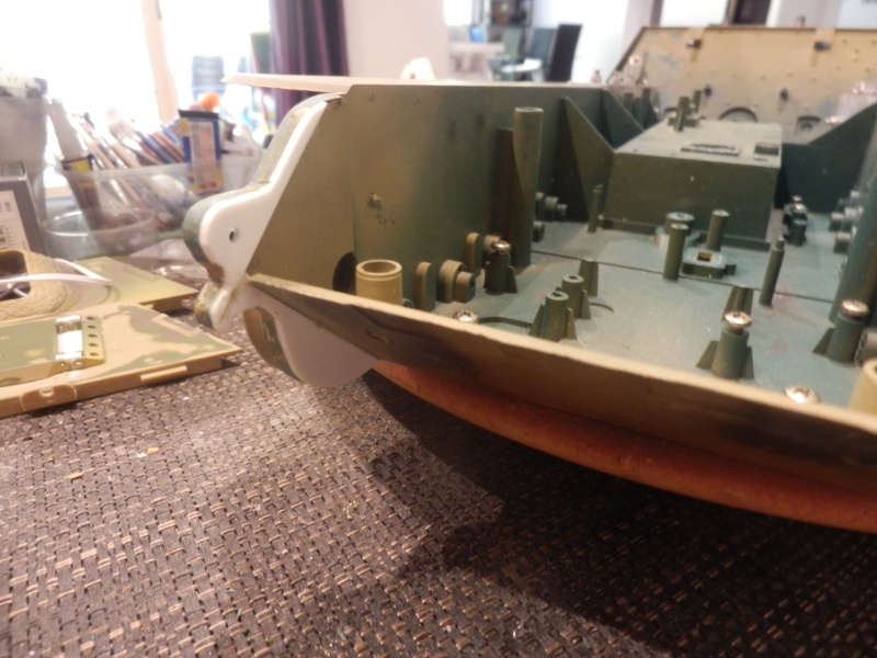

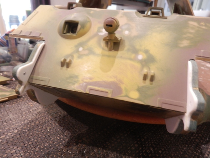

After curing overnight I profiled the add-ons to the lower hull.
I have run out of material to carry on with the infill on the rear so I discovered :{
Once the flame marks and welds are put on they should look right.
And it worked a treat to retain the upper glacis in the right spot.
