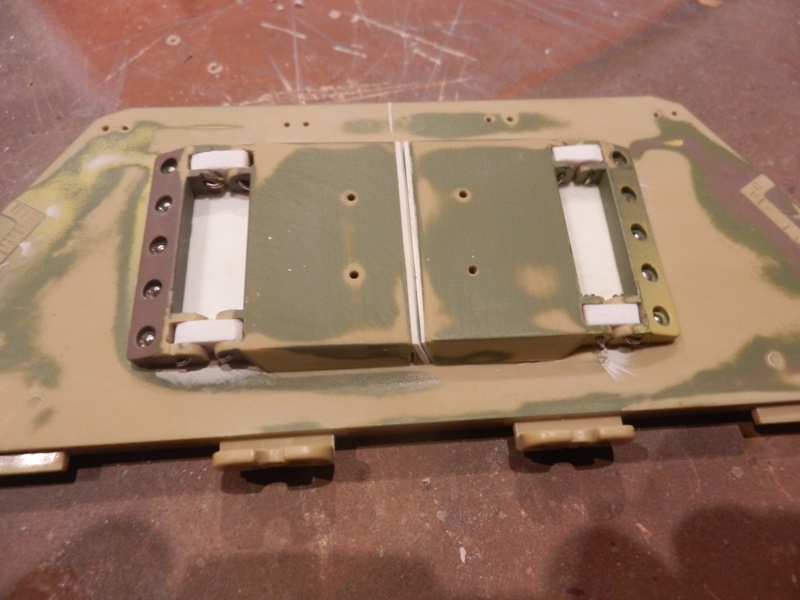

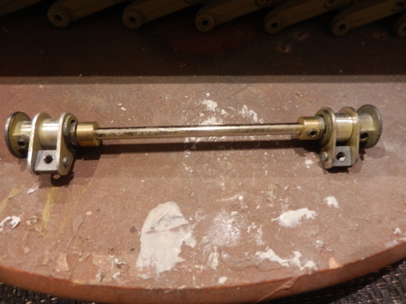

Got the rear doors done and mounted to the rear bulkhead of the casemate.
The hinges work a treat, and the doors stay put in any position.
Used dress making pins to anchor the door mounts and ensure they wont tear off any time soon.
Also made a start on the forward hatches.
This is my last day/night as Mr Mum while shes away at a hockey champs, so I need to rebuild the house, burn the washing, hose the kids off and replace several bits of furniture
