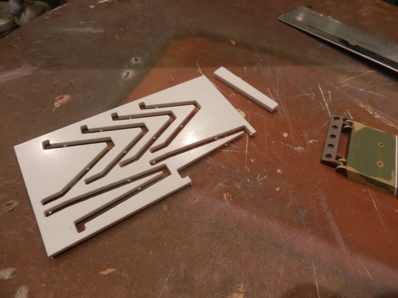

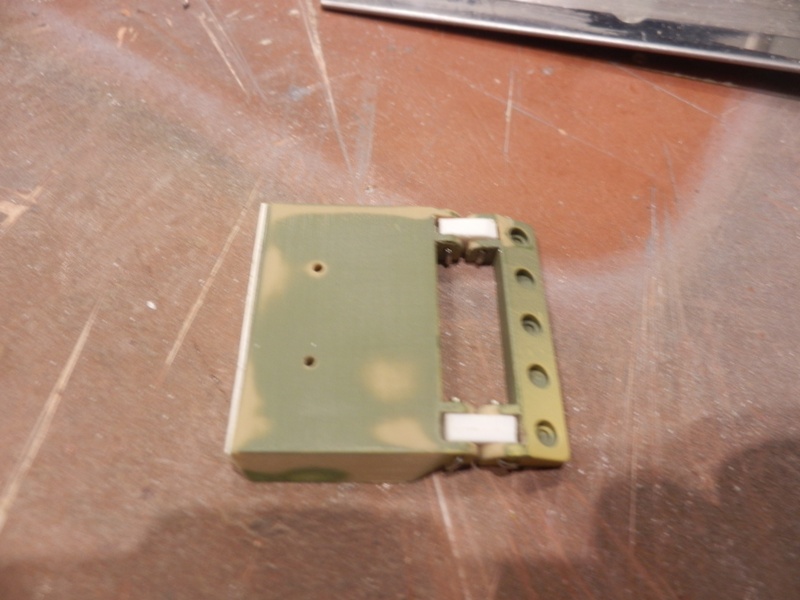

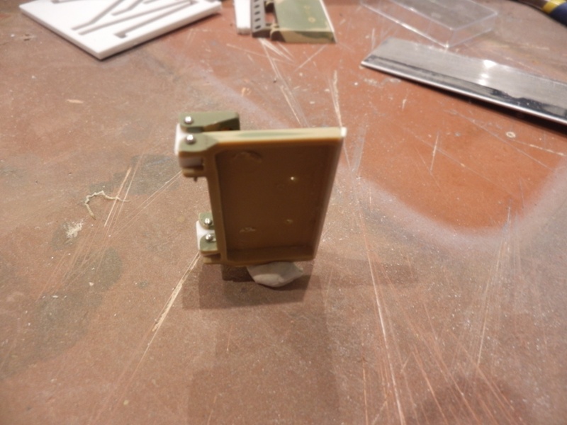

Rear door hinges completed.
Used a bit of left over Schurzen sprue from my Pig-StuG III.
Filed the corners off so as to allow slight interference when they are being opened, so they satay where they are left.
Hit the hinge wings with a 0.5mm drill and slid a dress making pin into place.
Bent the tail of the pin over at the bottom and nicked the end off with small side cutters.
Not exactly historically correct, but the stuffn doors will stay put ;)
Plan to drill the moulded sockets into the rear plate and use the same pins to add strength to retain the doors.
No sure why I need them to open, but I'm glad I did it ! :eh:
Drivers and radio/MG hatches next.
