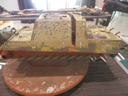

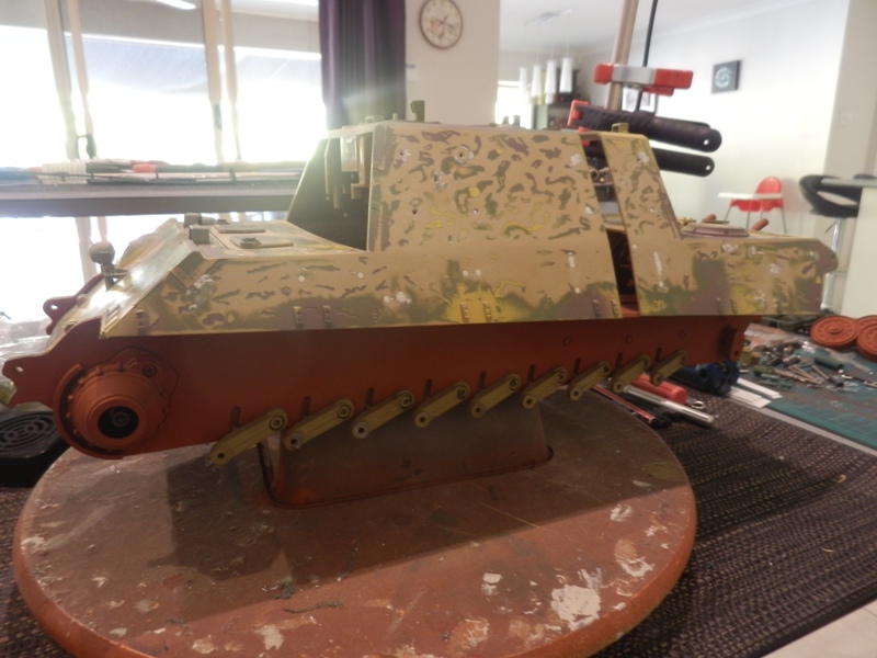

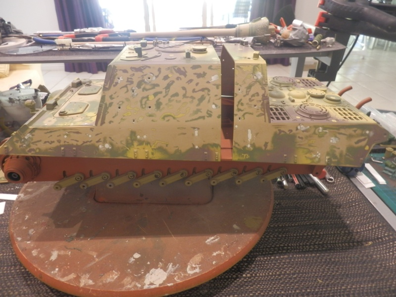

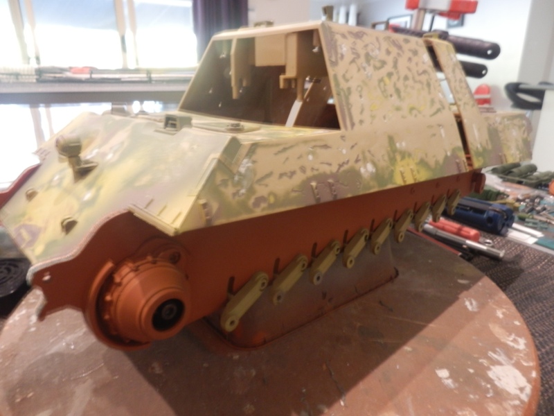

As all the joints will be glued, its going to be extra important to get the jointing right, and the backing material broad.
I might even use glued brass in places.

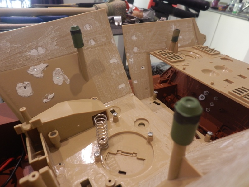

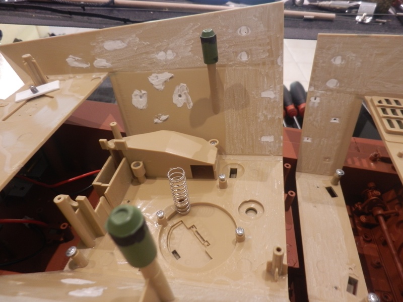

I was having a bit of a creative barnstorm on how to secure the upper hull to the lower, without magnets, and a simple case of "how do I make the existing hull fixing points meet the new lower" raised its head.
The hull fixing posts are 6mm diameter, and I was just mulling things over while I cleared a bit of flotsam off the table.
A Eureka moment ensued............axle hubs !
Yip, redundant axle hubs from the donor suspension.
Drilled the open end out to suit a press'n'turn fit on each post, after checking fit several times.
The two front posts are shortened and holes drilled in the sponsons.
I prefer screws to secure the hulls on my tanks, but its not without risk or course.
Now I can secure both sections of the slit upper into position, clamp them off, remove and start the joining process.
Last thing I want is excessive gaps in the major areas like glacis and rear engine deck.

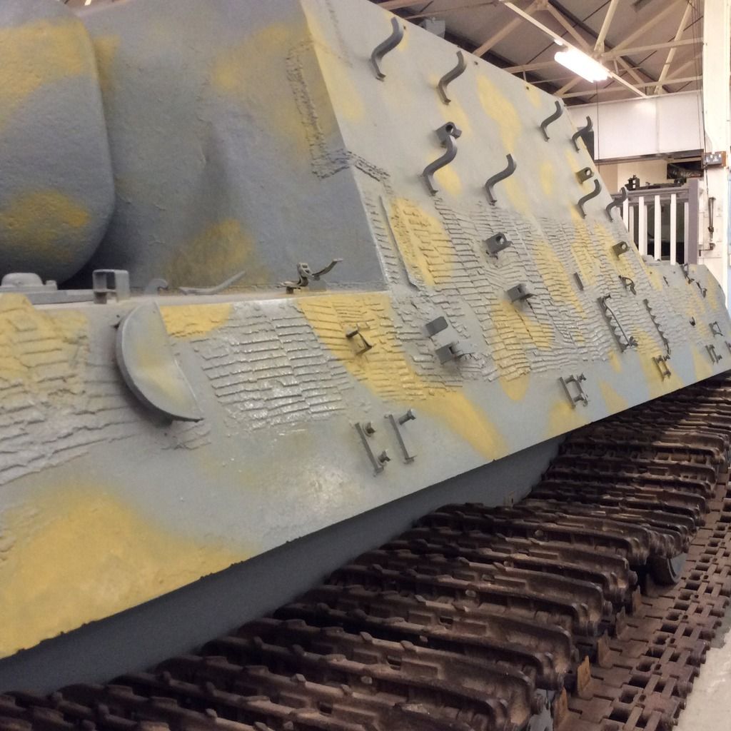

Hi Herm may I ask a question? Are you going to do anything about the side profile of the JT ???? Regards Andy

I considered it, but thought that no matter what I do, its going to be a cluster of parts & processes to turn a pigs ear into a silk purse.
So, to at least keep a fraction of the donor Matorro tank, that really should have been kept intact for posterity, decided not to alter the side profile, but I did reduce the sharpness of the transition to visually improve the finished look.
Otherwise all I would have left is a rear engine deck, rear casemate bulkhead, front bulkhead, upper drivers roof & front upper glacis !!
Hardly a Matorro at all :/
Might as well have kept it and cut an H/L KT ;)
I am lucky to be in a position to take advantage of donated parts as well, where these have been converted by others without the luxury of so many options for parts. Ive seen one from days gone by that used a full metal Weoche lower however !
As long as it looks right, and doesn't cost more than a Torro-in-a-box to get there, then I'll be happy.
