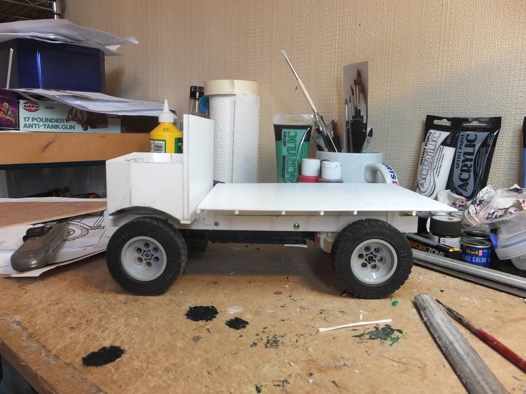

All good today as the rc is still working perfectly and work progresses on the load bed. It's starting to shape up now but still lots of work ahead.At least with the rc problems resolved it's down to pure modelling.

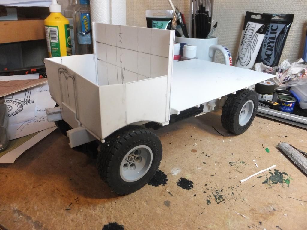

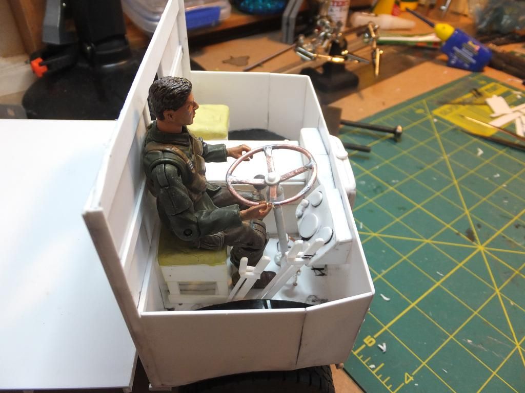

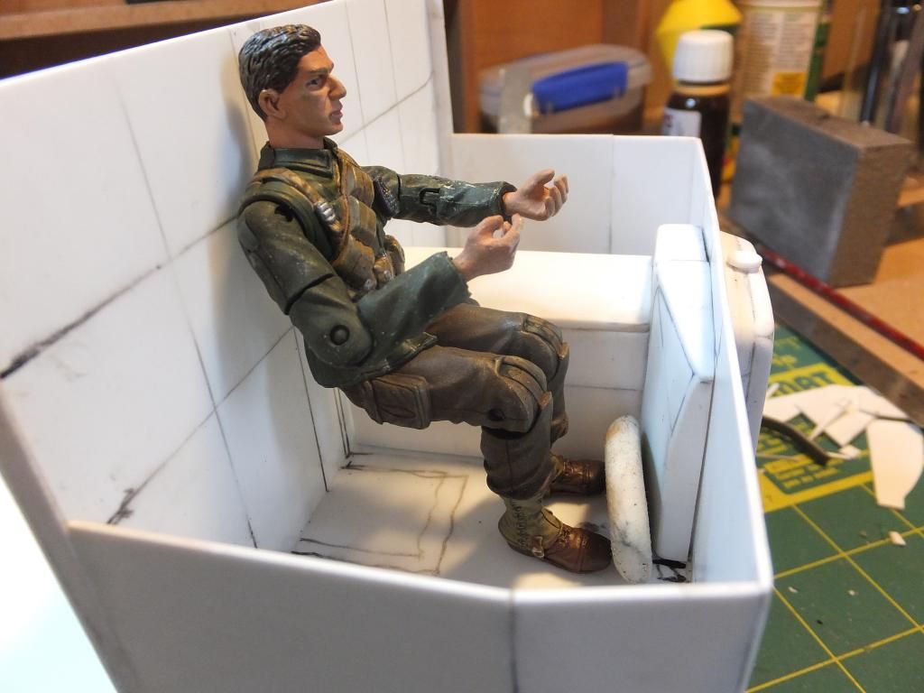

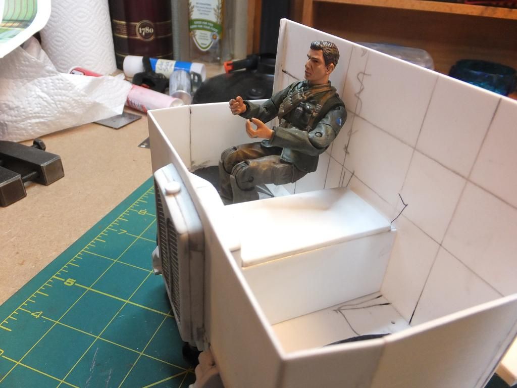

Well some progress achieved during/despite the festive activity and alcohol consumption. The driver (Arthur) has joined the project early as cab design consultant so this time I shouldn't have to amputate any bits. Doesn't look like much progress but the radiator and engine cover were a bitch to get right.
Onward with the dash, footpedals, steering wheel, gearlever, and handbrakes. I suppose I'd better give Arthur a seat too!

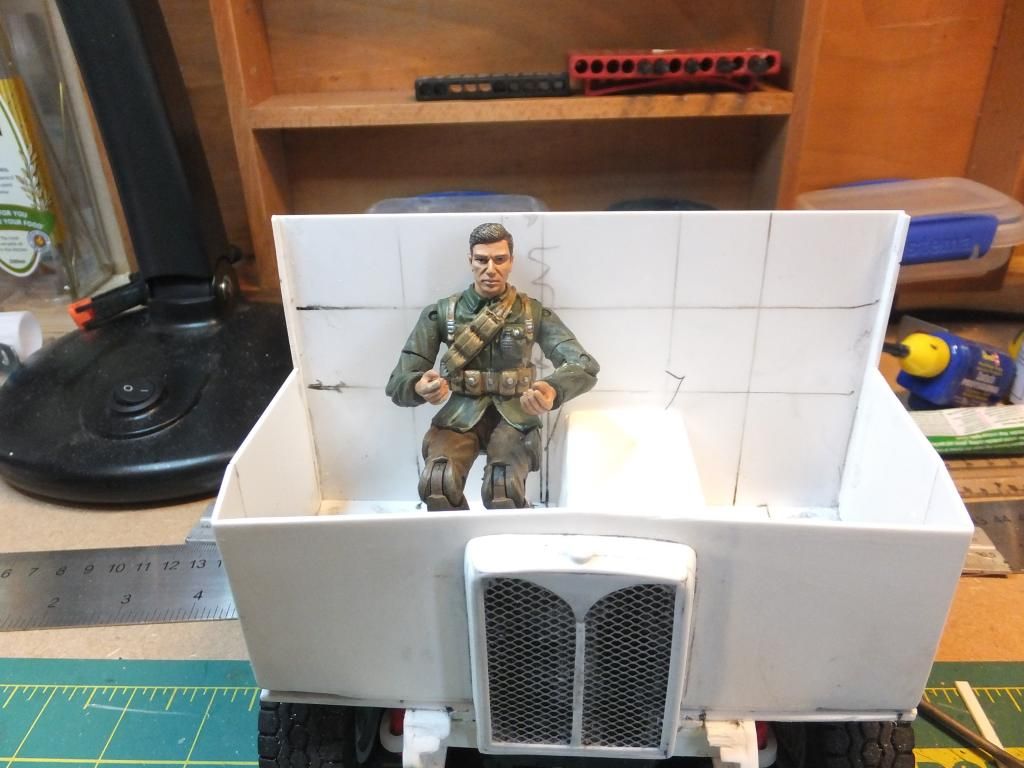

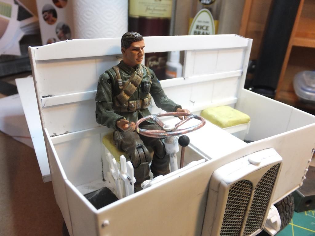

Some progress on the cab. I didn't realise until I modelled it how 'busy' the matador cab is, it looks huge until everything is in.
Now I can start on the cab frame/roof.

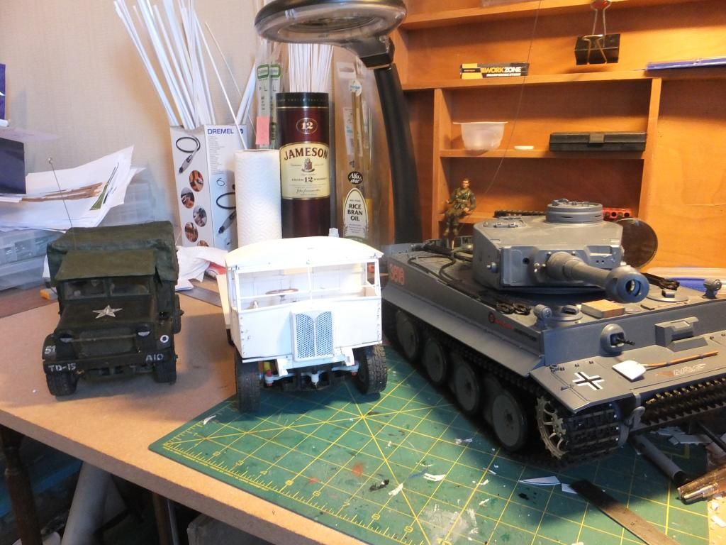

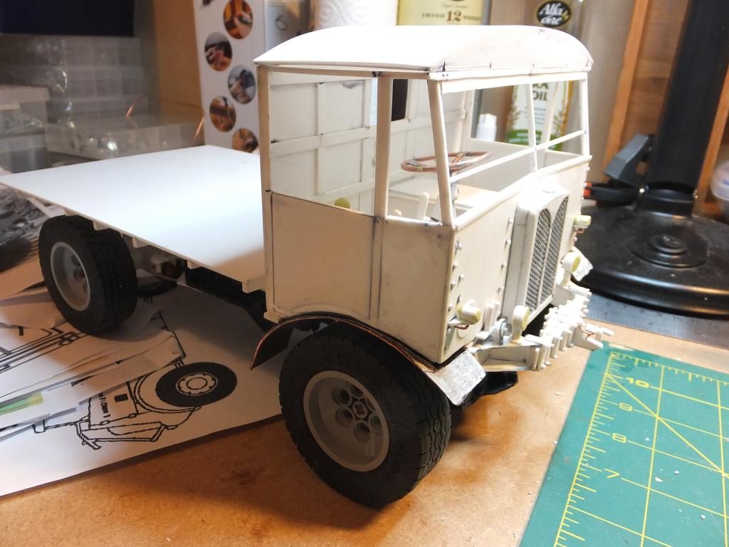

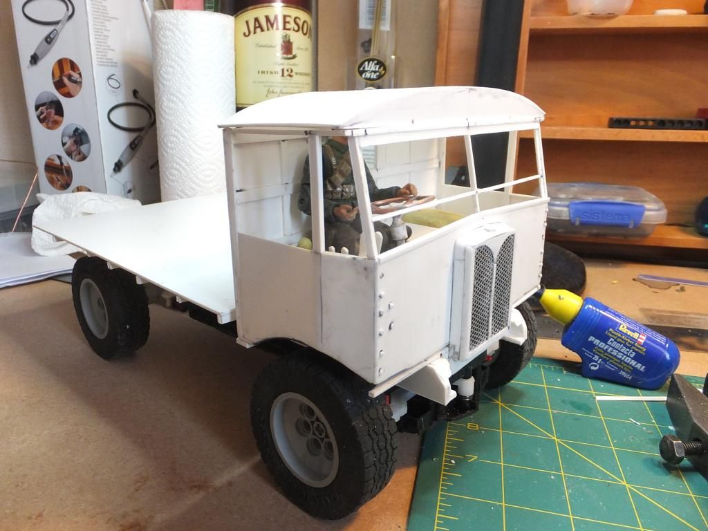

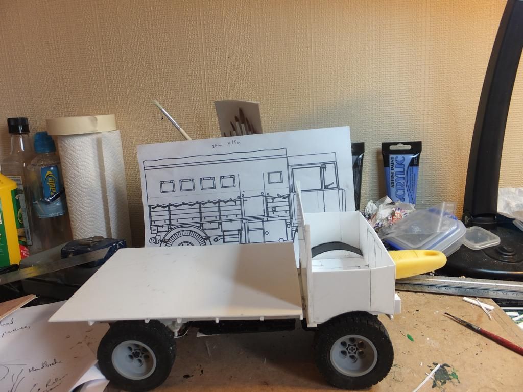

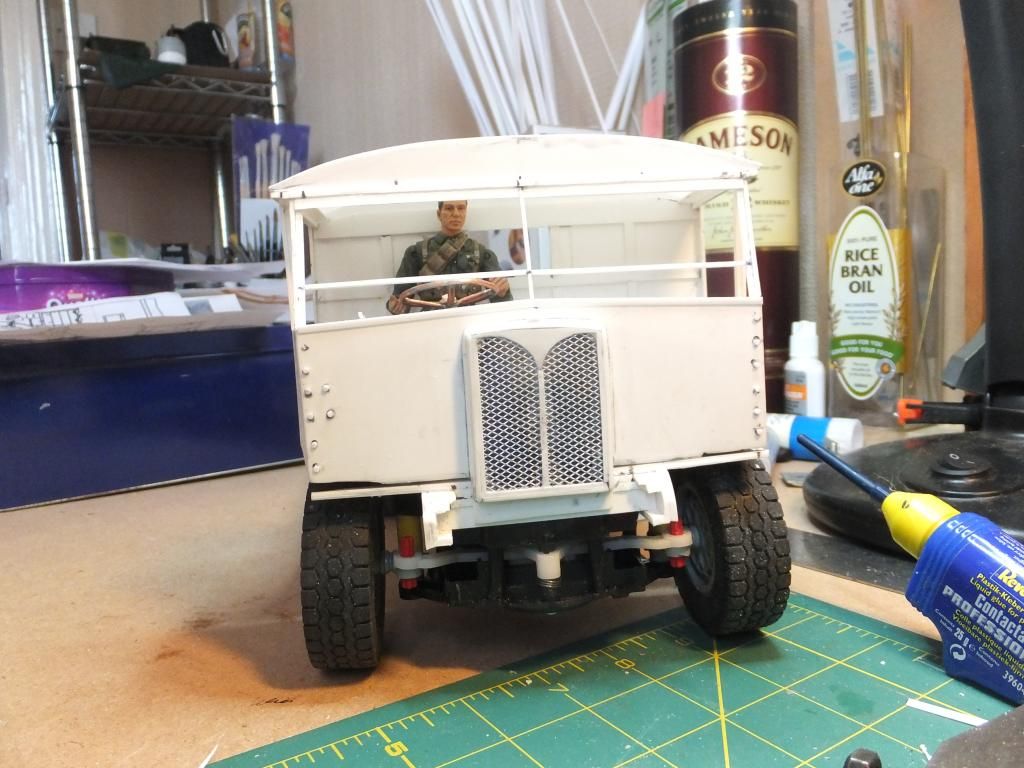

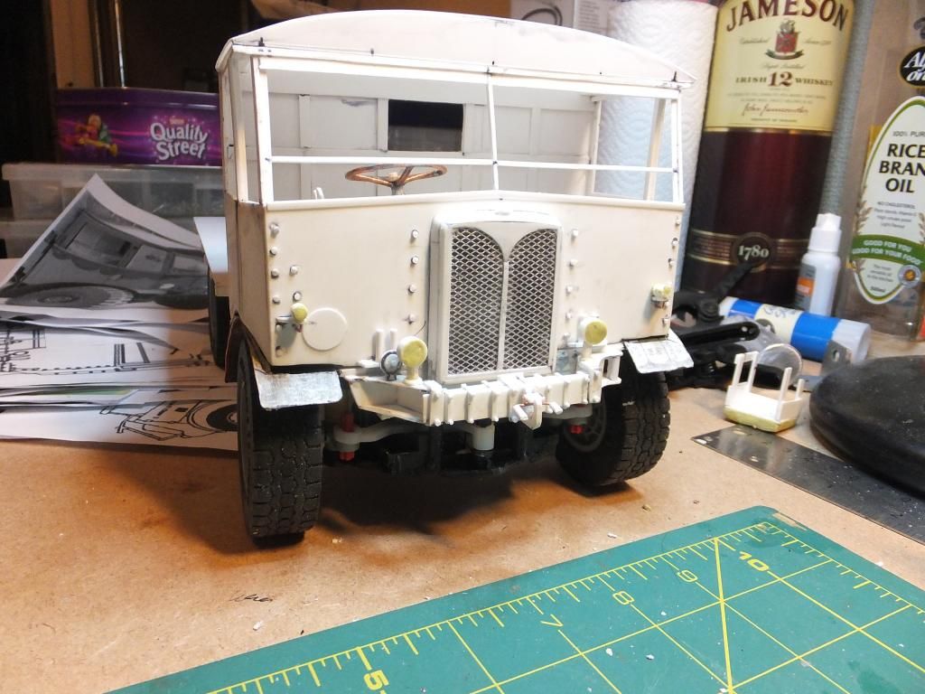

Progress to date. Cab is progressing but still needs lots of work. I'm not putting windows in until after the cab interior is painted.
and against the other models for scale
Starting on the chassis next.
