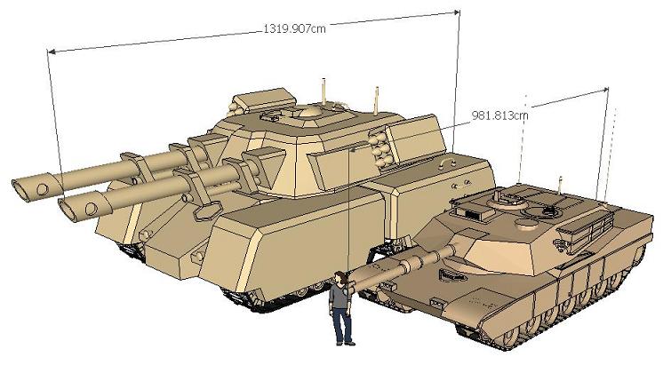

I don't think I need to name what I'm building if you're a gamer yourself so here are a few pics. First a comparison shot to show what I'm aiming for as a final size. I've scaled this from original artwork only using a lot of maths and lines (I don't know what it's called, its when you use a known size of an item in view to detrmine the size of other objects at different distances...) So here it is with a civilian and an Abrams for scale...
I know, I'm crazy right :D

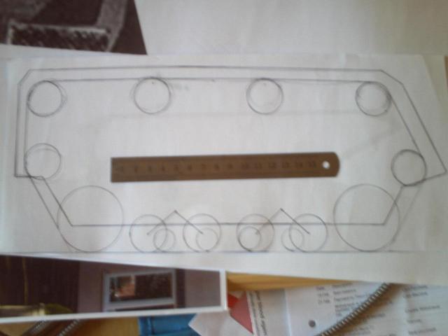

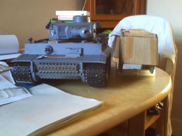

I've already mocked up one of the four identical track carriages to try and help me figure out how the running gear might work so here are some pics of that by my Tiger for comparison. (It's sat on a DS box to account for the final height inc. track)
The biggest problem I'm having trying to imagine this in RC form is the fact that the tracks are rather unusual and the best drive wheels are at the bottom, in constant contact with the ground. That would make them unsprung (unless the entire gearbox was sprung) and also the location of these wheels BELOW the lowest point of the hull gives a further issue. Here's a quick image of what I see as the 'ideal' solution per track;
My only thought so far is that the gearbox can be placed normally inside the hull and then attached to each drive wheel via a drive chain from the final gear. The drive wheel could then be sprung using the final gear as the location for it's origin of rotation (therefore keeping the chain/belt taught at all times despite elevation of the wheel)
Further thoughts are that each track will need at least one gearbox so it's instantly very hardware heavy. The sketchup image above (not mine by the way, compiled from other artists work to be in scale) is NOT exactly how I plan the end product, the main difference being the 3 bogey wheels shown. I want 4 per track as that is hat original artwork shows. I think 2 pairs per track would be best, as illustrated in my doodle!

Construction will be rather straightforward as you say. It's just a case of getting the dimensions right and as I was lucky enough to find this sketchup model in very close tolerances to the original art I shouldn't have a great deal of problems in the planning stage. Will be more likely to falter while in the process of trying to make it a reality I'm sure!
