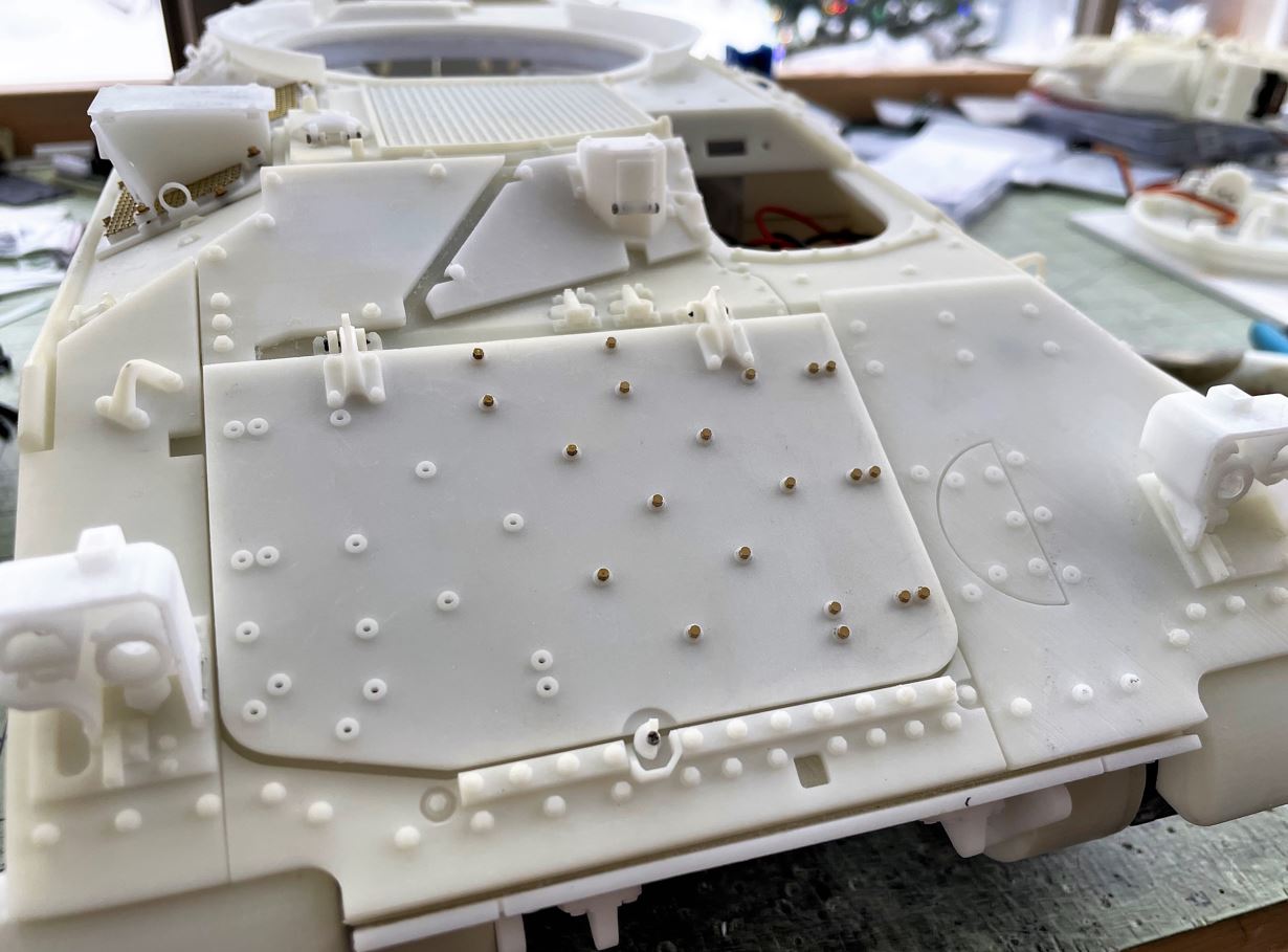

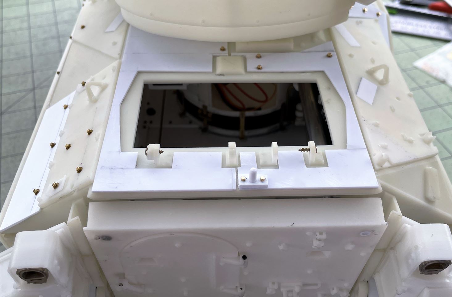

Here is a progress report on the exterior of the vehicle, including the turret.

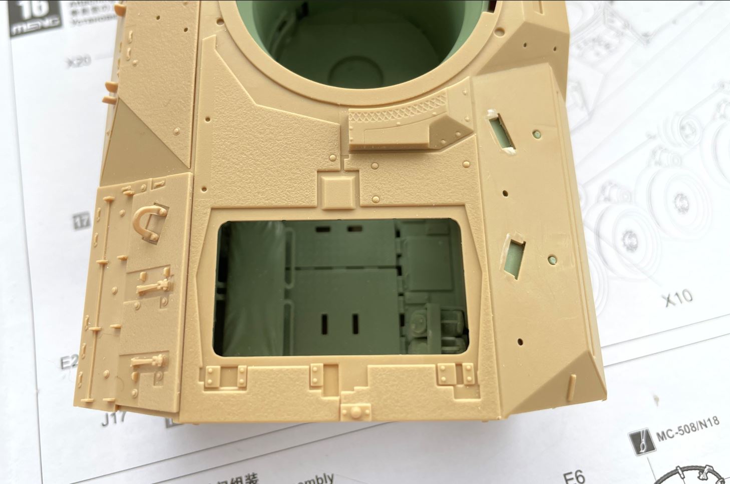

As seen in reference, bolts need to be mounted on the engine hatch. Although small screws are provided with the kit, these must be hex bolts, M1 were used.
M3A3 Bradley US Cavalry Fighting Vehicle - RC 1/16 Build
The completed engine hatch. Those tie downs were positioned as seen.

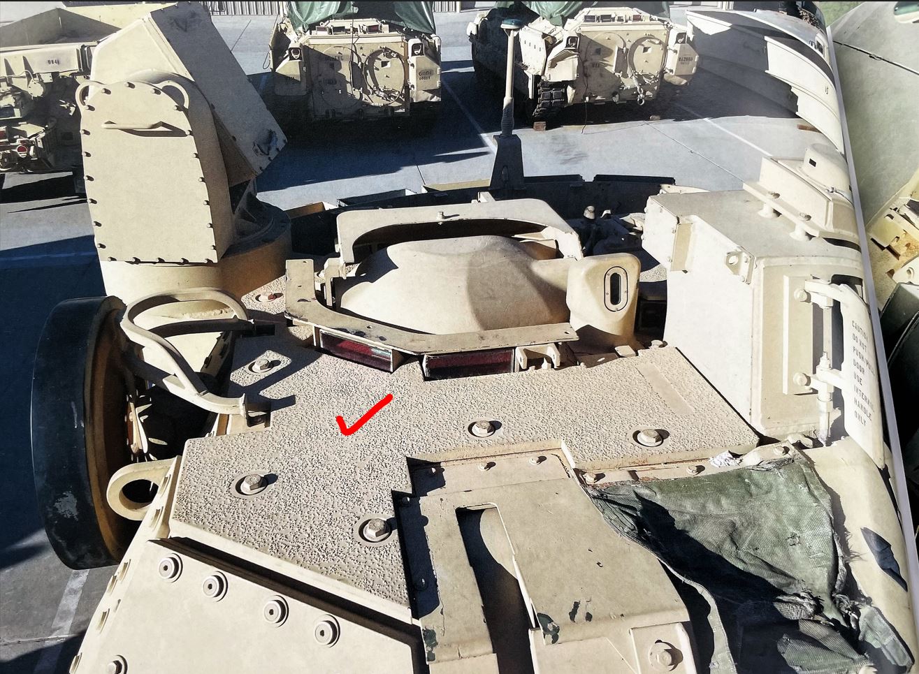

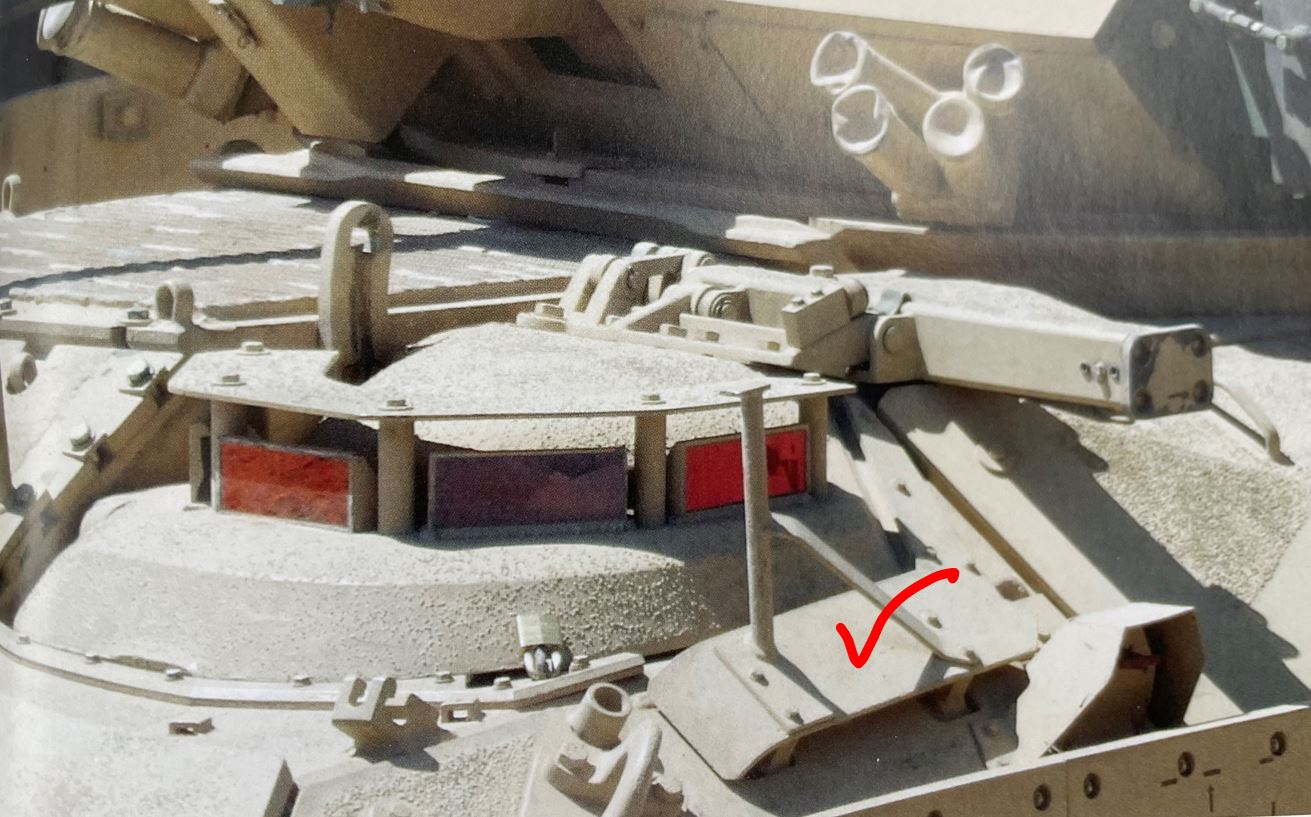

Supplemental armor should be on the rear top as shown on the Meng 1/35 kit.
Repro in 1mm plasticard. Adjustments were needed in order to adapt to the model. I did not redo the hinges for the top hatch.

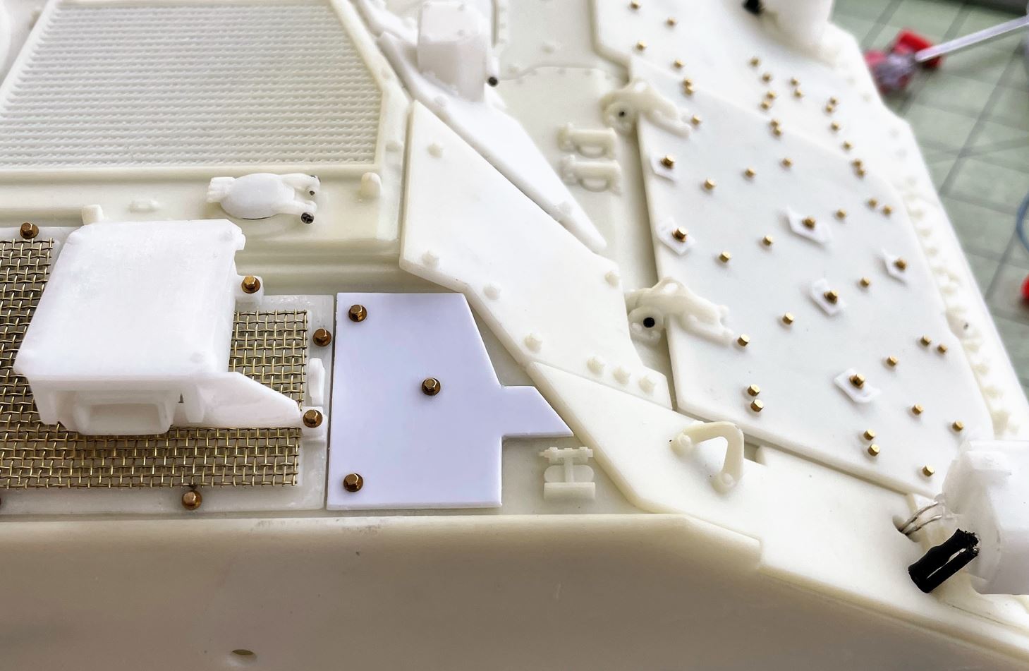

There was a missing plate on the right of the exhaust stack.

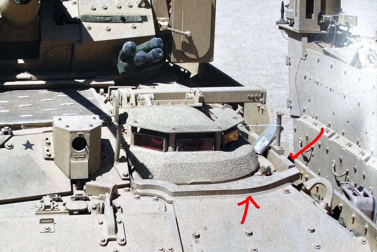

There was a missing plate just behind the driver's hatch.
At first, i thought that the surroundings of the kit M2A3 driver's hatch were totally inaccurate. Not happy and I was planning modifications.
But then i noticed another picture of an M2A3 with a totally different setup, matching the kit. Good news.
I just did a small update and repositioned the small box for the fire extinguisher handle. Small thin parts provided in the kits will be added at the end of the build just before painting as they would be damaged during construction. The hook should be over a small plate but i did not do it. Removing the hook from the hull would break it completely.

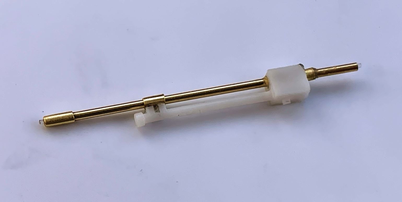

The 3D printed machine gun was not strait and could not accept a fibre optic cable for flash. It was replaced by brass tubes with a fibre.

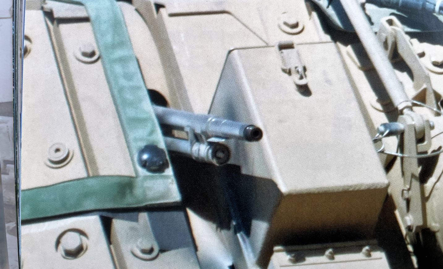

As seen in reference, the top of the turret has an add-on armored plate. Notice the tarp over the chain gun, something that will need to be reproduced because there is currently a large hole at that location that looks really bad.
It is not provided in the kit. It might be optional but was seen in all pictures.

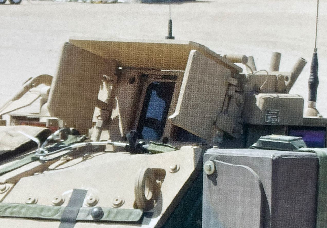

The optical box on top of the turret. There are different variations of it.

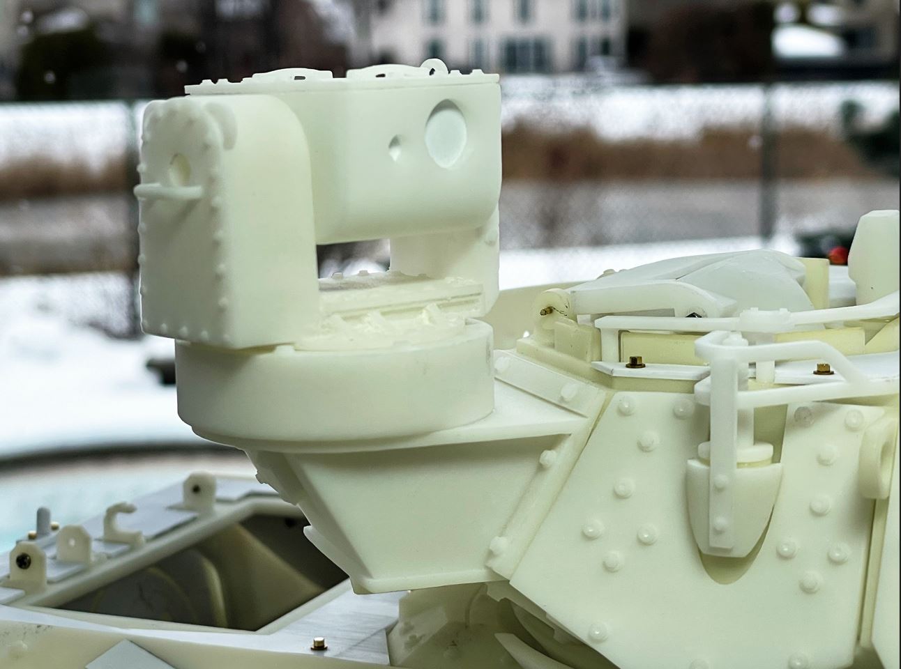

The parts for the Commander's Independent Viewer needed to be given a brass pivot in order to be flexible and swivel.
The CIW is installed. It can swivel and the optical can be raised or lowered is stored position. I assume that smarter people could find a way to make it RC operable but the interior is very small and it would be very difficult. The CIW is huge and there is a lot of add-on armor that is increasing the weight of the vehicle. No wonder the performance of the Bradley went down compared to the initial version.

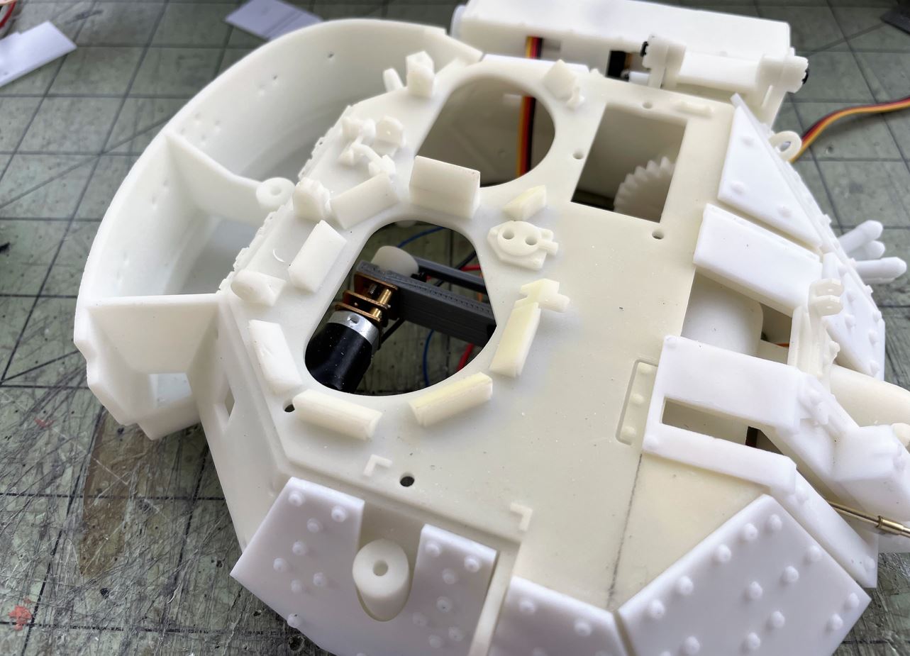

The TOW launcher has a servo inside. The servo needs to remain accessible for maintenance. The molding of the TOW launcher is not totally accurate and could be improved. I also have to install brass bolt to make it close, and keep it closed properly.
