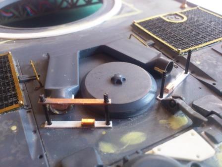

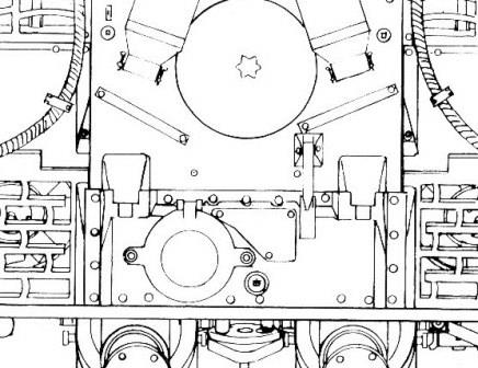

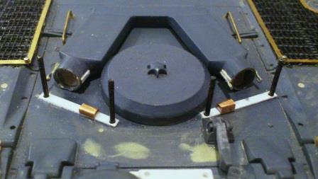

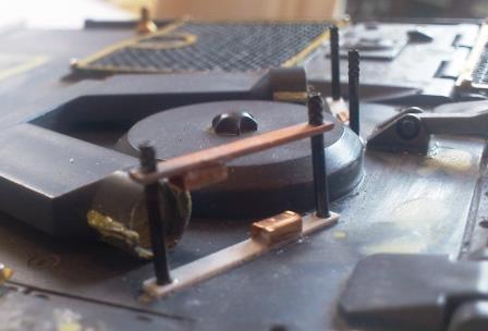

Engine deck: Feifel air cleaner trunking and retaining brackets
Although the actual Feifel air cleaners were no longer fitted to Tigers by the time mine was built (October 1943) the trunking and brackets for the air hoses continued to feature on mid-production tanks until the appearance of the gun travel lock (which would have blocked the starboard cleaner anyway).
The original HL tubes are held onto the decking in roughly the right place by two over-large brackets, although the Tamiya RC kit is actually little better (however the Tamiya sprue does have a better scale alternative without a screw attachment which was presumably for the static version of the model).
The real tube clamps consisted of partially threaded rods with a fixed lower bracket and movable upper bracket held in place by bolts. Each of these brackets had a rectangular shaped 'chock' which ensured that the outer tube stayed flush with the engine deck while the inner one was raised a little higher.
The lower bracket was easily made from plastic strip of suitable width and thickness, but I decided that the upper bracket really needed to be metal otherwise it was liable to warp or break. Although I have various bits of brass strip I found that part of large staple from a Jiffy bag was just right. This also proved rather easier to drill into using my hand-held rotary tool (made easier still by first taping down the metal strip to a cork block).
Meanwhile the rectangular 'chocks' were fashioned from thin brass strip. Like all my metal-to-metal or metal-to-plastic joins I used Unibond Repair Extreme Power Glue which dries with a certain amount of elasticity but allows any excess to be easily shaved or sanded away.
The rods themselves were a little more of a headache. Clearly what is needed here is some partially threaded brass rod, but I have no idea where to find it and I bet it isn't cheap. Then I had a small brainwave - using track pins. These are the Taigen ones that come with their metal tracks and they come with a fairly convincing thread pattern at one end. Having cut them to size they were inserted into holes drilled through the lower brackets and the hull with care taken to ensure they were straight - and the same height. Then it was just a matter of inserting the upper bracket onto the rods. Luckily it was a perfect fit! Since my Tiger is hardly factory-fresh I decided to save myself some work and leave the starboard upper bracket off - after all these had absolutely no useful function without the Feifel system installed and, positioned as they were on the hatch cover, would have been liable to damage or loss.
As I understand it, without the piping in place, the upper bracket would simply slide down the rods, although since mine remains movable I'm going to hedge my bets! All that remains are the hexagonal bolts to go on the top. I will either make these from plastic card or perhaps shave some off a spare side mudguard.
The trunking itself is adapted from the HL part - which, by the way, is identical to the Tamiya one. Once the ends are cut back and hollowed out the underneath needs a little filling (I used trusty Milliput) and finally clamps added. These were early efforts made simply by bending loops of thin wire - not bad from a distance although I am tempted to replace them with the correct Aber photo-etch versions... added.jpg[/attachment]

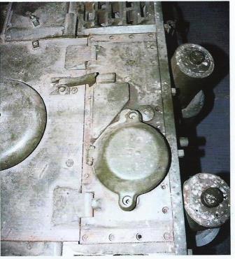

Hey Tank's ....... following your's and Red's Mid build with interest, Can you help , I have seen this plate on a few
Mid Tiger 1's , not sure what its perpose is , do you have the build dimensions for this item ?

Triangular access plate on rear engine deck
Feifel air cleaners were still installed.
That still doesn't really explain the rather odd design. It's essentially one (almost) triangular plate with three recessed bolts, but notice that there is also a lip underneath the front edge which itself appears to have its front edge partially drilled out to allow access to the bolts holding down the larger plate beneath.
According to Jentz & Doyle's Germany's Tiger Tanks the triangular plate on the rear deck appeared in March 1943 (so before the cupola change) and was "designed to allow access for engine component adjustments without needing to open the large engine hatch." I suppose this made more sense when the That still doesn't really explain the rather odd design. It's essentially one (almost) triangular plate with three recessed bolts, but notice that there is also a lip underneath the front edge which itself appears to have its front edge partially drilled out to allow access to the bolts holding down the larger plate beneath.

Thank for those details Tank's , very helpfull.......... I see what you mean about the engine latch , its bang in ther centre of where
the new plate will be on the original HL Hull ........... so thats another job for the scratch build !

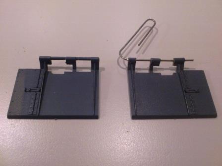

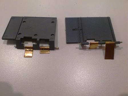

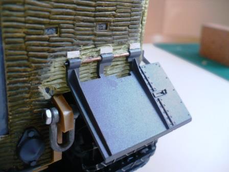

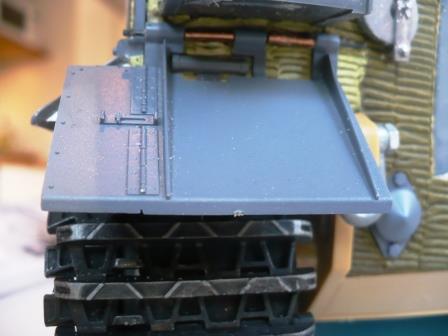

Rear Mudguards
Despite the battered appearance of much of my Tiger - and the complete loss of the front mudguards - I still wanted the rear mudguards in place. This was partly aesthetic - they don't interrupt the brutalist outlines of the tank quite as much - partly authentic - they were less likely to be lost in combat - and partly practical: the port one covers the sliding switch underneath the rear sponson which enables the top hull to be separated from the lower.
The HL rear mudguards are identical to those on the Tamiya Tiger and both have rather clumsy over-sized hinges. These can be improved a little by recessing them further into the rear hull plate, but they are really nothing like the real thing.
The fact that they are all-plastic hardly filled me with confidence either.
Another problem with the mudguards (for me at least) is that they represent the early type which attached to a welded-on rectangular bracket on the hull. By the time you get to mid-production tanks the hinges were simplified and the fixed bracket had disappeared.
However, unfortunately nobody seems to make these mudguards as an after-market part - Aber only provide for the early Tiger and sadly the Hachette partworks kit - which being a late-pattern Tiger should have the correct type - has over-sized hinges which are just as poor as those from Tamiya and HL.
So what I did was something of a compromise. First I cut away the thin plastic rod which was supposed to be gripped by the hull brackets (which I had already prised away from the HL hull). Then I drilled through from one side to the other. At first I planned to use part of a large paperclip for the internal rod of the hinges, but this ultimately proved to be too soft and bendy - so in the end I used a cut down track pin.
Next I wrapped brass strip around the exposed part of the hinge rod - and crimped it in place with a pointed bit. Slots of the appropriate size were then opened up in the hull so that each end of the brass could be slotted through and then bent to hold the thing into place.
So long as they sit right, this doesn't have to be the neatest job in the world - because the area around and beneath the hinges is then covered in Milliput zimmerit. (Oh, how this covers a multitude of sins!) With sufficient care they remain moveable just like the real thing.
They are not quite finished yet - the cut-out portions along the top edge shouldn't be there at all, so these will have to be filled in with plastic card. I am also tempted to make at least one of them a little 'distressed'..!
Coming next the jack brackets and mounts...
