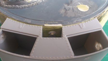

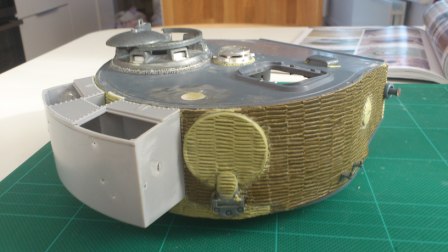

I didn’t fancy scratch building a new bin – there are all those rivets for a start. Two alternatives are available: Tamiya and Hachette. Both have a fairly accurate profile compared to the real thing, although the Hachette part lacks the distinctive rearward slope of the top – this is easily corrected by sanding it down. The real advantage of the Hachette one of course, is that it comes with opening lids complete with photo-etched brass hinges. On the down side the plastic used by Hachette has a horrible soapy feel and can only be fixed with strong epoxy glue. Before I assembled thr parts I used my rotary tool to thin them from the inside where I wanted to add battle damage with a twisting knife blade – since they were made of sheet metal these bins were often peppered with shrapnel holes.
The point of no return after the original HL bin has gone completely - Tamiya turret beneath.jpg
The point of no return after the original HL bin has gone completely - Tamiya turret beneath.jpg (20.88 KiB) Viewed 16216 times
Once I had sawn off the old bin I cut out the rear of the old HL bin and used it to plug most of the opening. Since I had already filled in the undercut at the turret rear I then fixed this in place and used plasticard to fill the gap in between. Trickier to fix is the chunk missing from the top of the rear turret plate and weld bead where the old bin cut out had intruded.
Hachette turret bin attached showing lifting trunnion and zimmerit to turret rear.jpg
Hachette turret bin attached showing lifting trunnion and zimmerit to turret rear.jpg (18.18 KiB) Viewed 16216 times
Close up showing the new rear turret lifting lug and zimmerit visible on back of turret.jpg
Close up showing the new rear turret lifting lug and zimmerit visible on back of turret.jpg (26.65 KiB) Viewed 16216 times
I’ll be discussing zimmerit below, but it’s important to note that, on the real thing, this was applied to back of the turret before the bin was fixed in place. So before I fixed the Hachette bin to the back of the turret I used Milliput to extend the zimmerit to the area underneath, especially the visible patch where the third lifting lug is fixed. Finally I used brass strip to fashion the attachment points at the top and bottom.
The view from underneath.jpg (25.2 KiB) Viewed 16216 times
The stowage box looks much better once it has been attached over the zimmerit.jpg
The stowage box looks much better once it has been attached over the zimmerit.jpg (34.47 KiB) Viewed 16216 times
Another view of the Hachette turet bin.jpg (31.13 KiB) Viewed 16216 times
Obviously I still have the hatches to install. There are also missing rivet details and the latches to be added to the rear.

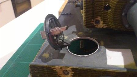

After all that I thought that adding the hatches themselves would be a breeze. They’re clearly designed for the HL hull because the hinges fit neatly over two small plastic pins which are moulded on the inside. Sure enough, once in place they sit nicely in place over the apertures. However, it’s when you go to open them up that a problem becomes apparent – the hinges don’t allow them to open enough: in order to stay open they need to swing wide enough so that the hatch passes the vertical.
I played around with positioning the hinges inside so that they would open wider – but still allow the hatch to sit level when closed. Eventually through trial and error I found that they only do so if the hinge was placed at right angles to hull roof. It’s hard to explain, so I’ll let the pictures do the talking…
Side view of new hinge bracket added from bent brass strip.JPG (22.17 KiB) Viewed 16200 times
Another view of hinge bracket.JPG (19.97 KiB) Viewed 16200 times
Inside view of radio operator's hatch.JPG (18.71 KiB) Viewed 16200 times
Another view of inside of hatch with altered hinge.JPG (18.72 KiB) Viewed 16200 times
The hatch now opens far enough to sit in the correct position.JPG (15.9 KiB) Viewed 16200 times

Thats really cool....I am not sure why it fixes things any more than moving the pivot point with wedges between the upper hull and the hing plate....but very slick...
Have you checked your gear boxes for clearance with those parscopes? Its hard to tell how long they are.
tanks_for_the_memory
Posts: 501
Location: London
Re: Building a Mid-Production Normandy Tiger 1
Believe me, I tried to solve the problem by moving the hinges every other way - but every time I got them to open the way that I wanted them to, I found they wouldn't shut properly. For whatever reason this just works...
If you leap forward in this blog (a mere two years or more) you will see that I found a much easier solution to this problem...

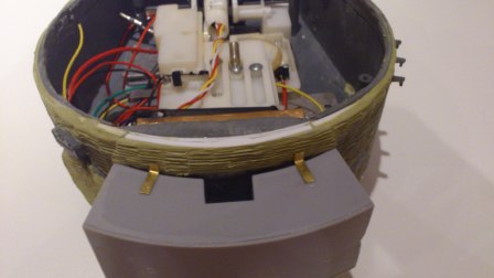

As I have already said, electronics are not my strong point. However, through trial and error – and a lot of help from others on this site – this is what I have done...
Originally this was an old smoke and sound Tiger with an RX15 board. There was no flashing hull MG – instead the coaxial MG flashed in the turret. Then I up-graded the lower hull to one with an RX18 board. Because I was going to install an Asiatam recoil unit and install a working hull MG I stripped the electronics out of the turret completely.
Moving the turret traverse motor
The HL turret traverse is designed to stop the turret from traversing totally to the rear. Obviously it can’t keep on going round and round without ultimately snagging on its internal wires, but the choice of 6 o’clock was presumably made to prevent the gun from snagging on the aerial. Since I had relocated my aerial mount to its correct position behind the right rear of the turret it made sense to have the turret traverse stopping at 4 o’clock too. Because I had already shifted the turret ring back I was going to have to relocate the motor anyway so I decided to move it to sit under the new aerial. I simply glued it into its new place and wedged it in with plasticard and square shaped brass. It worked perfectly. Of course, I hadn’t thought about the fact that it would now get in the way of the speaker. This I relocated to the opposite side of the hull and fixed in place with sticky-backed Velcro.
View from beneath hull showing relocated turret traverse motor.jpg (36.47 KiB) Viewed 16170 times

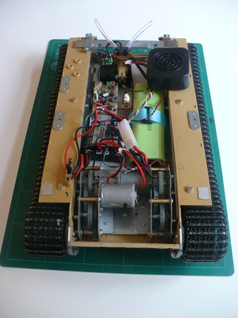

Taigen lower hull
The Taigen (formally Asiatam) lower hull is a serious upgrade for any HL tank and not just because it isn’t cheap! I had no plans to go for one of these until I swapped the HL early-style metal tracks for the Taigen late-pattern ones. After a few test runs in which one or other track kept riding up over the sprocket I realised that I would have to install some sort of track tensioning system. There are stand-alone track tensioners on the market, but the Taigen hull not only comes with these pre-installed – it also includes a metal floor pan and torsion bar suspension system, a strengthened front with metal final drives and metal tow shackles front and rear. There's even a complete rear panel and it's all moulded in a pleasing sand coloured plastic. Once you take all this into account I believe it represents good value. It also gives the tank a much more weighty and robust feel.
The fact that there is no longer a battery cover underneath means you no longer have to flip the tank to change it – instead there is an ingenious system for separating the HL hull top and lifting it to replace the battery and access the electronics. It does, of course, mean that you have to strip out everything from the old hull and move it to the new one. It’s also worth noting that because the on-off switch is accessed via the radio operator’s hatch you need to have these opened up first (you can buy another Taigen upgrade hull top with working metal hatches already in place but this preserves all the old problems including the mis-placed turret ring). NOTE: ACTUALLY I NOW BELIEVE IT DOES NOT HAVE THE OLD HL PROBLEMS...
Rear view of Taigen hull showing track tensioner and rear hull release mechanism.jpg
Rear view of Taigen hull showing track tensioner and rear hull release mechanism.jpg (83 KiB) Viewed 16086 times
Overview of Taigen lower hull with everything transferred - metal plates a legacy of previous failed attempts to use magnets to attach to upper.jpg
Overview of Taigen lower hull with everything transferred - metal plates a legacy of previous failed attempts to use magnets to attach to upper.jpg (76.55 KiB) Viewed 16086 times
Relocated speaker unit (a result of moving the turret traverse motor) attached to hull with adhesive velcro.jpg
Relocated speaker unit (a result of moving the turret traverse motor) attached to hull with adhesive velcro.jpg (61.29 KiB) Viewed 16086 times

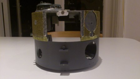

Another advantage is that you can swap the Taigen lower hull with your HL one so if, like me, you have already done a lot of work above the tracks - it's not wasted. However, the only problem I have had with this upgrade (and not an insignificant one) is in the way it fits with the HL upper hull. The quick release mechanism works fine, but I did find that the bottom of the side panniers hung down a little beneath the sides – seemingly the result of a little warp in the moulding of the lower hull. This would not have been a problem had I been able to screw the top and bottom together, but of course this would have defeated the purpose of the quick-release system and made battery changes very time-consuming.
Thus shows the fitting issues thrown up by mating my old HL upper hull to the Taigen hull.jpg
Thus shows the fitting issues thrown up by mating my old HL upper hull to the Taigen hull.jpg (32.44 KiB) Viewed 16086 times
I gave the solution a lot of thought, but in the end the fix was quite simple: small, powerful magnets which are cheap and readily available on the internet. First, though, I tried making things much more complicated by attaching metal brackets to either the lower or upper hull and gluing metal plates to an appropriate location on the opposite part. The idea was to glue on one of these magnets at each point and attach the Taigen and HL hulls thus. The problem was that these magnets are so damn powerful that whatever glue I used usually succeeding in pulling the home made brackets away. Then I tried again with those plastic housed magnetic catches used for keeping cupboard doors shut. Again the glue would not hold, although I suspect that with a bit of perseverance it might have worked. I won’t trouble you with photos of any of these failed attempts, although the various metal plates seen below are their legacy.
But I told you that – in the end – it was simple, right? I cannot claim credit for this one, although neither can I recall who it was on this site who posted the solution (thanks anyway!). I went back to my small but powerful magnets and glued them into the screw recesses in the Taigen lower hull, then cut short the attachment pillars from the upper hull by a couple of centimetres. Into these I then inserted the old screws so that the screw heads came into contact with the magnets once the two halves were mated. They were then adjusted to make sure that the hull top and bottom fitted snugly. Voila!
Screws inserted directly into ends of upper hull where they will mate with magnets in Taigen lower hull -the strengthening is a bit of old Airfix pontoon bridge!.jpg
Screws inserted directly into ends of upper hull where they will mate with magnets in Taigen lower hull -the strengthening is a bit of old Airfix pontoon bridge!.jpg (68.77 KiB) Viewed 16060 times
Screws inserted directly into ends of upper hull where they will mate with magnets in Taigen lower hull. jpg
Magnets glued into lower hull ready to mate with screws inserted in upper hull.jpg
Magnets glued into lower hull ready to mate with screws inserted in upper hull.jpg (56.88 KiB) Viewed 16086 times

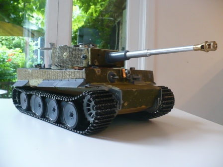

The only other problem I encountered with the Taigen lower hull came at the nose end: the front bottom hull no longer dove-tailed neatly with the front upper nose plate. This was resolved with a little sanding and milliput. In the end it was all back to looking as neat as the original fit between the HL upper and lower hull…
Now settled on Taigen lower hull with metal barrel and full recoil and flash installed.jpg
Now settled on Taigen lower hull with metal barrel and full recoil and flash installed.jpg (72.74 KiB) Viewed 16086 times
