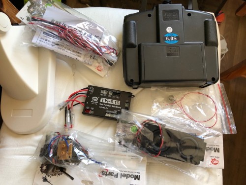

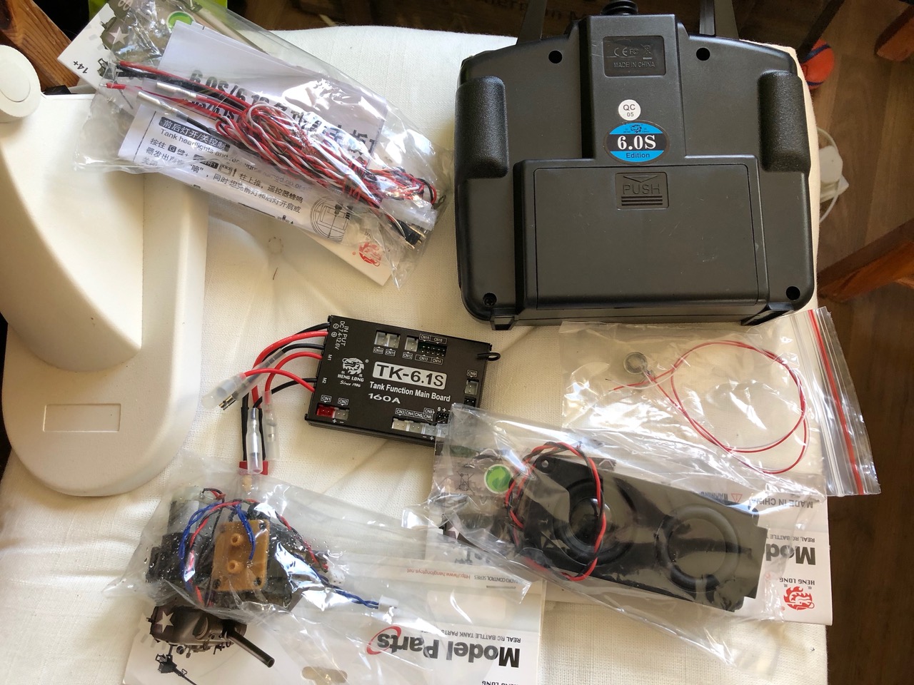

This ground to a halt- literally- because of an issue with the RH motor (looking forwards) sticking slightly every revolution. This I discovered, by test-running the motors with my standard 6vDC battery pack. Believe me, it's better to use a battery pack for initial testing, than to boot up the expensive Control unit up(TK 60, in this case), to trial the motors, tracks and running gear.
One of the gears isn't perfectly round, I discovered, and has a slightly high point ever rotation, adding a slight braking effect.
I did connect the Clark up to test the sound effects (Meteor engine, Stian 'installed'), and lights, but didn't want to try it in drive mode.
These gearboxes came from Asiatam and, whilst they look pretty solid, the gearbox frame appears to be made of the sort of 'bendy' metal Uri Geller would have approved of.
However, having realigned them slightly, and added extra screws for rigidity- plus lashings of grease- I'm going to take up the Cromwell challenge again.
Partly because of the fiddle tuning a Clark board takes, and also the motor issue, I've decided to gut the Cromwell- which was looking a tad too complex internally, and go with the formula that worked so well with the Comet A34, to whit:
-HL TK 6.1s controller (the best that HL has to offer, IMHO)-
-V6.0 compatible smoker
-new HL speaker. It's a major improvement on the bulky, weighty square one found in Taigens and earlier HL offerings.
Click on images to ENLARGE them.
-T34 headlight, to double as the Cromwell turret spotlight.
The bits eviscerated from the Cromwell interior, can go into 'stock' or be sold off.
As ever, Forgebear came though with the bits I need,
as well as a packet of sweets to encourage a bit of tooth-decay
...and speed the need for dentures.

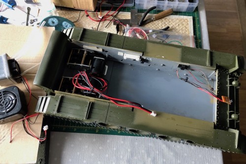

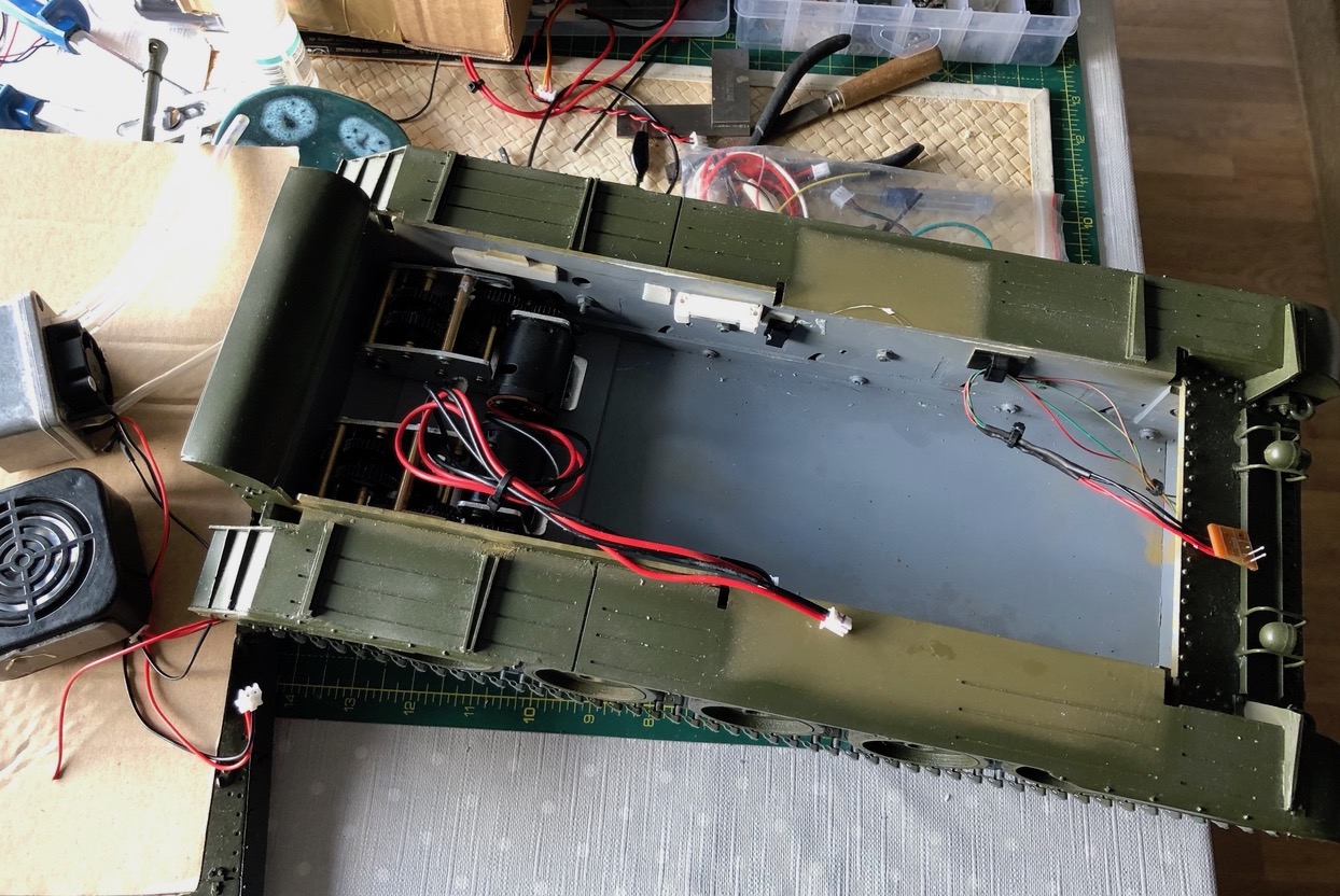

as a reminder, this is what the interior used to look like:
