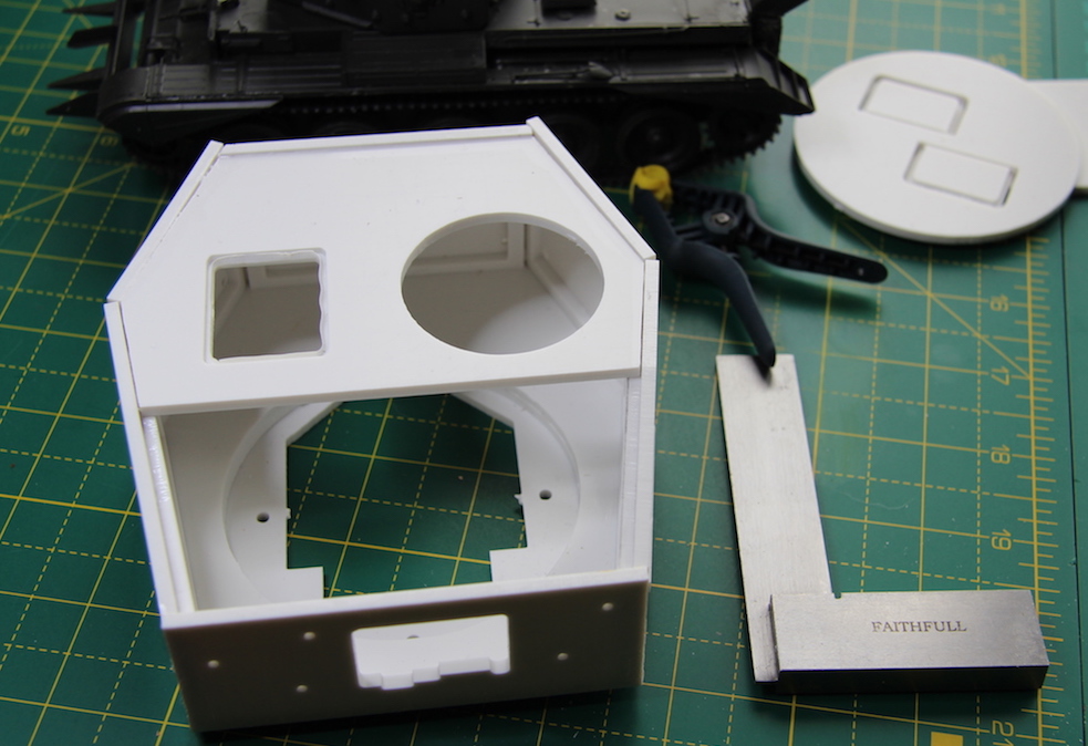

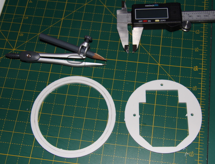

The crucial part of the turret build is assembling the turret ring support plates accurately. To get them plumb centre, I used a compass to draw the correct position.
Pencil line indicates where parts should mate..

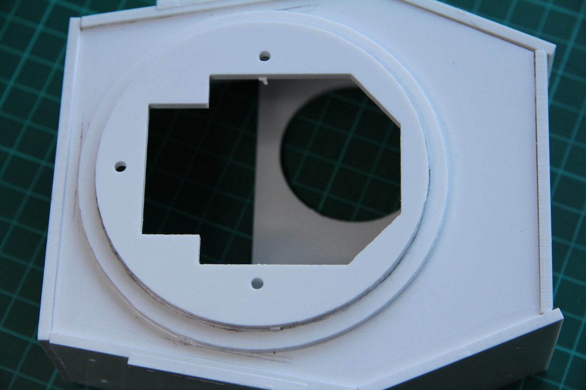

Ring support mounted on bottom plate

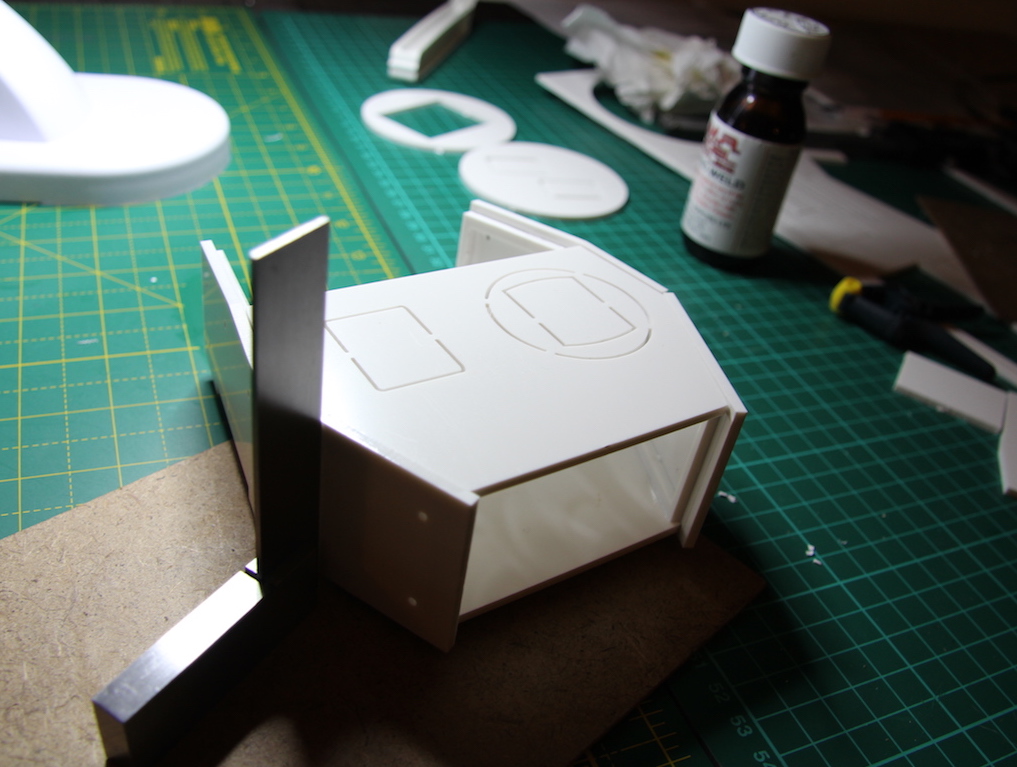

Fitting the side armour plates was straightforward, but getting them truly perpendicular was critical, and hence the trusty set square:
The virtue of being upright
For the moment only the top plate, with apertures for Commander's and Loader's hatches, actually glued in place. The front portion will remain detachable for future access.
Section of top plate glued in place

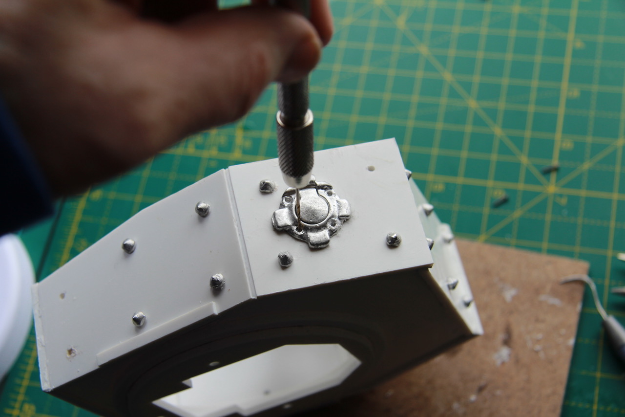

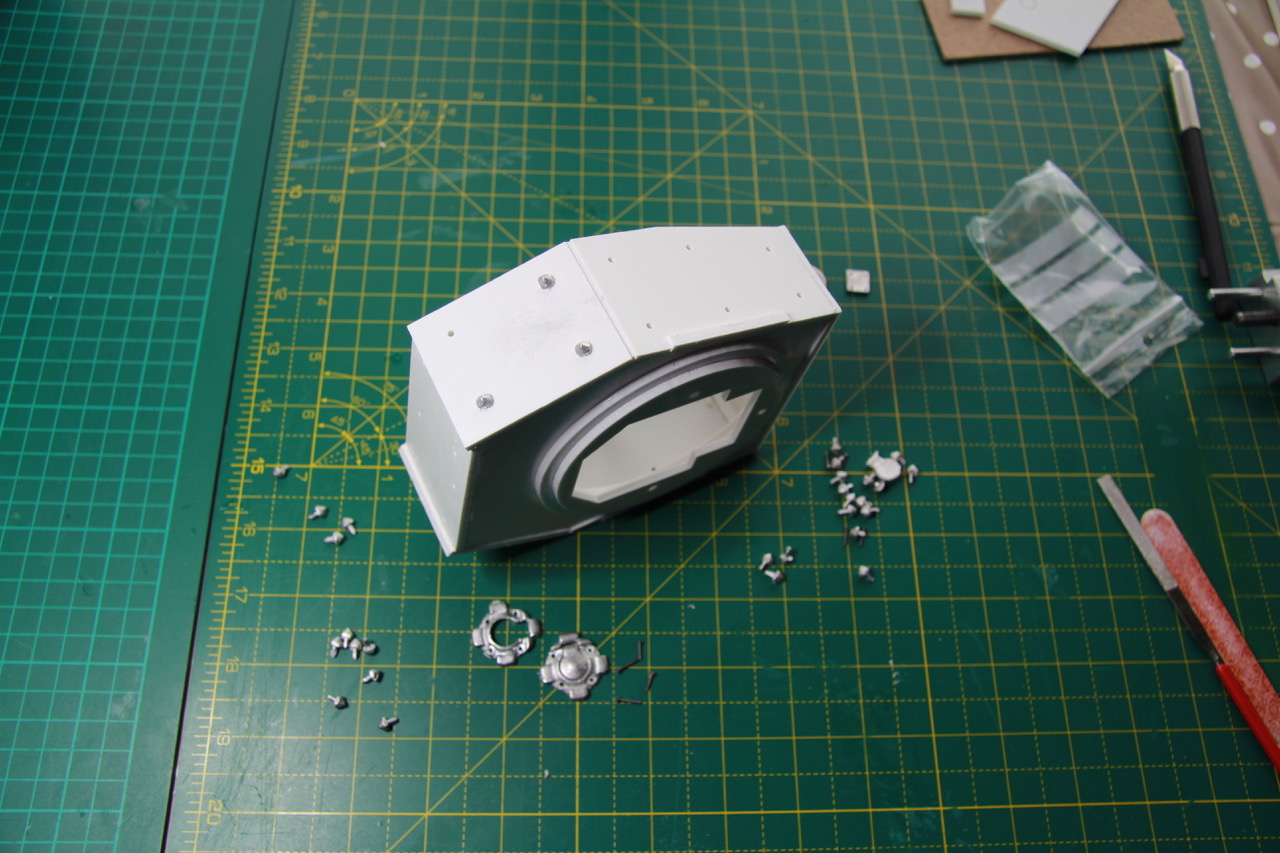

This is quite riveting..and so it's time for some...rivets. :D The feature of the Cromwell that always reminds me of a Dalek: those 'armour acne rivets. :lolno:
Fitting rivets and side hatches

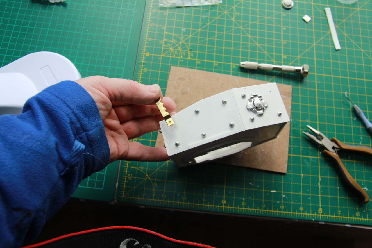

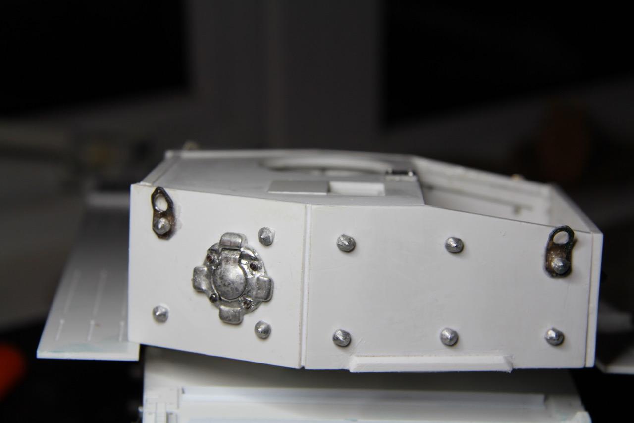

Pin vice used to pave way for 2mm (across flats) wee bolts. Now to improvise the four lifting eyes found on the Cromwell turret. I found these brackets from a picture framing kit to have the right potential. :thumbup:
Picture framing clip as ersatz lifting bracket

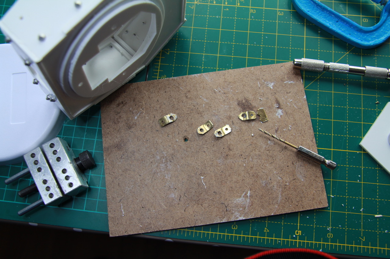

Then, roughly cut to shape and drilled:
Basic shape ok but in need of some emery paper..
That's all for now, folks. I feel a caffeine deficit in need of immediate attention. I would say a slurp deficit, but Friday night is my only amber nectar night in the week. :haha: How's that for self-disciple?..and for a Scot to boot! :haha:
Turret rivets bonded in place with epoxy

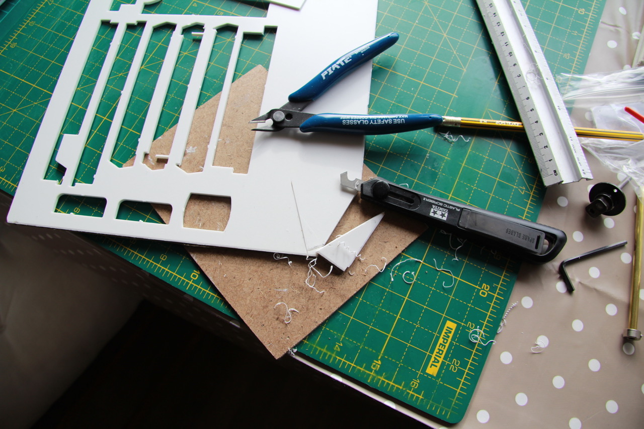

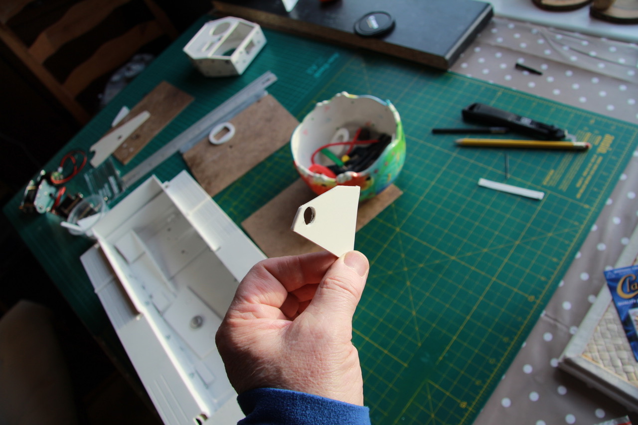

A few little updates..
I though a template for fitting the Henntec system would be included with the product, but apparently not. S o o o o..I had to make one myself.
Template for fitting Henntec track tension adjuster
The template I cut out lined the unit up with the front plate and upper/lower glacis plates. It's not as neat as the one advertised on Christian's website, but it sufficed. It was important that the positions on the left and right sides matched.
A bit crude but it worked
and they did, and here's the result:

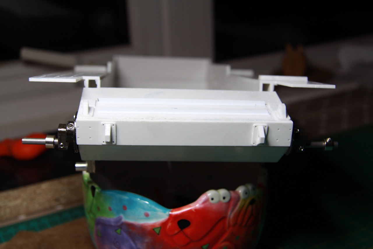

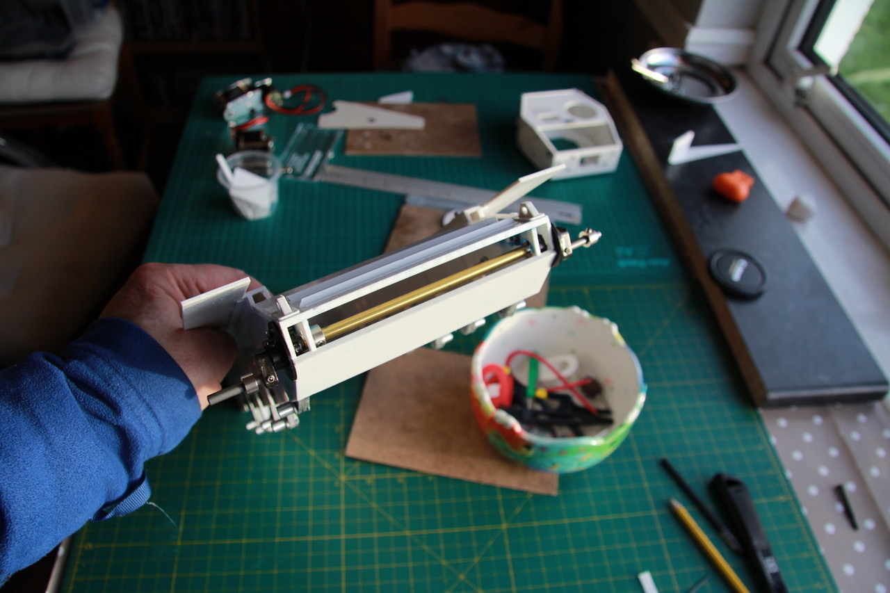

Henntec in situ
Henntec in situ
Having got the fiddly retaining screws in place, I could now close up the front of the tank, with the front armour plate.
Front plate finally fitted..now waiting for headlights

Great job on turning those picture hangers into lifting hooks. Those things have a multitude of uses in scale tanks. I once used a set, bent into springs, to help bolster the torsion bars on a KV-2 build. Following along!
