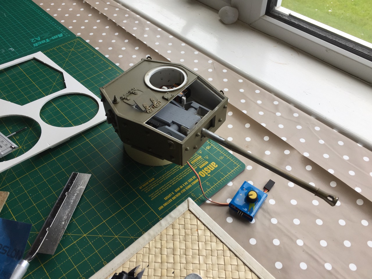

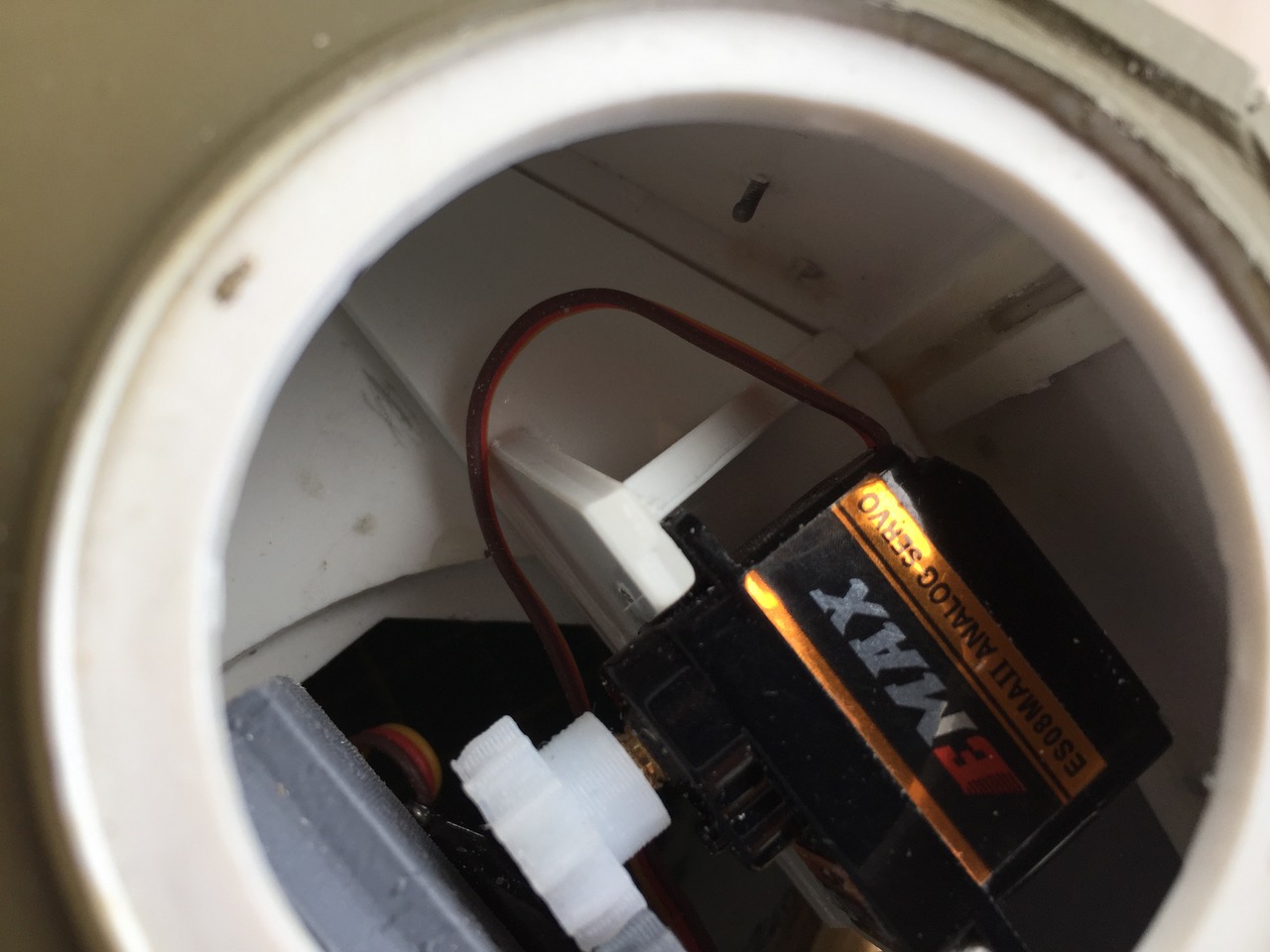

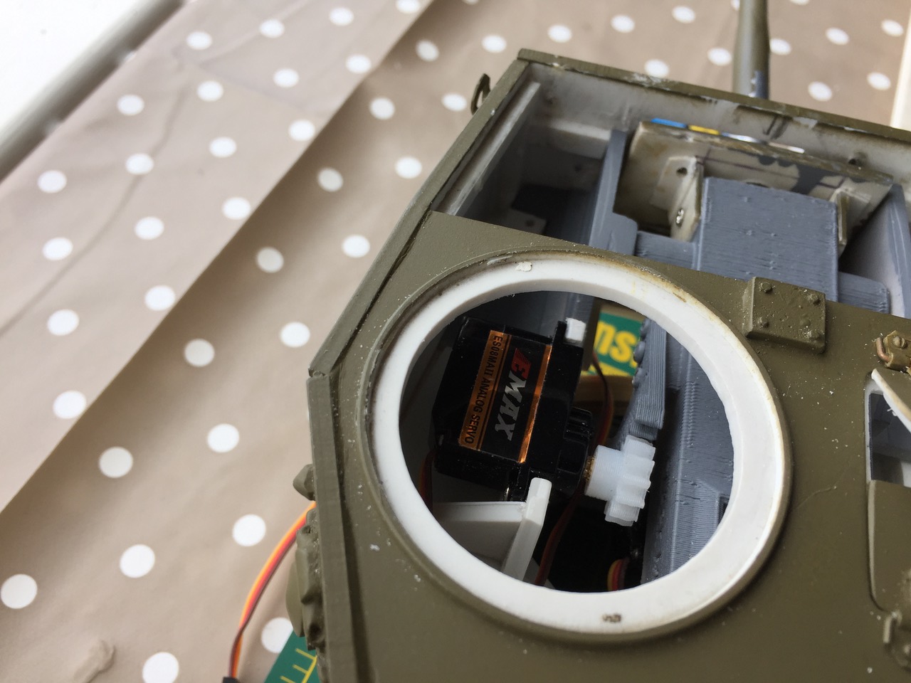

Amidst catch up on long delayed domestic chores (painting a welsh dresser, among many..), I managed, at long last, to get the final form for the Clark elevation servo realised, and made. I still have to cut a slot in the base that will fix it in the turret. This will allow a bit of adjustment in the horizontal plane. That's where the servo drive wheel will mesh -hopefully- with the toothed gear on the gun.
Testing the fit of elevation mounting
The gun will only go in one way with the barrel attached, and it's very tricky finding that position...like Rubik's Cube. The same applies to the new Elevation servo bracket I've fabricated. After lots of attempts, I found a way of slotting it in.
Thus I've proved that it is possible to fit the Clark recoil and Elevation unit in the Cromwell turret, even with the rear section of the roof bonded in place; as fixed as the floor. :| Whether it will work is quite another matter... :problem:
Another angle on the elevation unit
..and again
..and again
Elevation and recoil servos in place

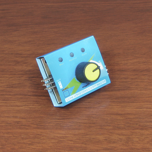

Knowing practically nothing about RC servos until recently, i bought myself a servo tester to check out the limits of movement in these Emax servos. I need to know how far, and in what sector of a 360 deg range the drive wheels will move.
Unfortunately, after a couple of tests, I inadvertently burnt the tester out by connecting my 6vDC battery pack with polarity reversed. Ooops. On an rc motor, that wouldn't matter, but the tester really didn't like it. :O But, hey ho, had to order another one. I really need to know how the gun will move, and by how much, before finalising the fittings, and installing the turret fully in the tank. Don't want to keep dismantling it, and then having to remember how to assemble it.
Here's the tester I used. Luckily, it was very cheap :shh: Better still, it's a sunny day. Sadly, it's not a great day for the folk down in London. More superstitious zealots on the loose. :shh:
Servo tester..now in the digital graveyard.
