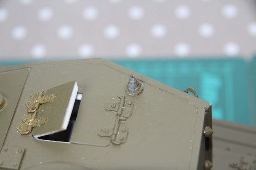

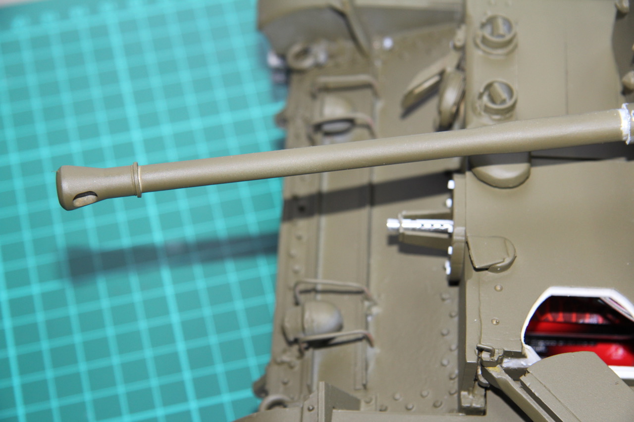

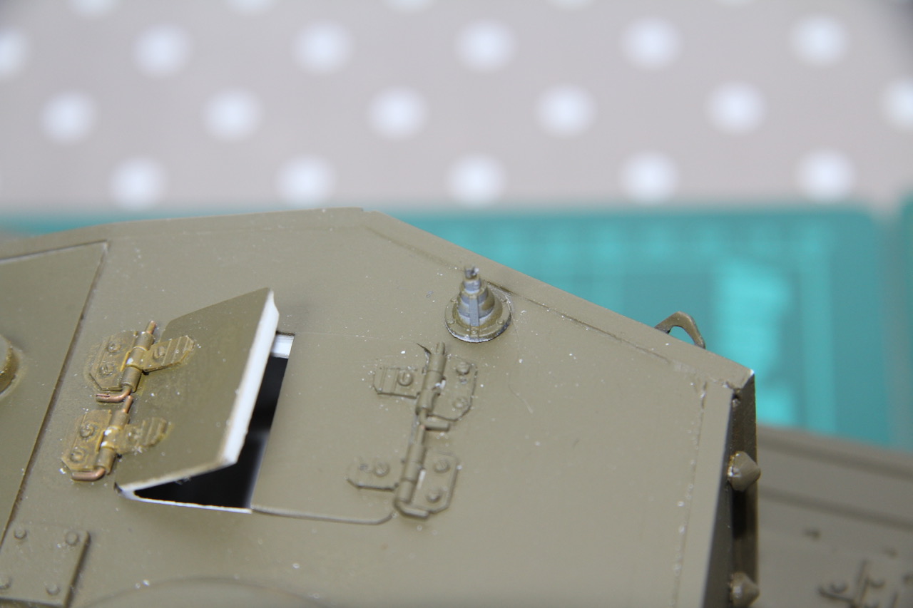

Meantime, I've added the Bow MG, and an antenna for the turret. The latter being a product of Woz (from this forum) on the Shapeways site, and not one I've fabricated myself :|
Antenna base from radio
After blending in, sanding, and proper layers of paint it should all look much better. The tank has a light coat from a rattle can currently, just to give an idea of how it will look.
Taigen MG fitted in bow position
Sorry, not enough depth of field there..

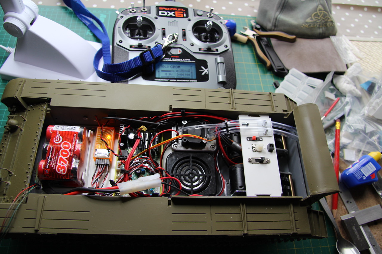

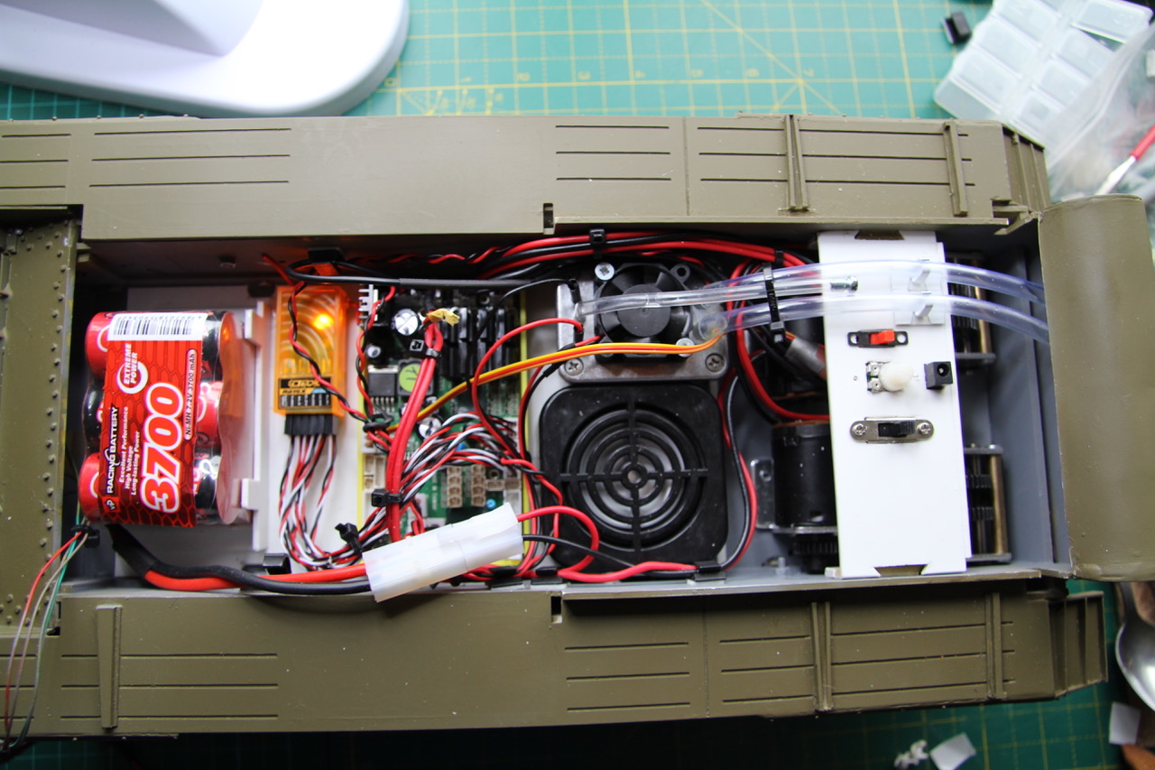

Here's the final arrangement of the Hull electronic components, with the circuits live. Turret and upper hull wiring yet to be settled.
Final arrangement for Hull electronics
and again:
Circuits live
Circuits live
Although my experience of using RC servos is, hitherto, non-existent, I've a fair knowledge of electronics through hi-fi, recording, and car digital systems..
Created a new profile or Cromwell on My Spektrum (for the first time)..tick!- success. Smoker working..tick! success... sound..working properly..tick! Thanks again to Stian (Maxmekker) for a superb soundset on the Clark TK60, and especially
that wonderful Rolls-Royce meteor sound! Success.Tick.
The lower hull is a runner..except that the right gearbox seems to lock solid (asiatam sh*te). Disconnected it from the TK60 in case it blew something. On inspection, the solder on the terminals looks fragile; but managed to get the drive and tracks moving with a remote 6Vdc supply. Even then, something in the drivetrain causes it to lock solid every now and then. Added Ptfe dry lubricant. Still, running rough. Left hand motor/ drive train easy to move by hand, right hand moved freely, then locks solid. Hmmm.I've not encountered that before. Ideas anyone? I may try 'running the motor in' before I reconnect it to the
Clark. If nothing else, the tracks seem to be a good fit, and everything else works properly. I have just created a Youtube channel, and so when I get things going, I'll add a video of progress (virgin in that department too!!)

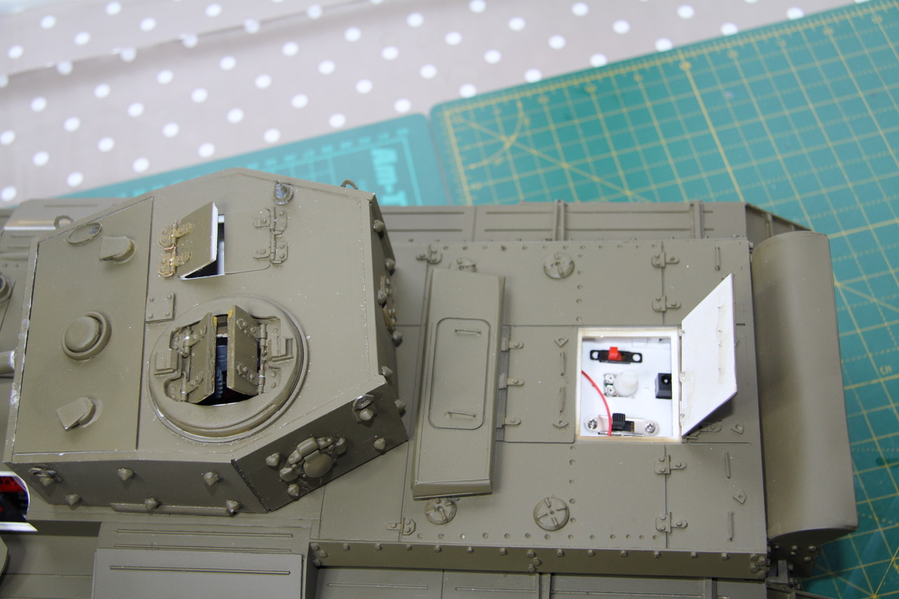

Cromwell switch access hatch
I'm pleased with the access hatch for the power switch. The bar it sits in also contains a switch for the smoker, the volume control (Works! Tick!..success), and a remote battery charging point to boot..
Still have to refit the MG in the Mantlet, but have no plans to make it a 'working one' just yet.

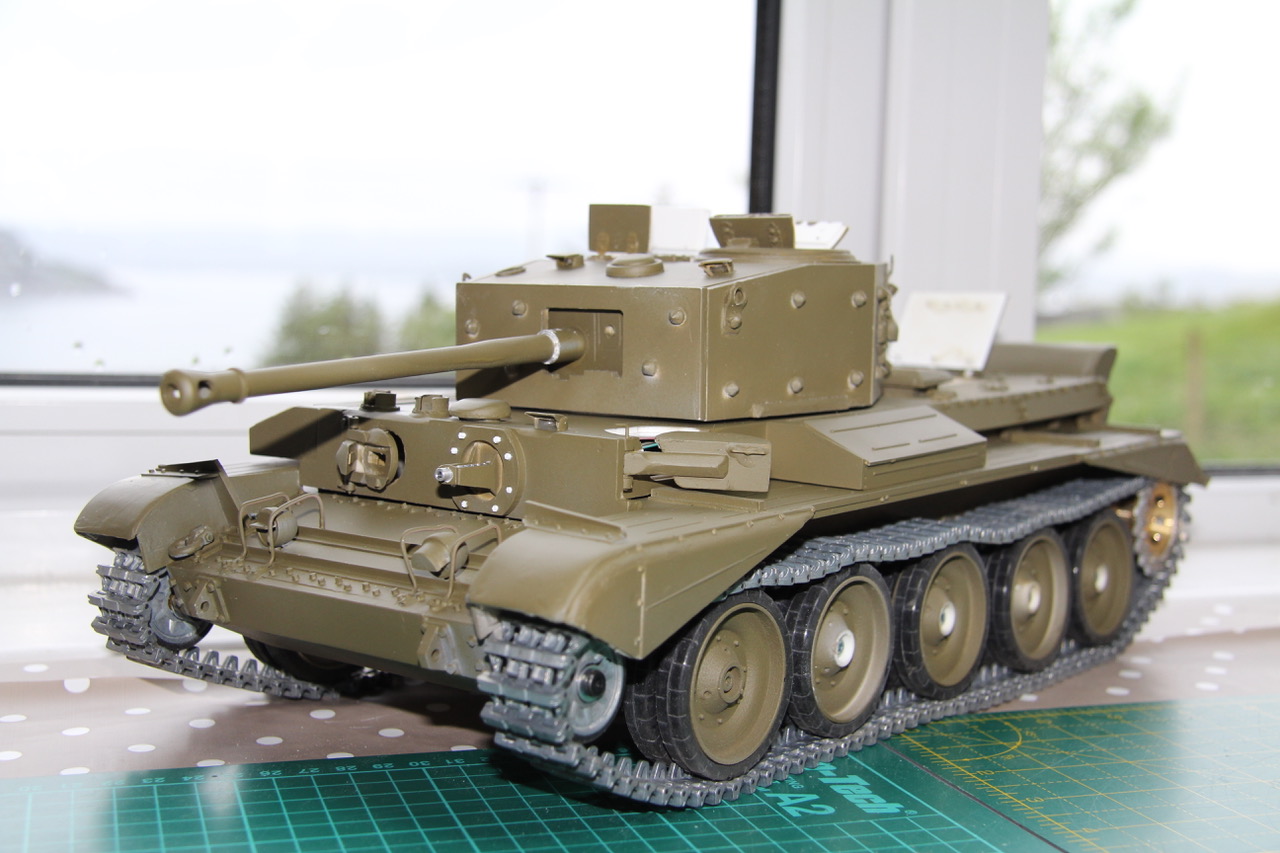

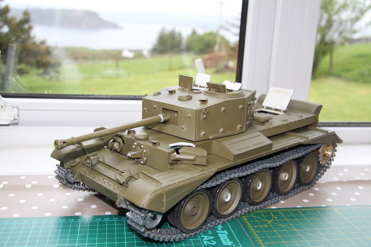

Exterior nearly finished
Another angle
Another angle

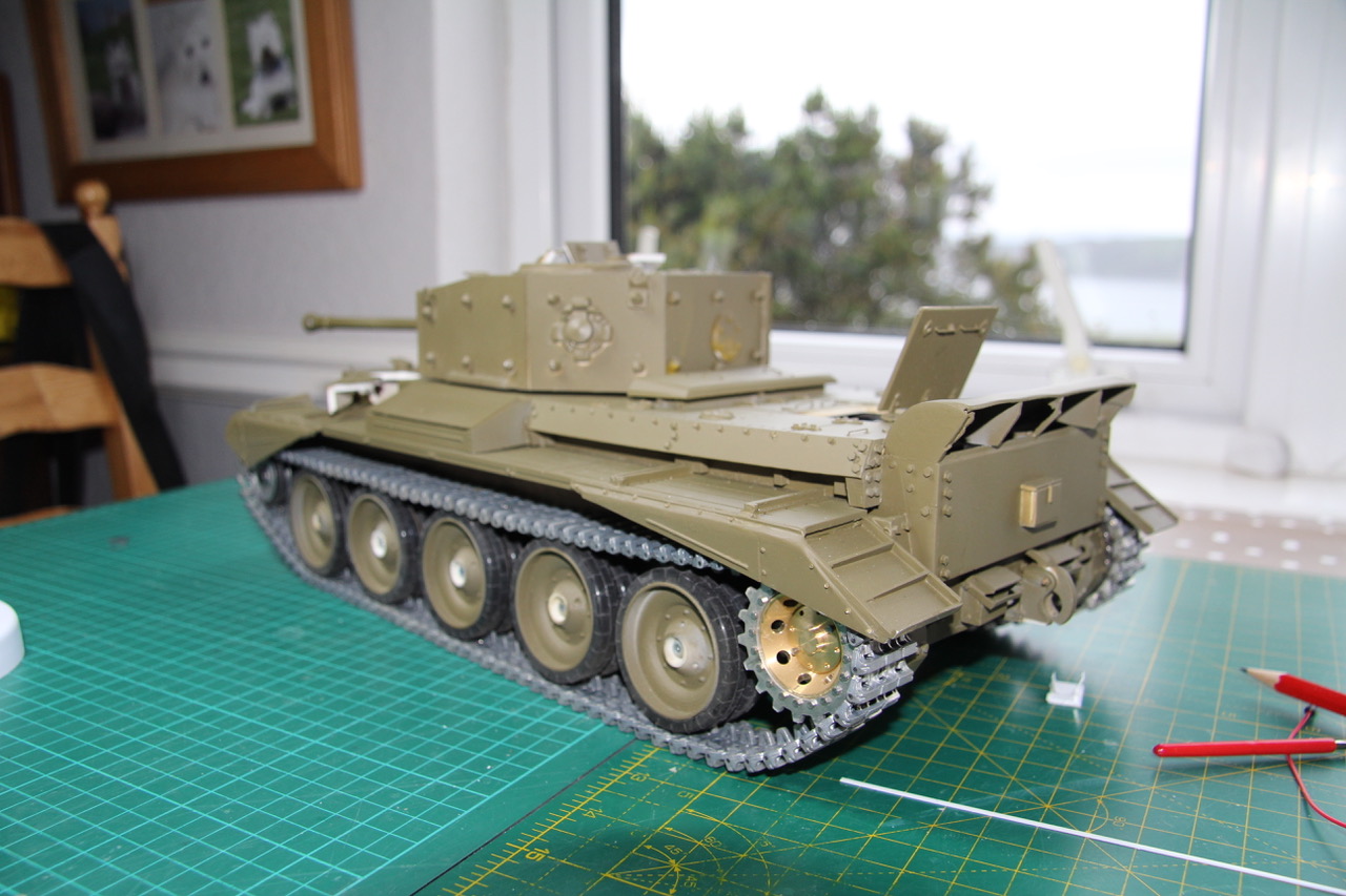

and the pert posterior:
Rear only needs tow shackles

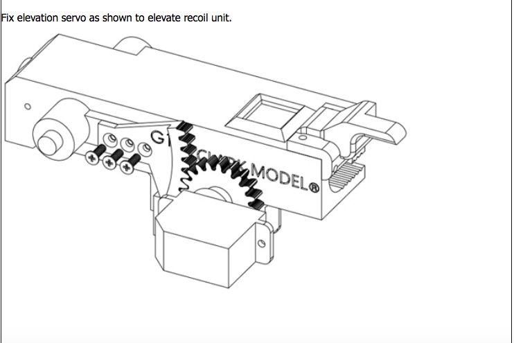

Now, the abiding issue of servos.

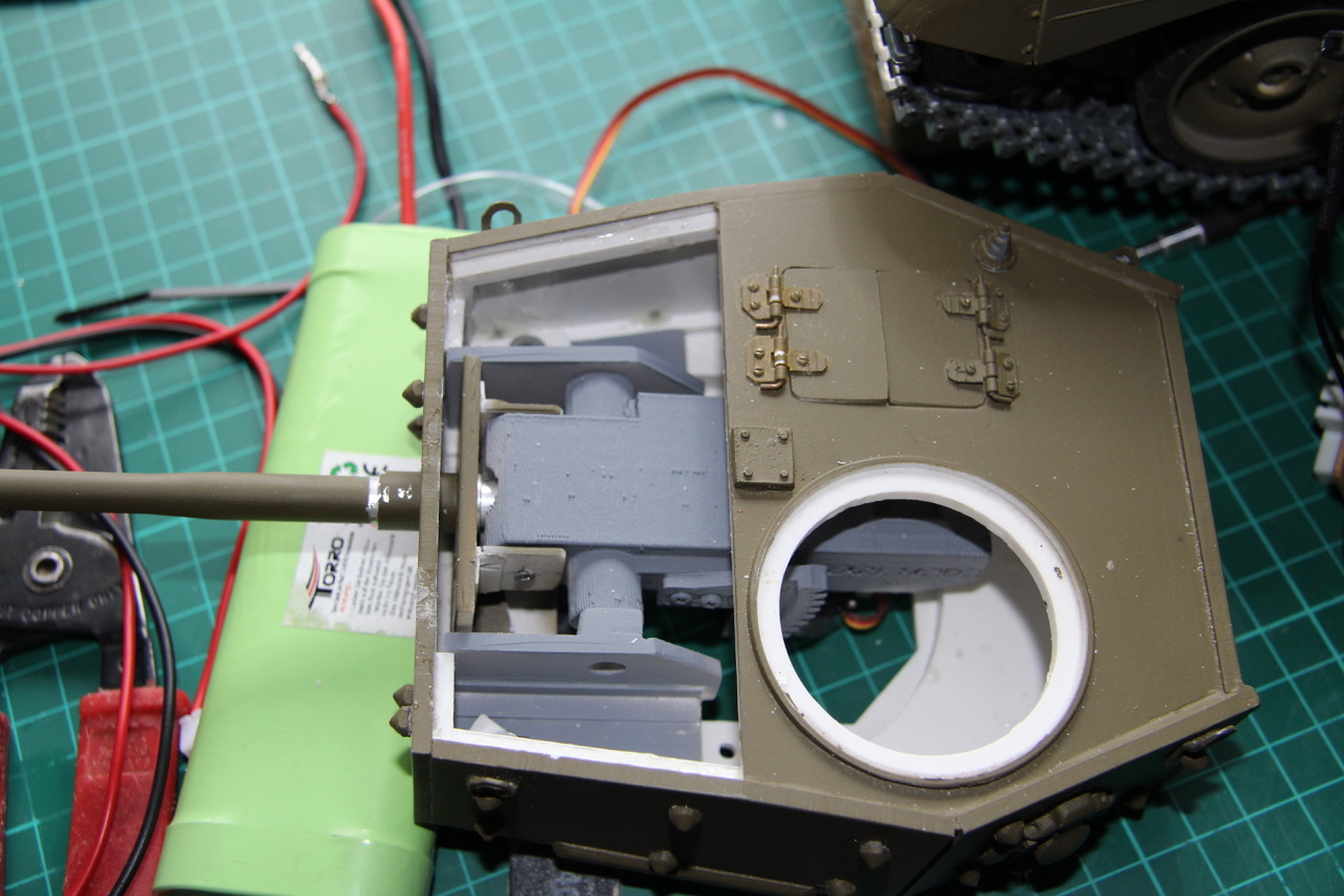

Gun needs mounting point for elevation servo
I've designed a bracket to hold the servo for the barrel elevation. Thing is, as a fixed unit, it has to be perfectly positioned in the horizontal and vertical planes- and that's really hard to work out. Does the centre axis of the servo drive wheel line up with the middle of the elevation gear (seen through the Commander's cupola aperture), the bottom, or the top? That depends on the inherent travel of the servo..an unknown so far; and the rotation direction.
This Clark pic suggests a position below the median, and that's the one I'm going to try.. :think:
[/attachment]
That's the next challenge..and that crappy gearbox.. :-<
Clark elevation servo orientation
Clark Servo elevation position.jpeg (56.83 KiB) Viewed 3917 times
