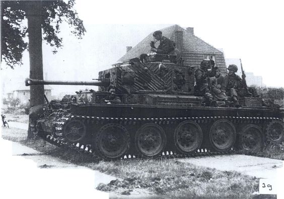

Whilst trying to find detailed pics online, or in the few books available, of the parts I needed to make- I came across this unusual Cromwell. It appears to be covered in a sort of herringbone pattern Zimmerit coating.
Further research suggested that the material in question was rubber :shh: How clever of the Brits to ensure that 88mm AP shells, travelling at over 2,500 Ft per sec, would simply go: "Boi.. oi..oing ..!!" and bounce off the side of the Cromwell. :lolno: :haha:
British Zimmerit- rubber Chobham

doc larsson
Posts: 829
Re: Cromwell Mk 4 1:16 scratch build Ludwig kit
Post by doc larsson »
look like us paras on board too interesting pic

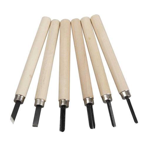

That hook Looks fantastic. What do you use for such precise cutting of your styrene?
Soeren wrote:That hook Looks fantastic. What do you use for such precise cutting of your styrene?
I Used wood and model sculpting chisels like these:
Sculpting set
Sculpting set
Wood carving and model chisels.jpg (18.25 KiB) Viewed 3868 times
They cost less than £5 on Ebay...and represent a bargain at that price. One is for corners (right angle profile), and a couple are fluted for curves. I also used various grades of emery paper, combined with sets of flexible fine grit manicure emery boards. Then there's my indispensable Trumpeter razor saw. It came in handy for cutting out profiles (works like a coping saw, or band saw...but with a tiny detailed blade).

doc larsson wrote:look like us paras on board too interesting pic
Yes, I noticed the yankee passengers too. Looks like the tank commander's ordering up a takeaway for them... :D

Post by Soeren »
Ah there it is again, the razor saw, I am just adding stuff to my online shopping basket for modelling and completely forgot about that. Thanks, I'm glad I asked.
