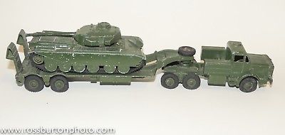

This is what I remember (mine was not quite as battered) - I had the Antar Tank Transporter as well.  Next project?
							Richard

Yes the Centurion with the Mighty Antar was one of my favourite toys, my dad used to take me down to the tank repair depot in Leeds to watch them testing the tanks.
