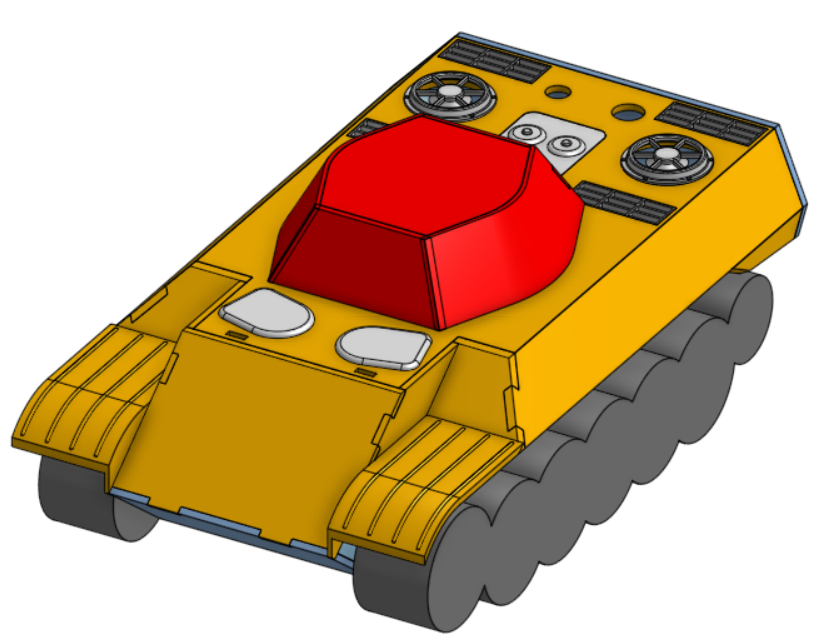

To help me in the construction I have chosen to model in 3D, using as reference the original blueprint. Some considerations:
  • I'm using Onshape as CAD software, and you cand view the model here.
  • It is made as independent parts, perfect for taking measurements and to move to he mateeial or even 3d print them.
  • I'm learning CAD, therefore operations and/or methodology cannot be the most accurate
  • The model is fully under construcction, there are draft sketches, redundant operations, duplicate parts, etc. I don't guarantee that all pieces have the same dimensions from one day to another. I fyou have doubts, ask me without problem.
Ok then but, what will it lool like? It should look like this :D

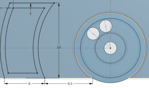

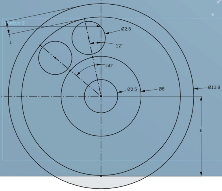

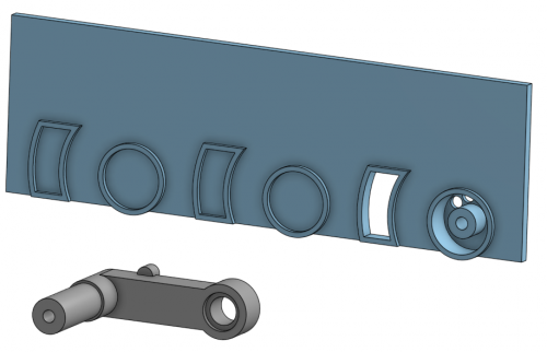

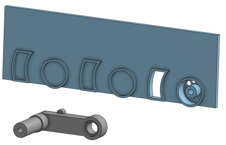

Since I'm going to use the suspension parts of Heng Long Panther, I needed to get the measurements of the swing arm support, both the hole with screw and spring and the rectangle to simulate the torsion bar effect. I have modeled taking as reference the Heng Long plastic model:

I have one type for you, arched tracks for the movement of the shoulders, the cutout, do longer than the original, I once grinded these tracks on my first tank, which serve as stops for the movement of the shoulders, and made them much longer in the plastic tub, movement, suspension and behavior the chassis has changed dramatically ...

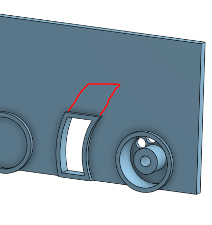

LK88 wrote:I have one type for you, arched tracks for the movement of the shoulders, the cutout, do longer than the original, I once grinded these tracks on my first tank, which serve as stops for the movement of the shoulders, and made them much longer in the plastic tub, movement, suspension and behavior the chassis has changed dramatically ...
https://youtu.be/QtNRsqeTe-I
Hi LK88. If I have understood properly, you have enlarged this gap, right?

yes exactly, this gap for arm travel ..
