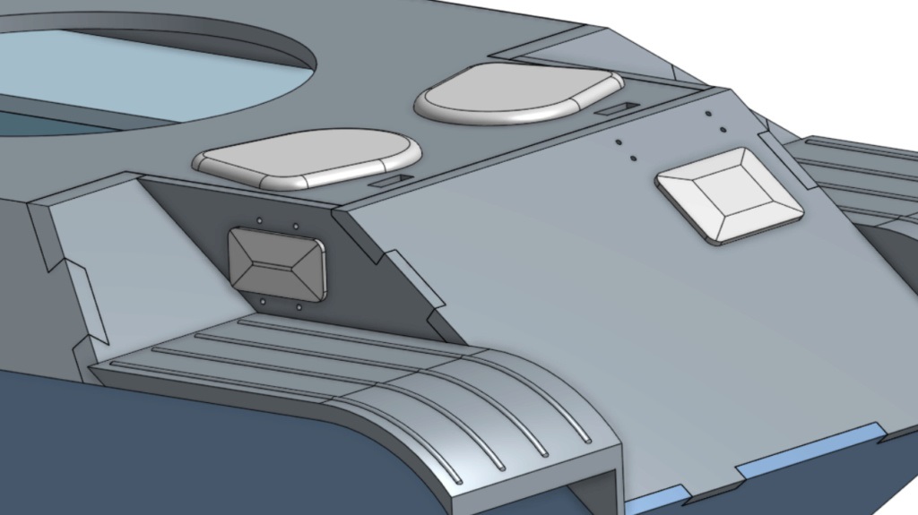

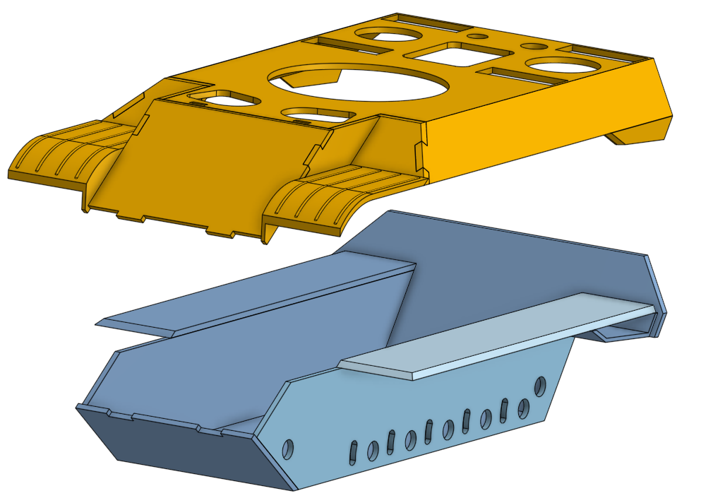

Working on the CAD design, this would be the leayout of upper and lower hull to access electronics:
I'm thinking to do the joint between glacis and lower front without interlocked because it can be a adjust problem or damage the paint.

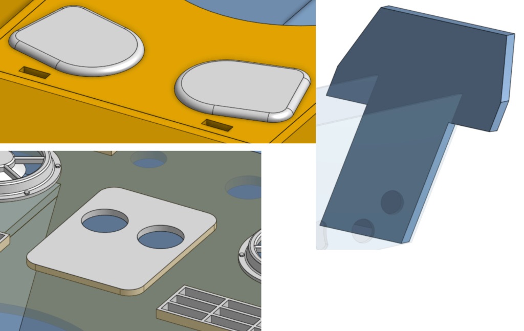

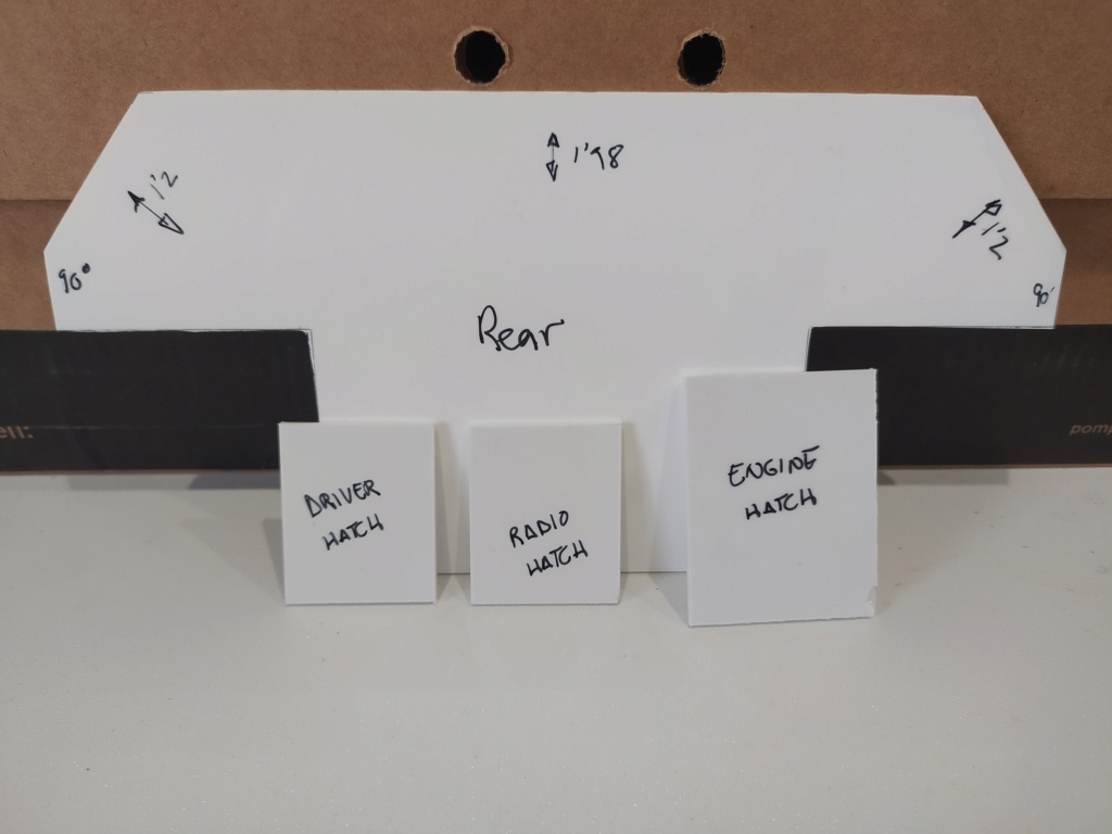

I keep preparing parts and adjusting details of the 3D model.
I cut the driver and radio operator hatches, enginge hatch, and the rear plate, ready for round and finish them. The Rear platae has a lot of bevels and it will take more time to finish:
The desired result:
:wave: :wave:

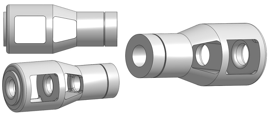

New advances!
Regarding the 3D model, I have advanced with the driver and radio vision ports, designed as the original blueprint:
And an initial version of the KwK 39 L/60 50 mm muzzle break. The truth is that it has been difficult to locate photos where the structure and shape can be clearly seen. There are countless models of the SdKfz 234/2 Puma (it mounts the same barrel), but each brand has designed it as they wanted. Finally I have based on this gallery from wikipedia:

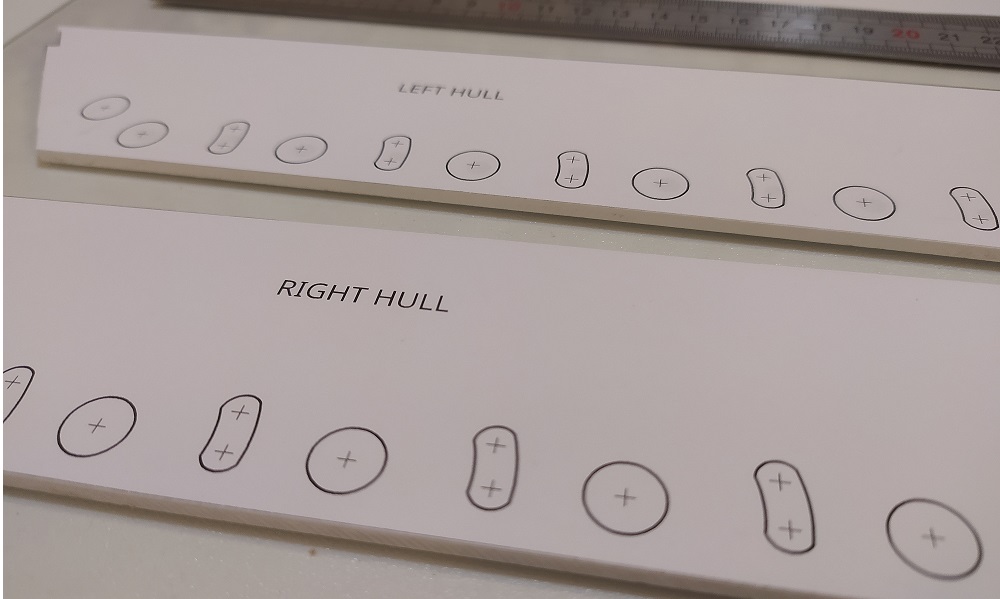

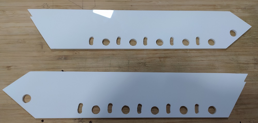

I have finished the hull sides with following these steps:
  1. Print the blueprints on adhesive paper and stick them on the inside.
  2. Drill in each hole.
  3. With the fret saw, cut out each hole.
  4. Smooth finish with dremel at low speed.
:wave: :wave:
