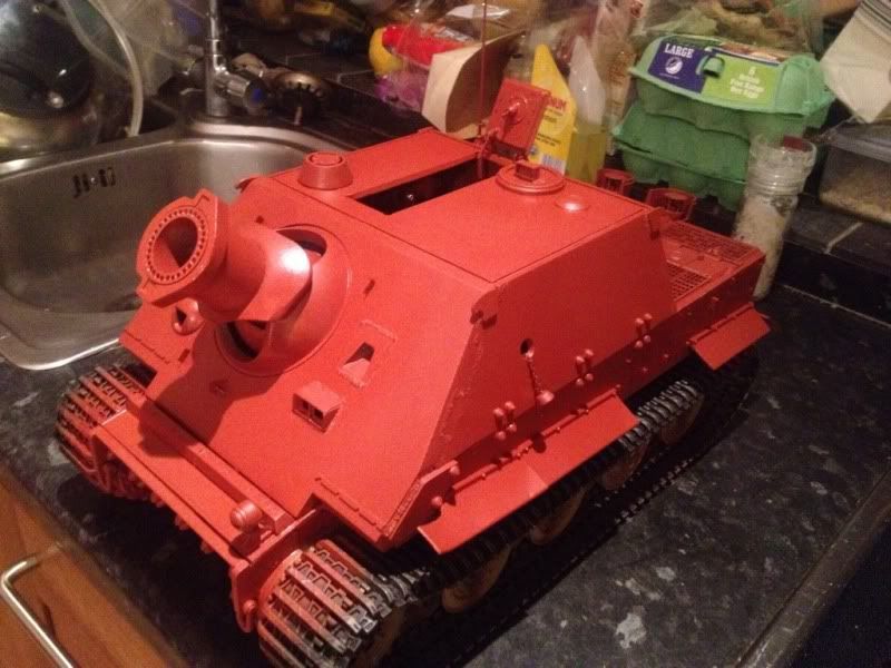

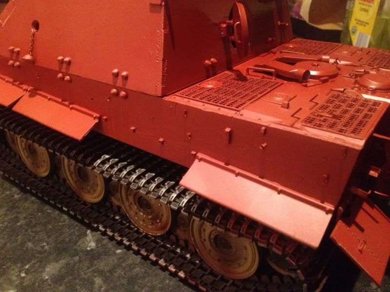

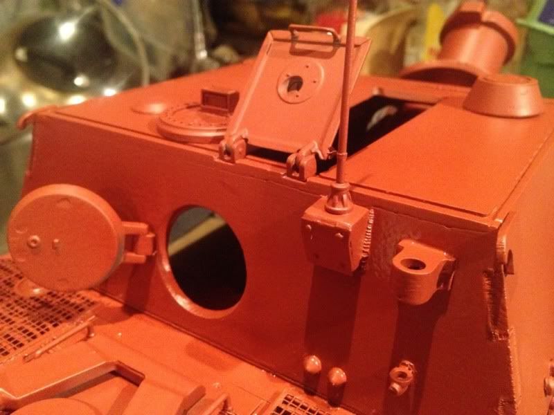

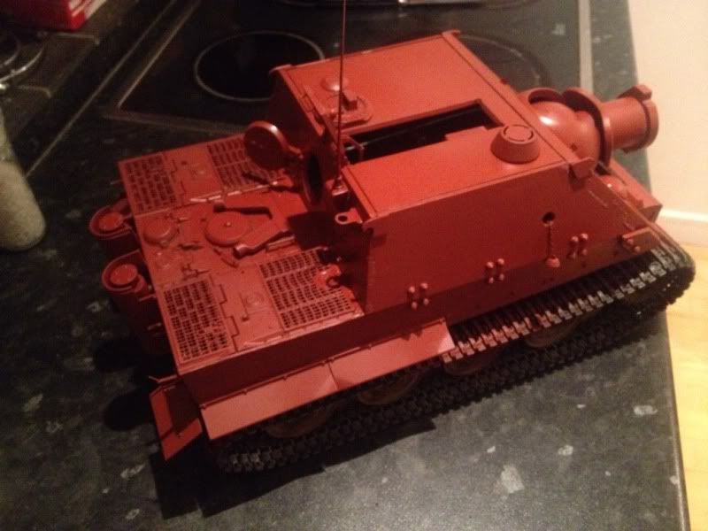

Some more progress, I've been trying to hack a servo to use in the traverse. Unfortunately the potentiometer in the micro servos won't be centered, 3 servo knackered I have given up for the time being.

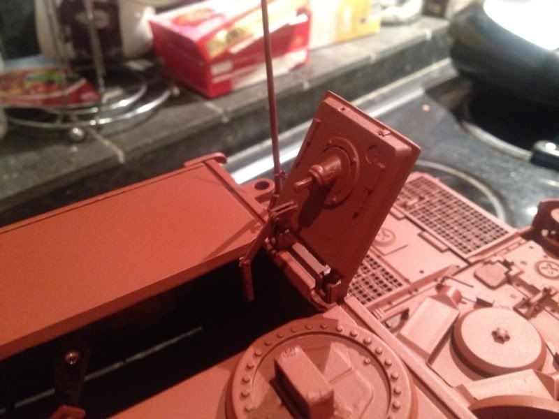

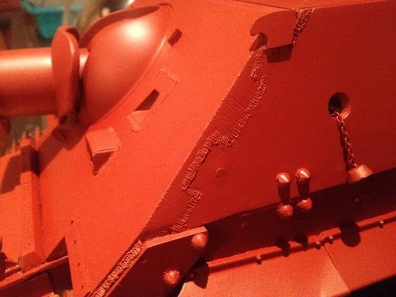

I've done some more detailing, added a 2m antenna and I tried to add detail to the left rear quarter as best I could from my sources. Finally I've started painting!
To be continued!

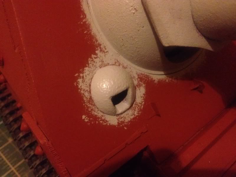

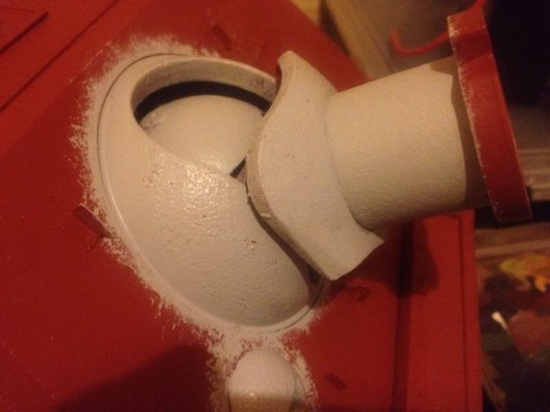

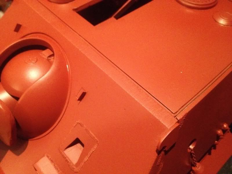

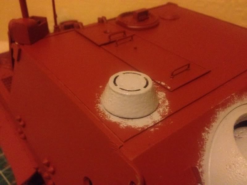

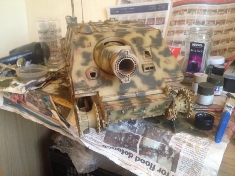

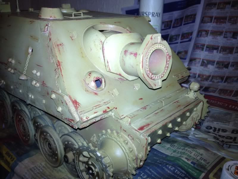

I decided that a cast texture was required in some areas, mainly the main gun and mantlet. First time using mr surfaced but it's come out ok! I've now reprimed the parts treated with mrsurfacer 500 too.
Slowly creeping to completion, hopefully I'll have a chance to get the dukelgelb base down and weathered tonight. Need to obtain a tamiya tiger speaker and a detailed mg from some where too.

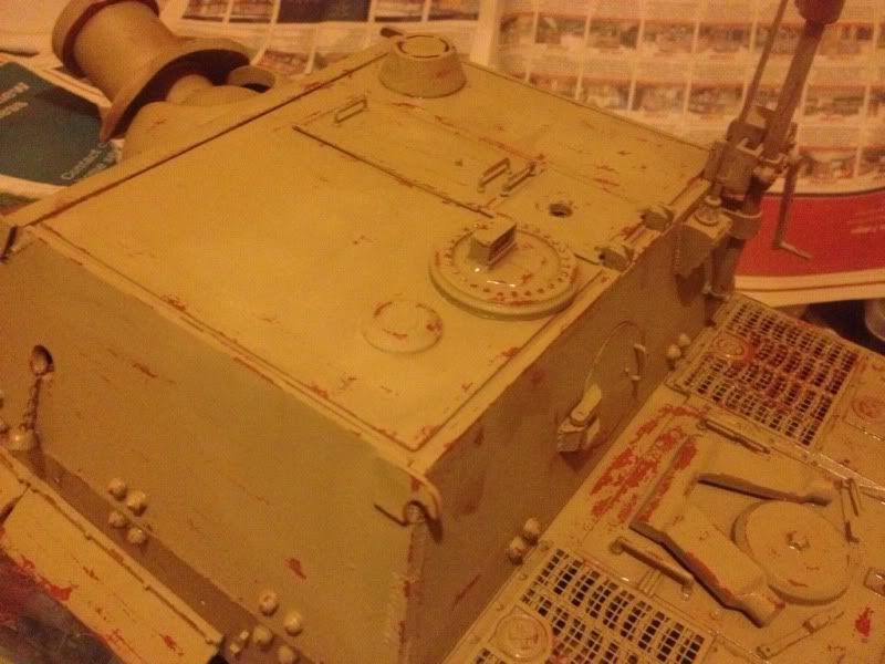

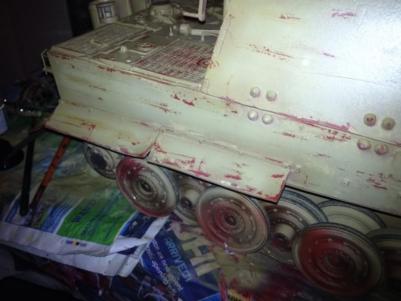

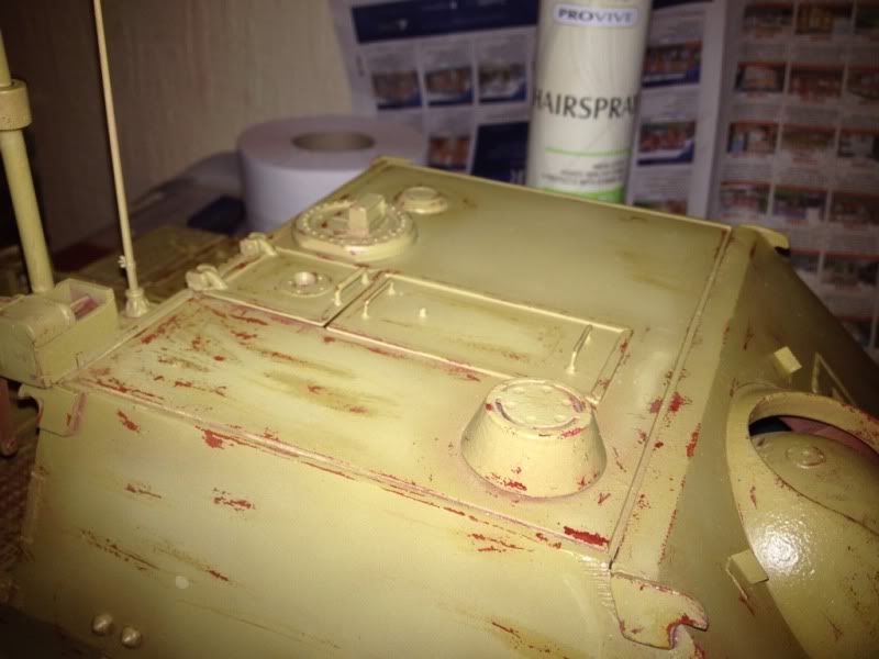

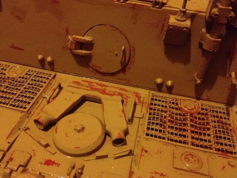

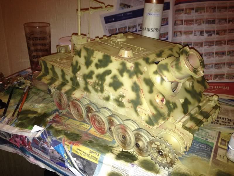

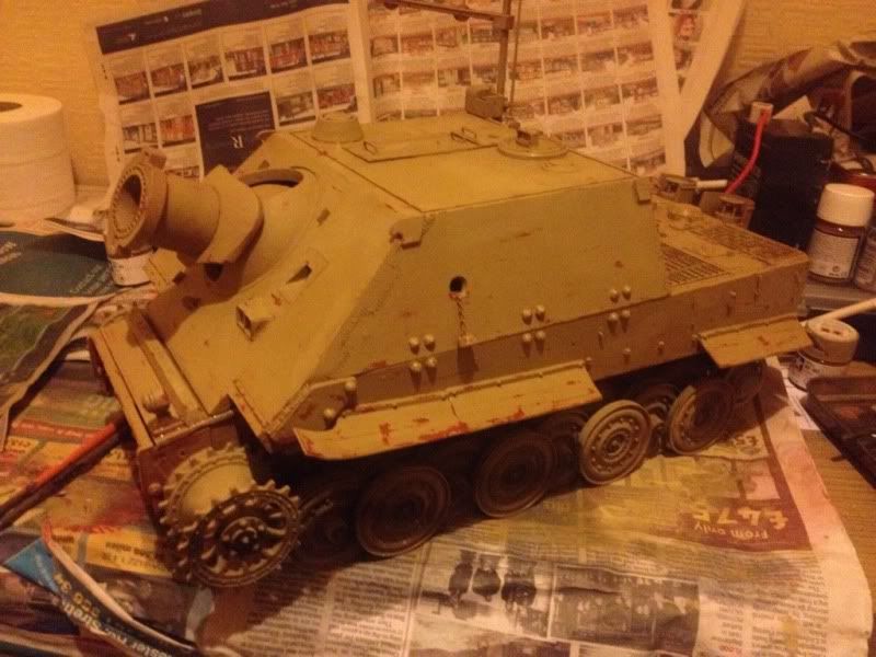

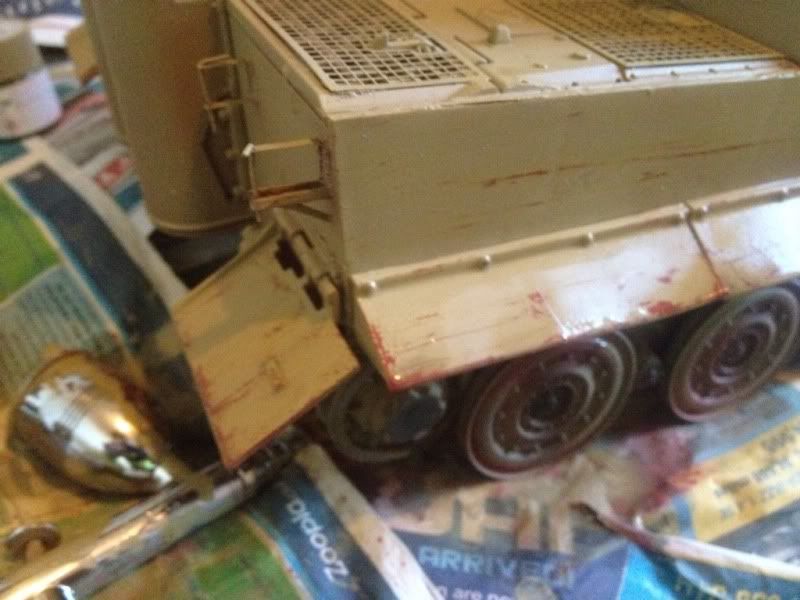

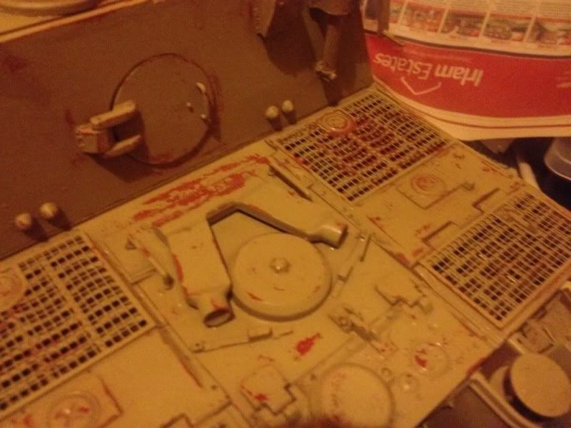

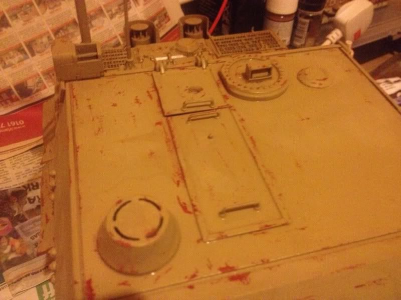

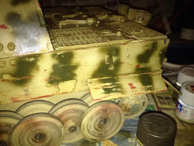

First layer of dukelgelb is on and chipped using the hair spray technique. I've tried to weather areas that would before likely to get chipped such as where crew would stand moving the shells into the casemate

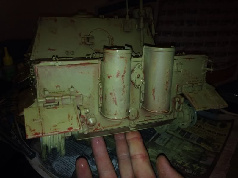

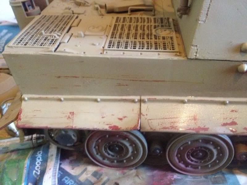

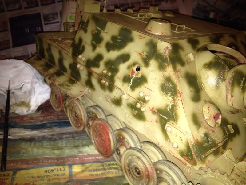

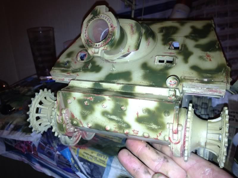

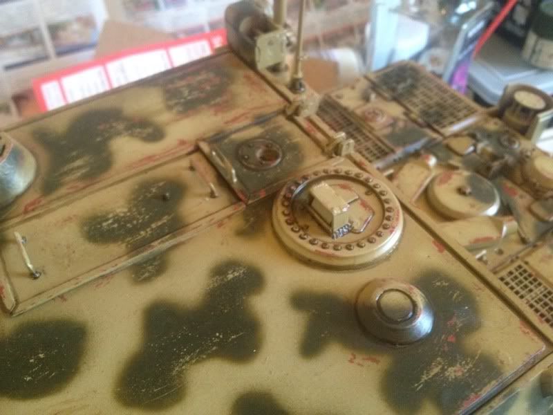

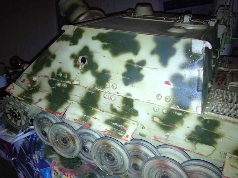

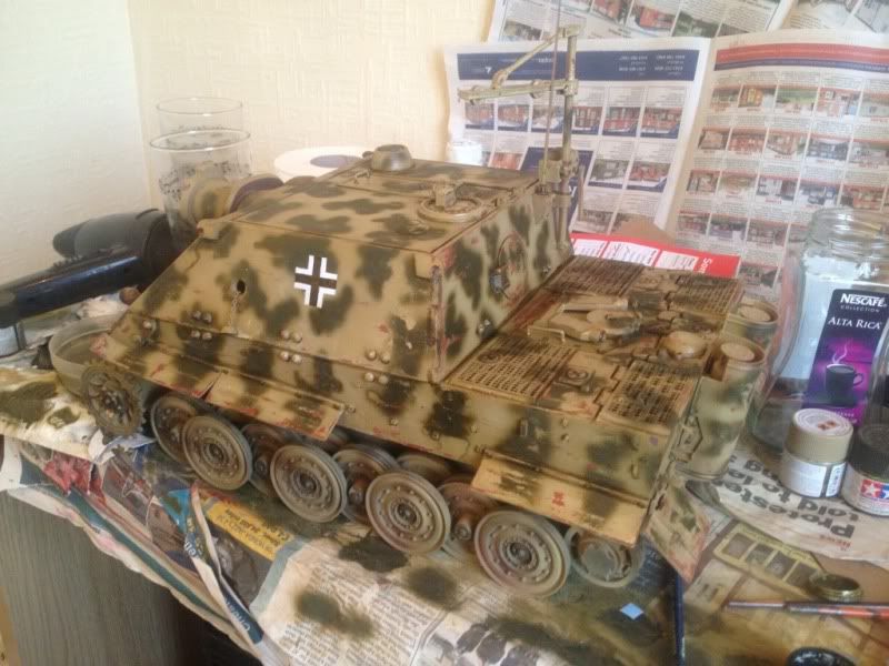

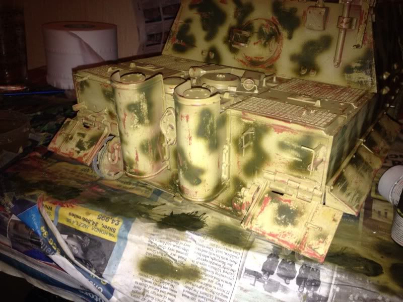

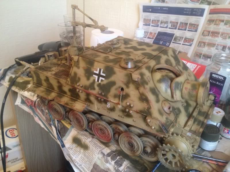

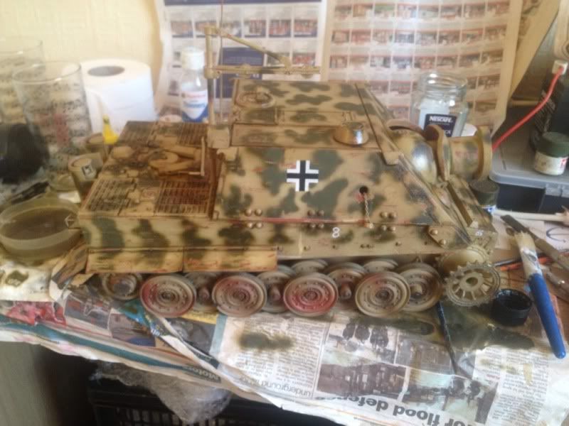

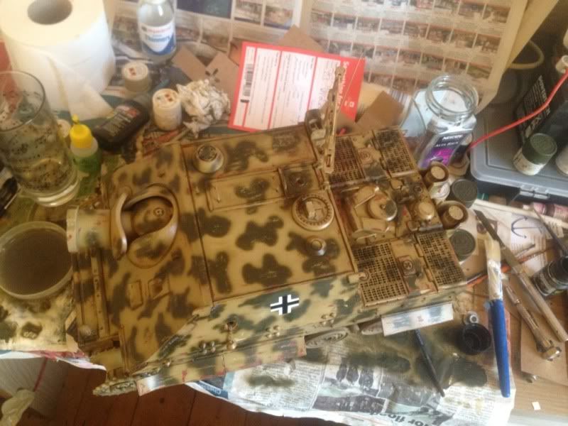

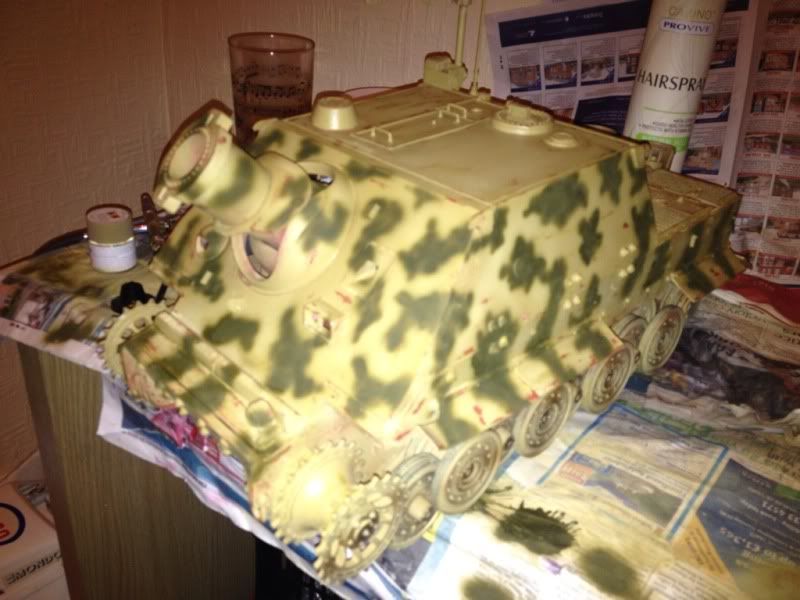

She's starting to take shape now! I've added some colour modulation of the dukelgelb then rechipped, then added the green camo and chiles that. Lots of layers! Its looking better than my tiger did at this stage so all good:
Modulation:
Camo:
And chipping:
That's it for now, as you can see I haven't added camo to the rear deck. The photos and colour plate don't show you this so I'm in sure about which to go for! Next I need to add balken crosses and some stencilled numbers. Then I can start pin washes, streaking and more grime!

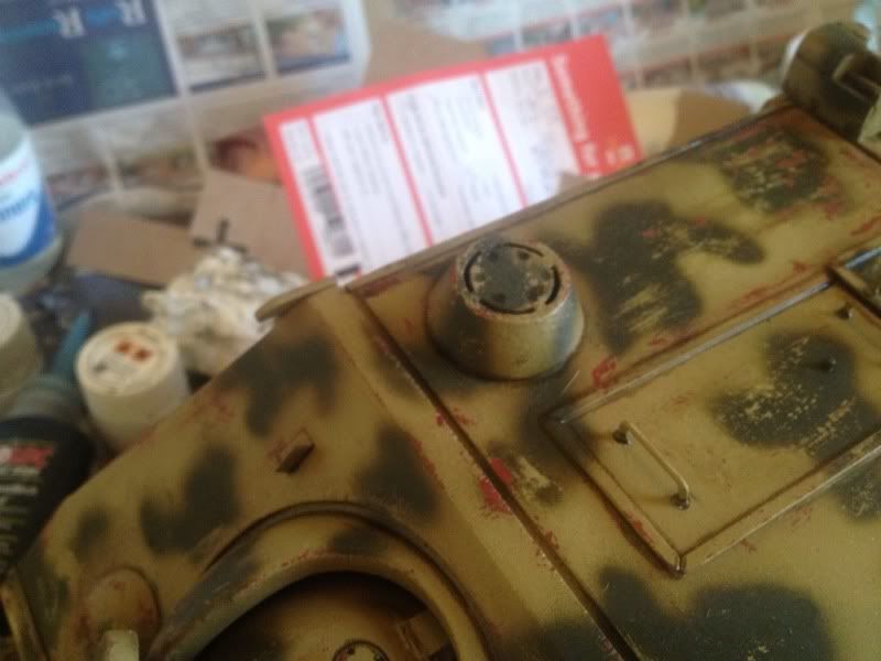

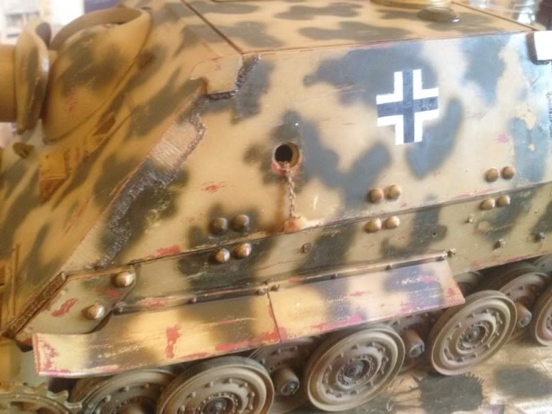

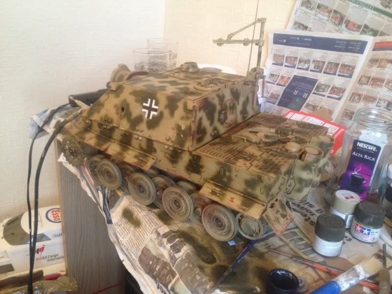

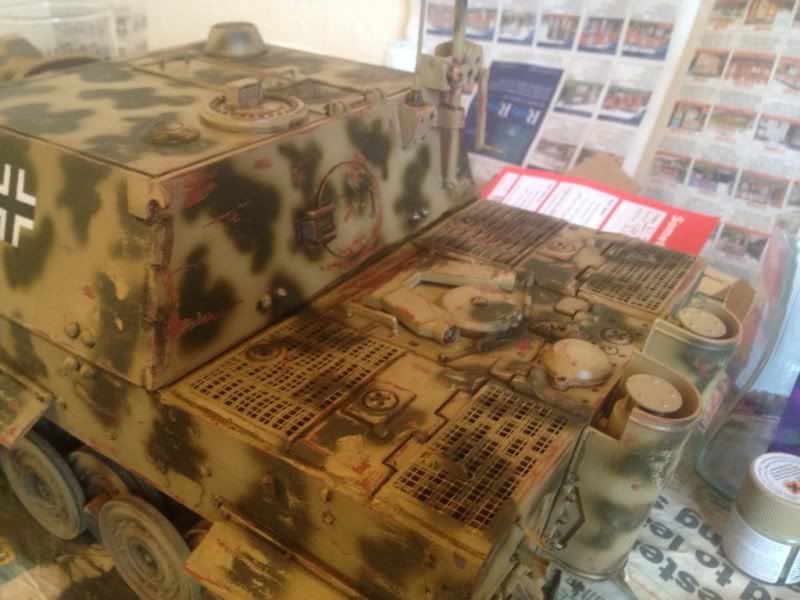

Well you asked so nicely! Yesterday I painted and chipped the rear deck and roof, I added some decals, decided I should try some stencils instead, apparently I'm very bad at this and nearly ruined my tanks paint job :( Luckily I was able to restore it and put the decals back again. Next I added some painted on numbers which seem to be present in the original, then started adding a pin wash.
