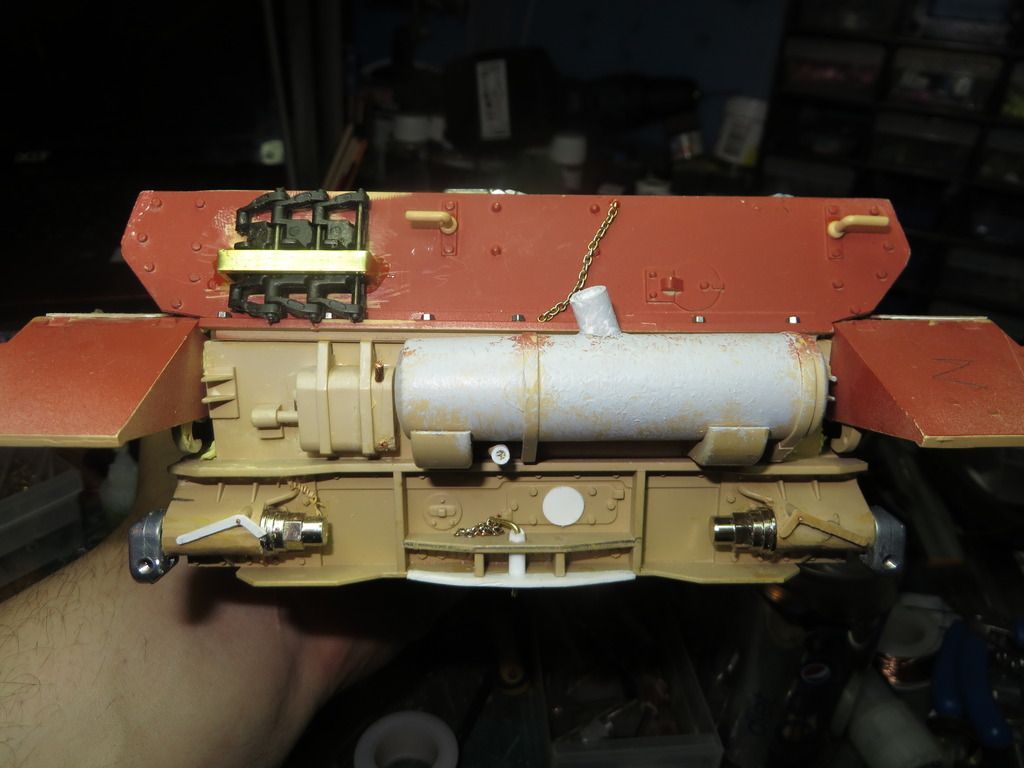

Thanks for all the kind words guys, I haven't done much lately as been busy with work, sat down tonight to add some detail to the rear end as Jarndice says its quite bare.

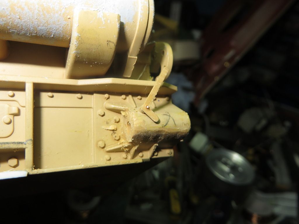

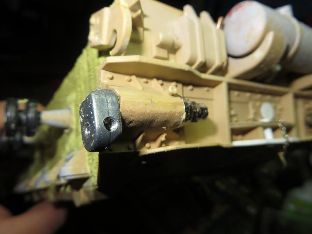

First mod was to lop off the track adjuster handles and then tidy up the stump with a file:
Then tidy the handles up (I had to remake one as it was destroyed during removal....) then drill the handles and the protrusion on the tensioner bodies, before gluing a wire into the handle, and fitting it to the hull. If you use a wire the same size as the drill, its a sliding fit and doesn't fall out, and its moveable too:
I added some other details to the back of the tank:
I punched out a circle of thin plasticard to form a lower inspection cover, which is missing on the HL. Then I added the small chain to tie the tow cables onto the back plate.
Also added some bolts along the rear bracket.
Finally I added a spare track holder, I have seen a few variations in photos, some appear to be factory items with a holder for three separate links, others like mine appear to be added in the field.
Going to have a go at making the rear fenders hinge next

A couple of small pieces of styrene tube could give you the drain pipes under the tensioner handles.
I like the inspection plate cover. May have to look into some punches.
You didn't happen to make the tensioner handle by creating a paper template and then transferring that to styrene did you? Maybe scan and post the template? That error has been bugging me but I'm not sure about trying to cut it off to fix it and being able to preserve enough to reapply or make a duplicate.

Thanks Philipat, done some drain tubes. The punches are OK but wont go through thick styrene.philipat wrote:Awesome work!![]()
I didn't do a paper template, I ground one handle off with a dremel, then realised if I had used the razor saw I wouldn't have to make new ones, so cut the good one off and used it as a template to mark a new one on some styrene sheet.
If you use a fine razor saw they should come off OK, I could make a template from my handle and scan in for you, if that would help?
