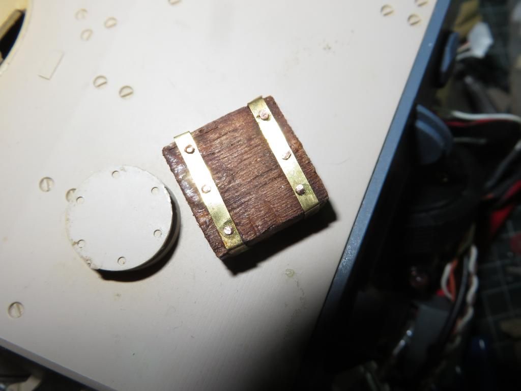

I finished making a jack block:
The rivets were made b gripping a short piece of copper wire in pliers and peining the end flat with a jewellers hammer.

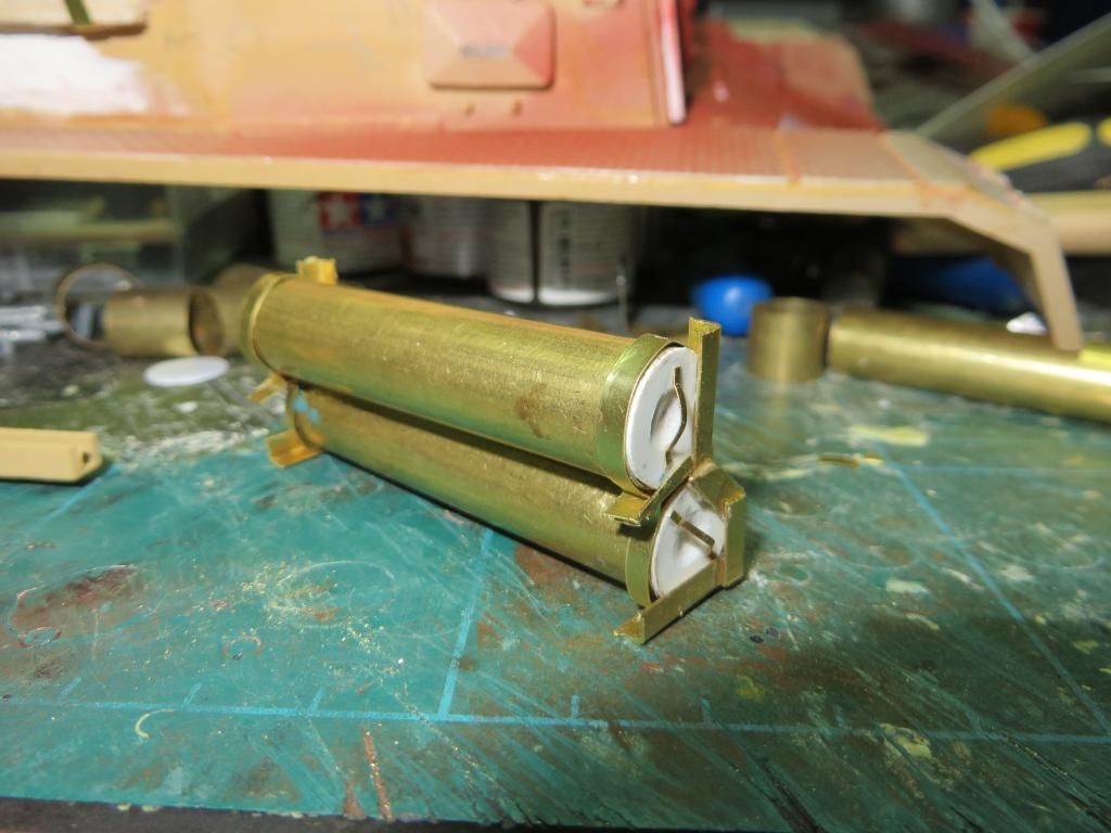

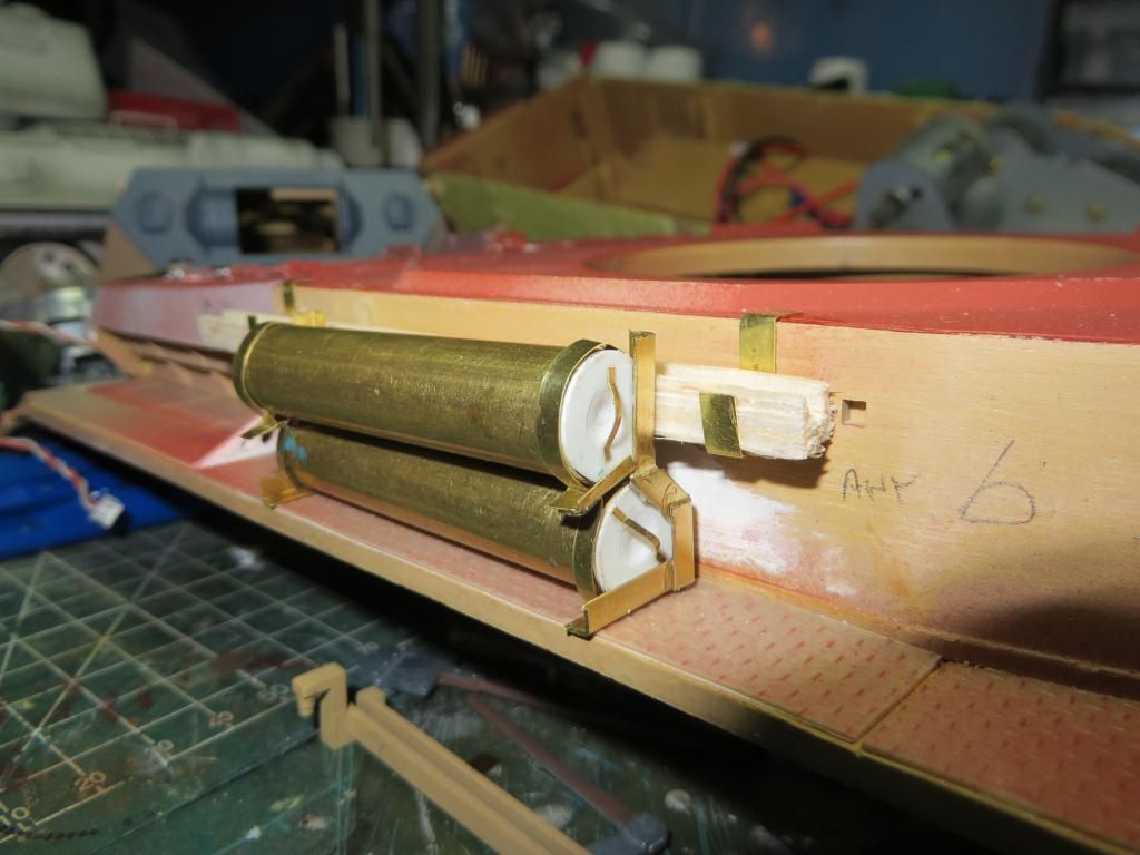

I have also made a set of external air filters from some brass scrap, the end caps were made with some thin styrene and a leather punch.
Not the best or tidiest job, just eyeballed from some pics on the net.
Quick dry fitting with antenna trough (the mount was deleted on the H and moved to the rear L/hand corner of the hull, I assume the trough was left so a spare could be carried?)

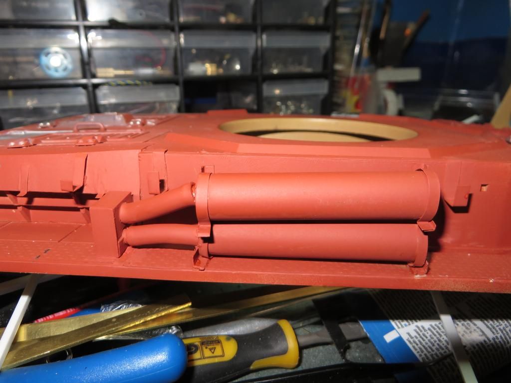

Hi Guys been busy, got the air cleaner assembly finished and attached, quick blast of primer: Image
The box the pipes go into is some scrap styrene and the pipes are fish tank airline.

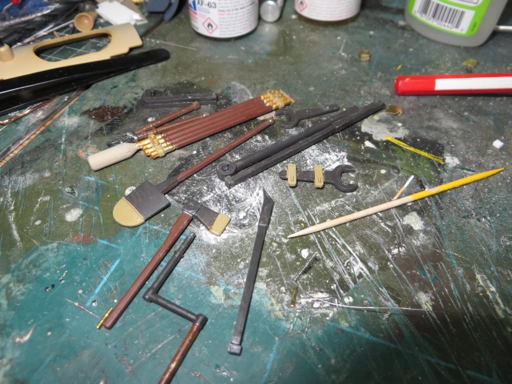

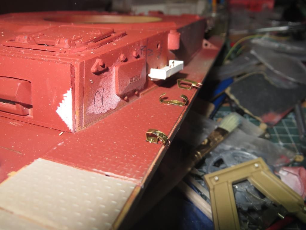

I have made up a set of tool clamps from some scrap brass sheet and copper wire, not aber but they look OK and are easier to make!Image
Also painted the tools, will probably weather these a bit before they go on the tank

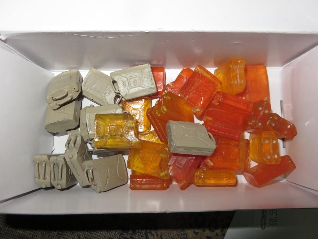

I have sorted the jerry can situation, I won a job lot of tank stowage on fleabay, included were about 35 cans and a mould to make more so no shortage :/

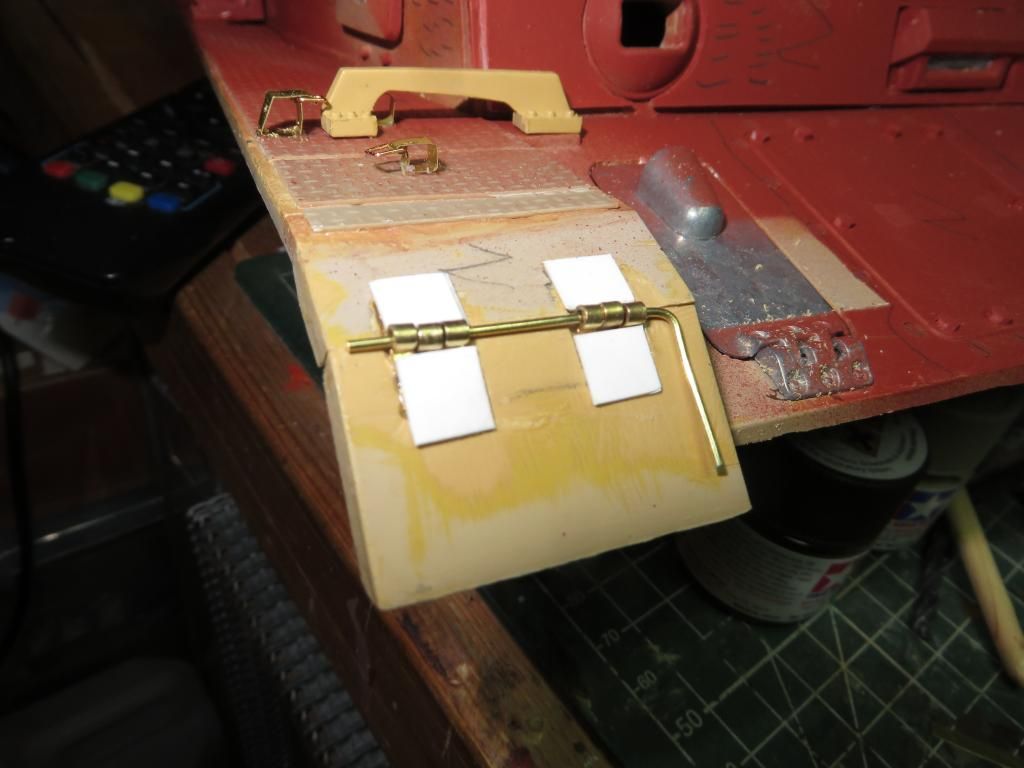

Finally I had a bit of a play with those front fender hinges, I did look through the links provided by you guys, loads of useful stuff but couldn't find anything quite right for this, so I cut the fender off and ground out an area for a chopped down dolls house hinge, once this was fitted I added some styrene to tidy things up and a pin from a brass offcut, what do you think?
I will probably thin the fender down with a dremel, as its way too thick at the moment.

The bloody dolls house thing again :wtf: :crazy:
I like the clamps mate, the concept of an Aber set just puts me to flight !

Nice clamps.
Do tell more about the doll house hinges. Are they already sized to allow you to replace the pins with the brass rod?
Herman Bix, don't like the doll house hinges?
Posts: 11722
Re: Panzer IV Ausf F1 to H Build
Oh no mate !!..............I like them, its just an ongoing 'thing' about the first place some lucky buggers go to for TANK parts, is a DOLLS HOUSE shop !!
These places are like mystical worlds that seem to supply no limit of option for the most unlikely of requirements for guys that build damn TANKS :/ :/ :crazy:
