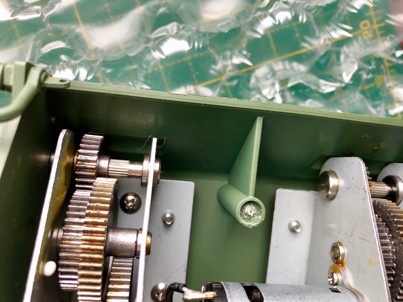

Here's the unit in place in the plastic HL, prior to the transplant into the Taigen.

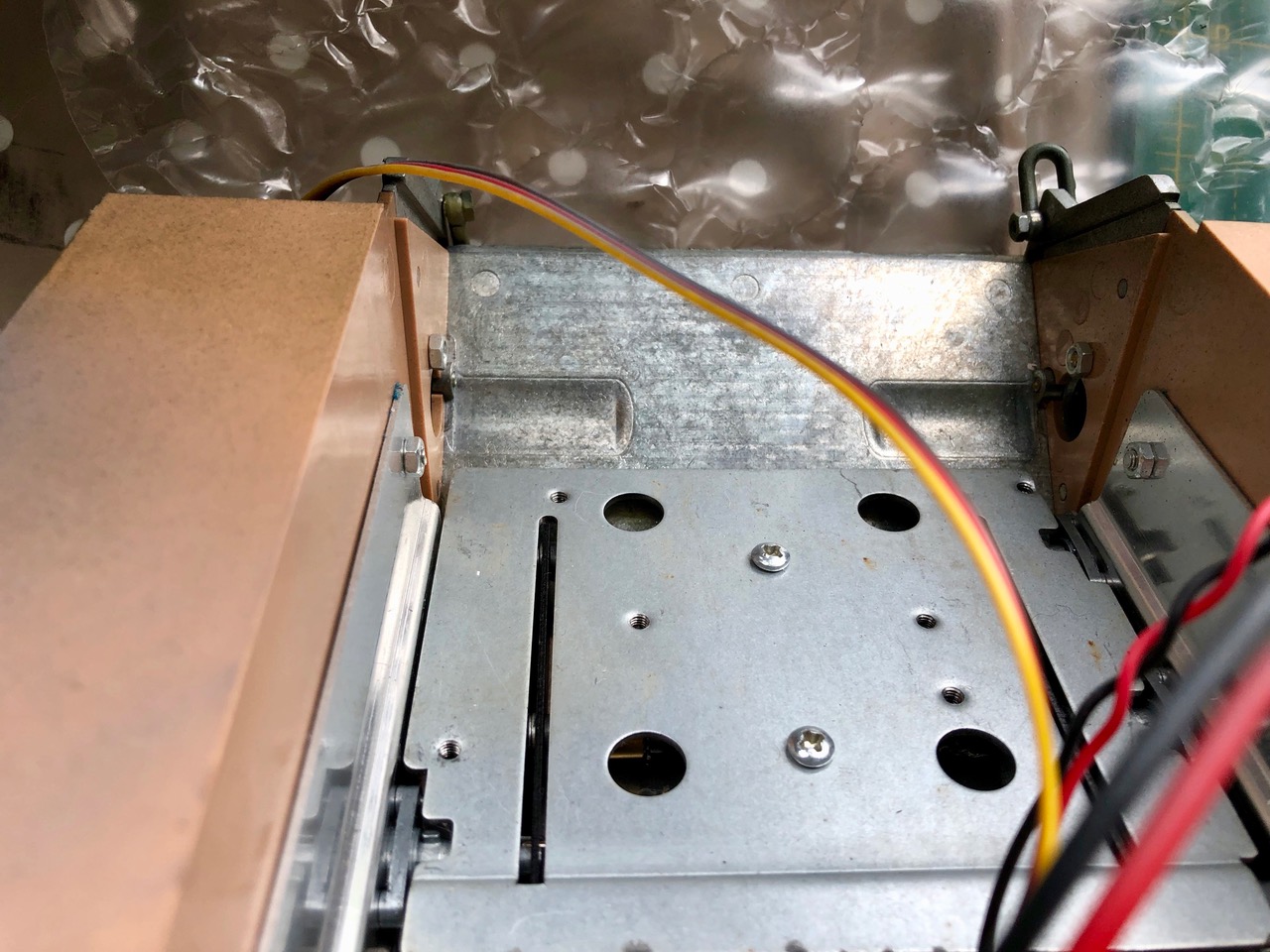

Taigen Hull The Taigen
metal hull has a switch plate incorporated into the hull floor. The plate includes a volume pan pot (potentiometer); an on/off switch for the smoker; and an on/off switch for the main battery supply. As it stands, this plate is redundant. Why? Well, the V6.0 unit has its own independent power switch, whilst the smoker and speaker volume controls are managed electronically by the transmitter.
I'd say, it's safe to remove the plate and associated wiring, and then blank the space off.
This is what the HL plastic hull looks like, naked:
I may put some small plant pots in it.

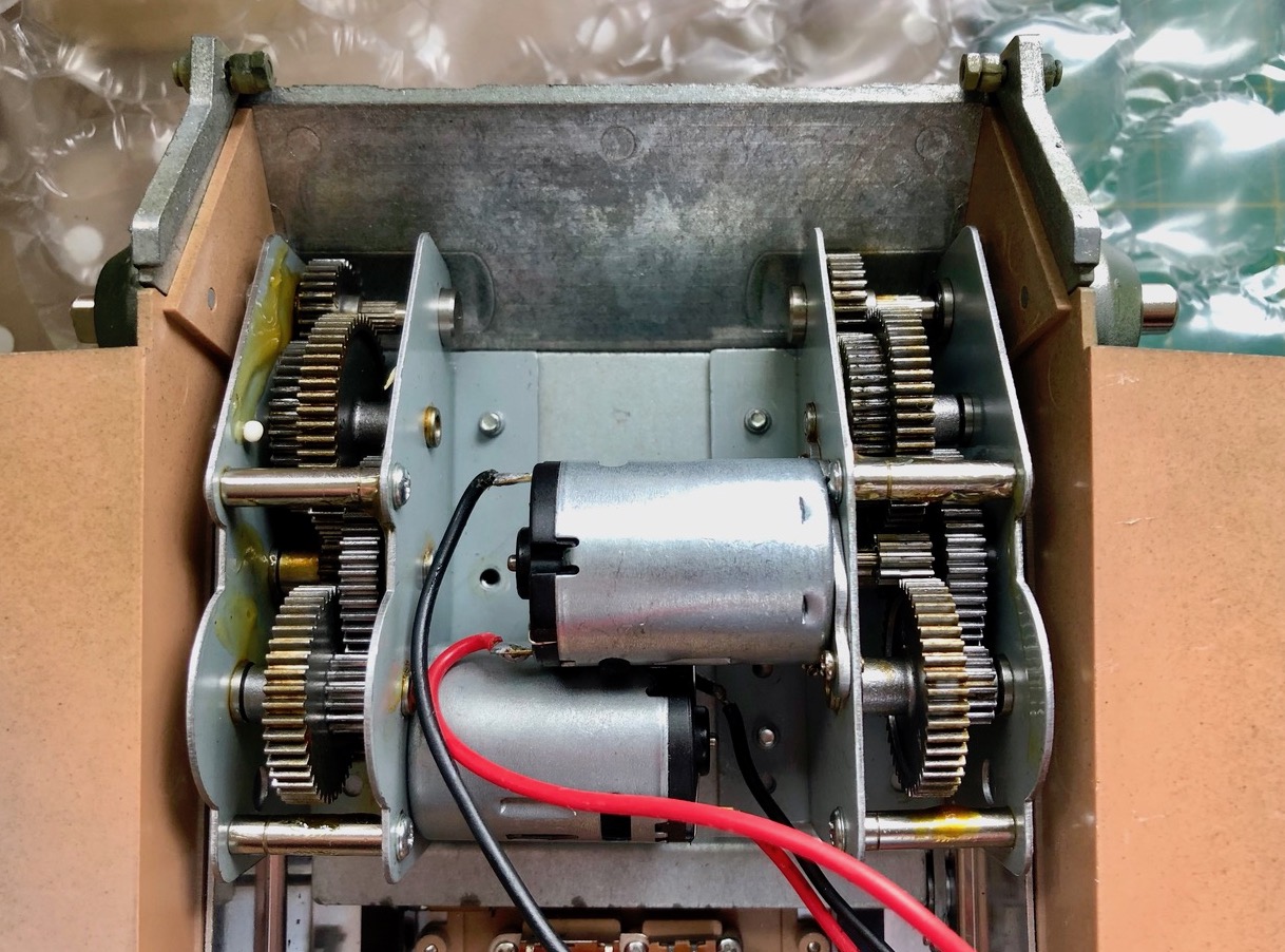

More later, when I get round to transferring the guts of the plastic
Panther to the Taigen special. So far, the motors and tracks are in place, without a hitch
