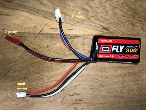

It's time for comic relief. I set out today to bind one of the FSiA6 receivers, following the instructions for the FlySky FS-i6X 6-10 transmitter. I had to print out the instructions from the FlySky web site because they were not included in the box with the transmitter. :wtf:
I had three connectors from the battery to attach to the receiver. That's 33% odds of success, hardly idiot-proof.
Given one 3-prong plug that fit the three prongs of the B/VCC connector, I chose the 3-prong plug that fit. You guessed it: :O

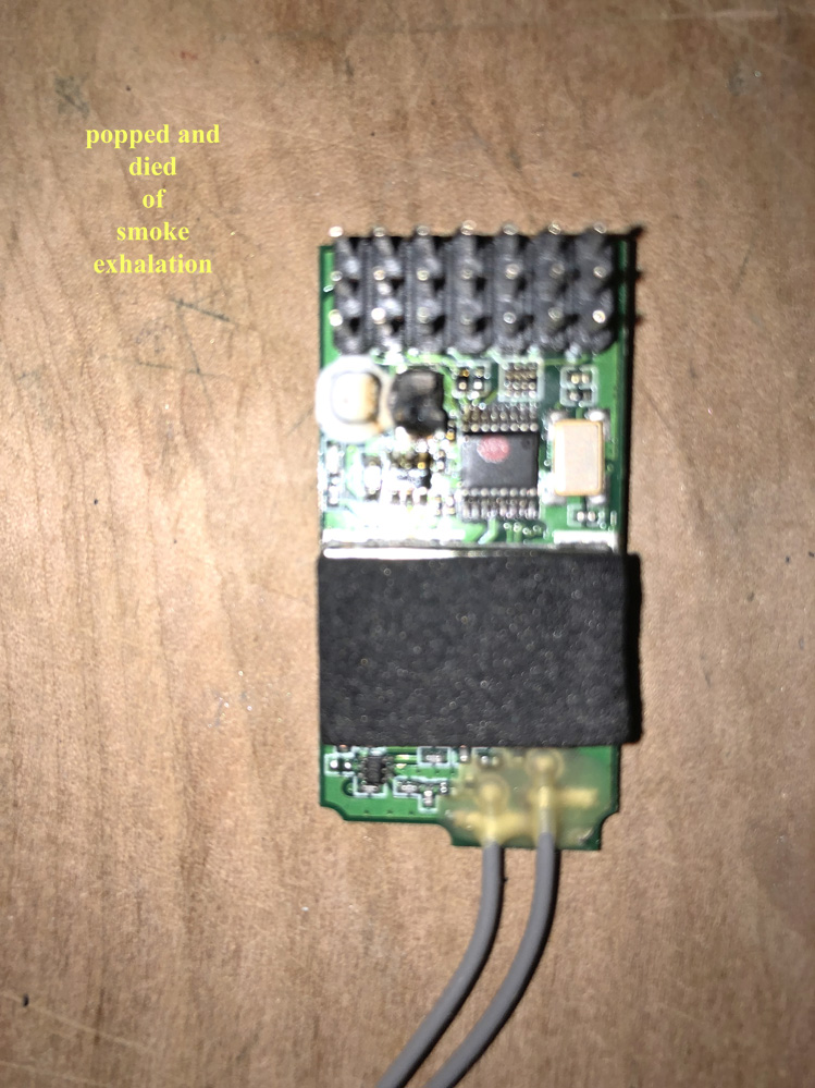

(I removed the plastic cover from the receiver after the fireworks display.) I do have another FSiA6 receiver (I bought two; should have bought three or four). So how do I try binding the second receiver, avoiding the POP! the nasty smell, and laughter amid the tears? :'( :haha:

Plugging a battery straight into a receiver is not a good idea as you found out professor :O I use an esc ( electronic speed controller ) which the battery and receiver plugs into separately to bind all of my receivers :thumbup:

I checked and checked again. I was following the directions in the FlySky manual. :-< I did not know that the ESC could be in place between the battery and the receiver during the binding process. If I understand correctly, plugging the battery into the ESC and then to the receiver is the final set up, but it must be a wiser choice even for initial binding of the transmitter and receiver.

It is possible to plug a battery directly into a receiver professor but usually only a 4.8 or 6v battery, a 7.4 2s lipo will have the effect on your receiver as you've already found out. You can use one of the cheap 20/30amp Chinese esc to bind the receiver, just set it up as if you were installing it into your model ie the esc throttle cable ( labelled as D on your photo at the top of this thread ) goes into the receiver throttle channel and then the esc battery plug ( labelled as A above) connects to your 2s lipo battery plug, the receiver and battery do not come into direct contact with each other as they are both plugged into the esc separately where they can be regulated.
I'm not sure on the binding procedure for your receiver but normally for the bind sequence you place a bind plug into the appropriate pins on the receiver ( usually marked ) then when the radio and receiver are bound you remove the bind plug and use as normal, hope this may be of some help to you :thumbup:
