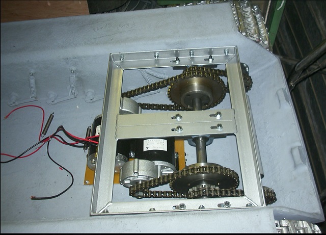

Hey Max, the best advice i can give you is to dump those crappy little motors as they are not man enough for the job. They allow the Hetzer to move about on a hard surface, but it will not turn well on grass or any loose or rough ground and is prone to stalling.
I know a few in the UK, and they are not really much better than a Heng Long setup.
The speed 400 motors are a good upgrade for Heng Longs and those have more grunt than the motors in your Hetzer.
Now is the best time to sit back and work out a decent drive system otherwise you wont be able to get the best out of it.
This is what the Mark 1 Tanks chain drive system looks like.
This would be ideal, although you could run a bit lighter setup in the Hetzer.
Good luck
Tim

First, Thanks, Tim, I'm planning to have a go at copying the mark one set-up. I can make the frame myself and all I really have left to sort out are the motors themselves. I need to do the math and figure the RPM needed at the sprocket to generate a scale 20 to 25 mph, about 3.5 to 4 mph actual speed. Then I can figure my reduction through the sprockets and get motors of appropriate RPM.

OK, I ordered motors (24 volt 350w), chain and sprockets, and a couple of 6S lipo batts. The sabertooth 2x32 arrived this week so once the rest of the parts get here I can get her running and test things out. I'm guessing two weeks for the motors to get here from China (where else?) but you never know about shipping from across the Pacific.
The current plan is to just use the sabertooth and the 9X for testing, then add a 7.4 battery to power an IBU for a motherboard to get stuff like lights, smoke, and servo control for the MG34. I'm debating whether it will be worth the work to add sound effects for elevation and traverse of the main gun, and I'm leaning towards not. For the paintball system I'm planning to use pots to control elevation and traverse of the main gun, and those will run directly off the RX. The i10 is probably the perfect radio for this tank in the hands of a Gomer like me, so that will be the final TX for this tank.
