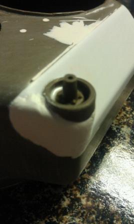

Just a small update. I've added inspection plates to the radio box housing, and begun adding applique armour to the front of the turret. I've always found it to be a hair-tearer bending and shaping styrene, but somehow managed it with the 'Normandy Cowls' on the Comet and Cromwell. Here, what I've done is to get sheets of .2mm styrene with which to build the plate up, in easily bendable layers- a bit like plywood. I made a template first of all to cut the bits I needed. So far, so good. The 'welds' round the edges will follow (Fine Milliput), to conceal the lamination.

...and trying to usher in the New Year on a more positive note, I've ut some casting numbers on the turret (probably in the wrong place- but who cares? :D ):
After some 'weld' beads here and there, I'm going to daub Mr Surfacer (500) on parts of the turret to give it that acne-like, dimpled, pitted cast look. :) It could be a disaster... :/ :D
but I hope it should work if it's stippled on carefully. :think:

Again, a little update. Here, I've added the periscope cages seen in the very first pic in the thread. They were supplied by Forgebear, along with the customary seasonal salutations, and very welcome Haribo Goldbears. :thumbup: What a true gent. :clap:
I've just bonded them in place with JB Weld two-part epoxy (for Metal- but superb for mixed material components). You can also see the coating of Mr Surfacer 500, which has been applied to simulate marks, and pitting, associated with the casting process. As with all additions, keeping the scale compatibility is always the biggest challenge. :)
Once it has all cured, I'll give the turret the lightest rub-downs with ultra-fine wet and dry. After that, there'll be more primer, and then some coats of British SCC15- Olive Drab.
