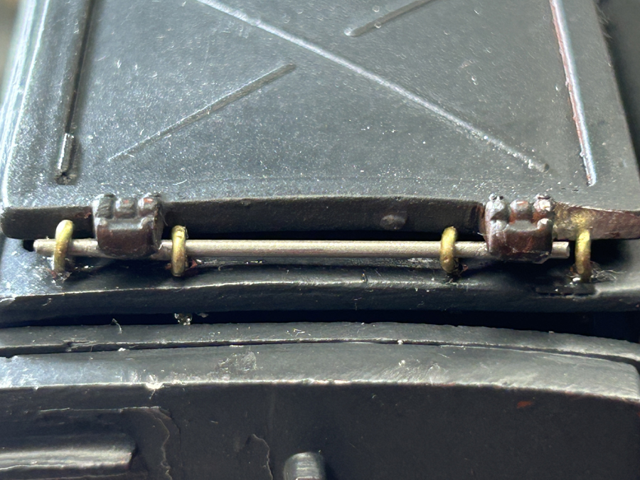

With the winter build T26E3 Pershing waiting for parts and the Mato M10 somewhat weathered and again underway, with supplies just arriving today, I turned back to the FAMO as a static build. Just to prove that at least something is happening, here's my latest, baby steps of scratch building: home made hinges for the storage boxes on the sides of the bed.
The cast "decorative" hinges are too small to drill through to hold even the smallest steel wire I could find (less than .5 mm) that would stay rigid. So I fashioned loops out of brass wire, drilled holes for them, attached a long steel pin to the decorative hinges with E6000. After that dried 24 hours, wiggled it all together. (When upright, the steel pin will drop into the bottom loop (on the right). When it's cleaned up and touched in Dunkelgrau, it won't look so bad.
toolbox hinge.jpg (468.28 KiB) Viewed 2065 times
I had to make the doors so they could open and close, but "piano" hinges or "door" hinges will not work because the castings are so crude that in 1:1, the storage box doors themselves would probably suit the glacis of a tank. :-<
