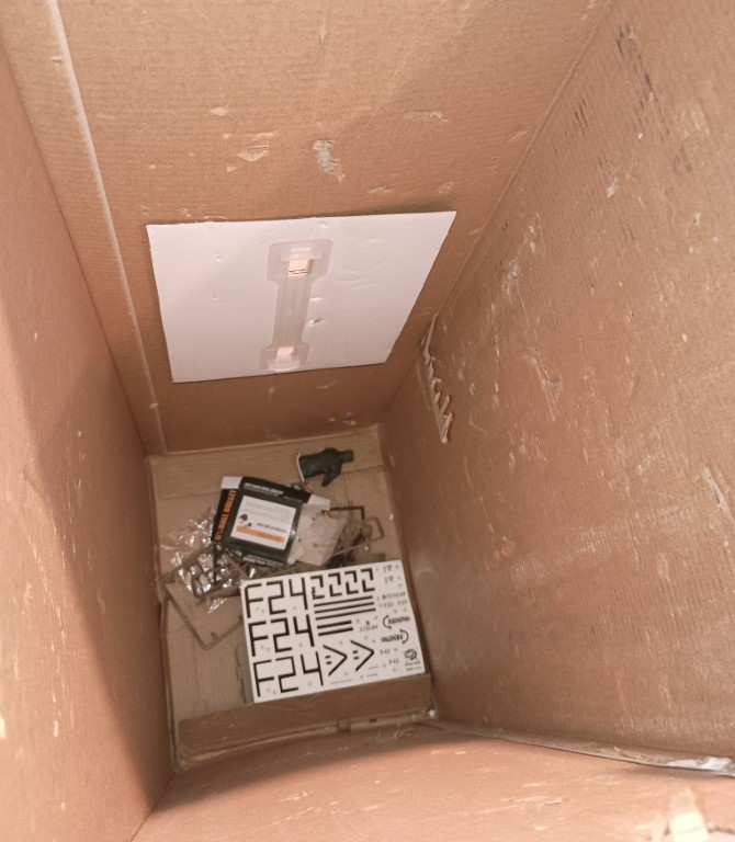

No Not the tank, it was there, I'd already pulled it out when I took this picture. The missing thing was the the foam insert that keeps everything separate and in place, the critical component that keeps 20 lbs of metal upgraded tank from beating the box and everything it including itself to smithereens. While the foam insert was missing the box did contain bonus items:
  • An amazon return slip, not from the customer but something generated as part of Amazon's return process as near as I could tell.
  • A generous amount of dirt and dried grass.

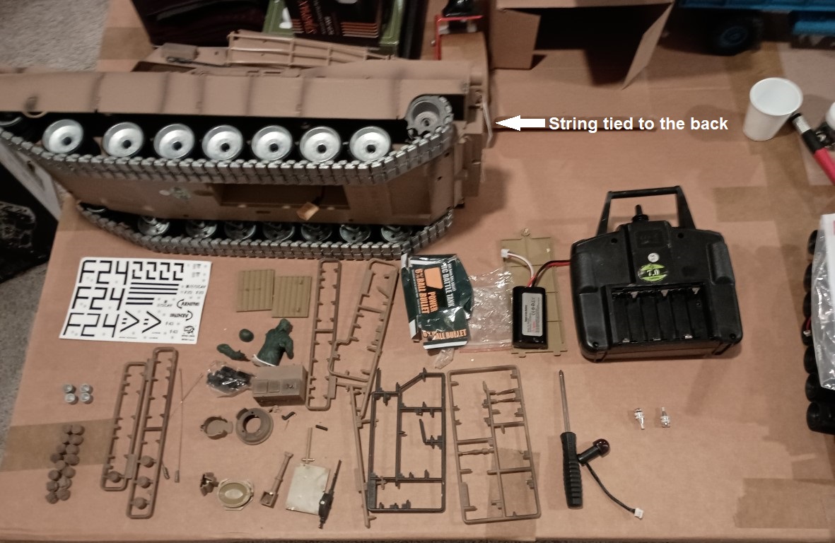

As I unloaded and inspected the contents it was pretty clear that someone had purchased the tank on Amazon. Removed just about every accessory from the sprues and attached them to the tank used it (a lot). Cursory inventory and exam indicated 90% of accessories were either broken or missing entirely, later detailed inventory confirmed this. The battery door for the transmitter was MIA as were most of the metal hubs for the road wheels and both sprockets.

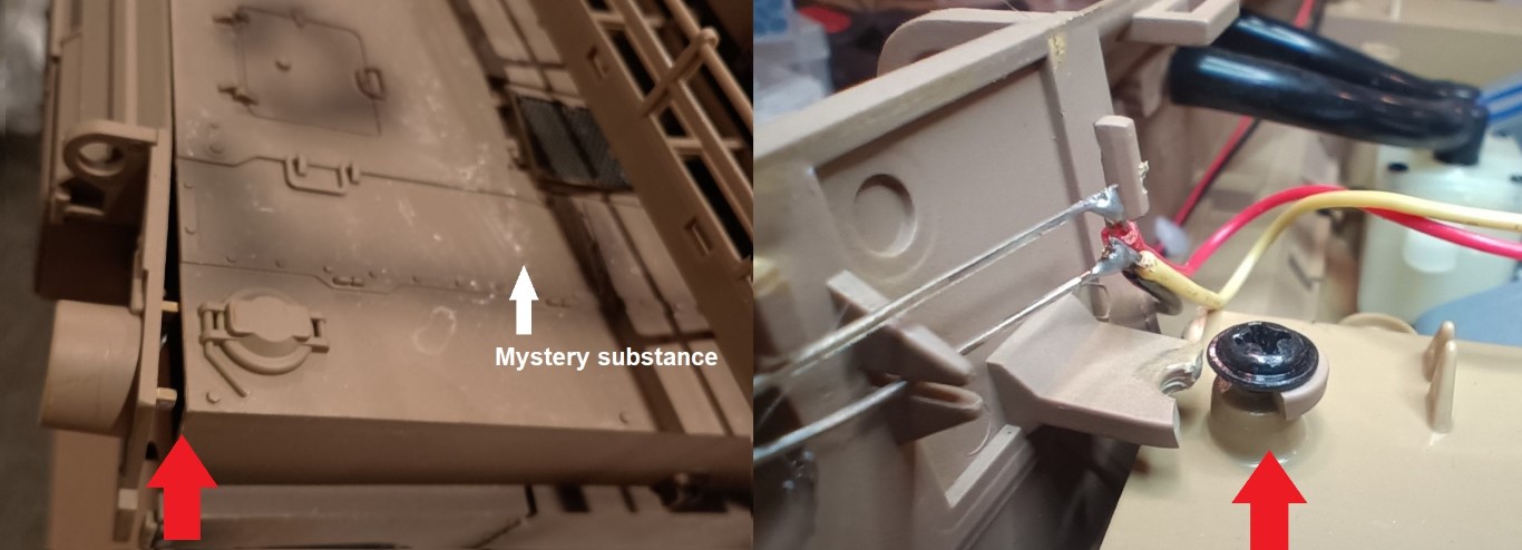

Suddenly it hit me! The string tied to the broken rear panel and wrapped around the axles and the mystery substance all over the upper hull.... The previous owner had been had been tying dog toys?, sticks?, and who knows what else to the back of the tank and dragging them around to entertain their dog(s) who in turn had been drooling all over the tank. Then either because the tank had stopped working or they were bored with it, just dumped the whole filthy broken, parts missing, dog drool coated mess with the battery still in the tank into the box and sent it back. Almost all of it anyway, although I suppose parts could have gone missing out of one of the many holes in the boxes. That part wasn't so surprising some people wouldn't have a problem with it I guess, that Amazon would accepted it like this was, that they accepted the return and noted it's condition as "New Open box" was very. I kinda felt bad for toucanhobby that they had to take the thing back. It was really a mess, there was grass and dirt inside the hull even.

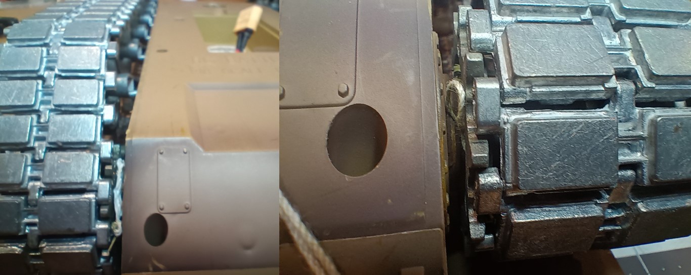

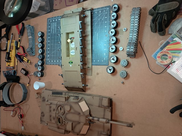

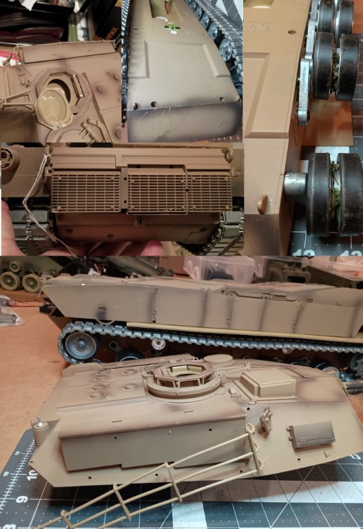

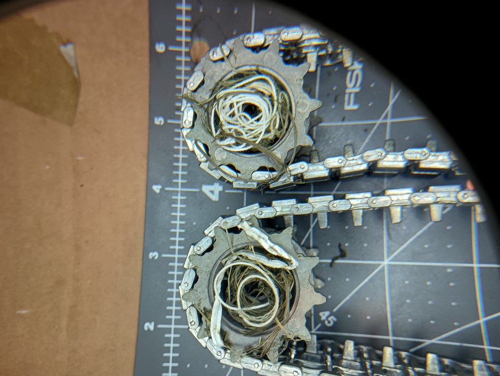

After thoroughly checking it out and documenting it's issues I set about cleaning, lubricating, and repairing. Of the original issues listed in the ebay description.
Tracks: Copious amounts of string, grass, and a wire tie wrapped around the axles under the sprockets.
Speaker: Volume was turned all the way down.
BB shooting unit: Doesn't seem to have a problem.
Turret: Motor and gear checked out, worked when it was reassembled, might have been but it isn't now.
I'm happy to report the poor Abrams has made a complete recovery.
