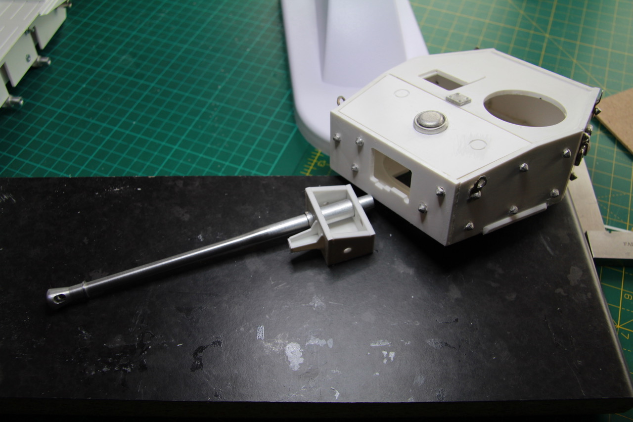

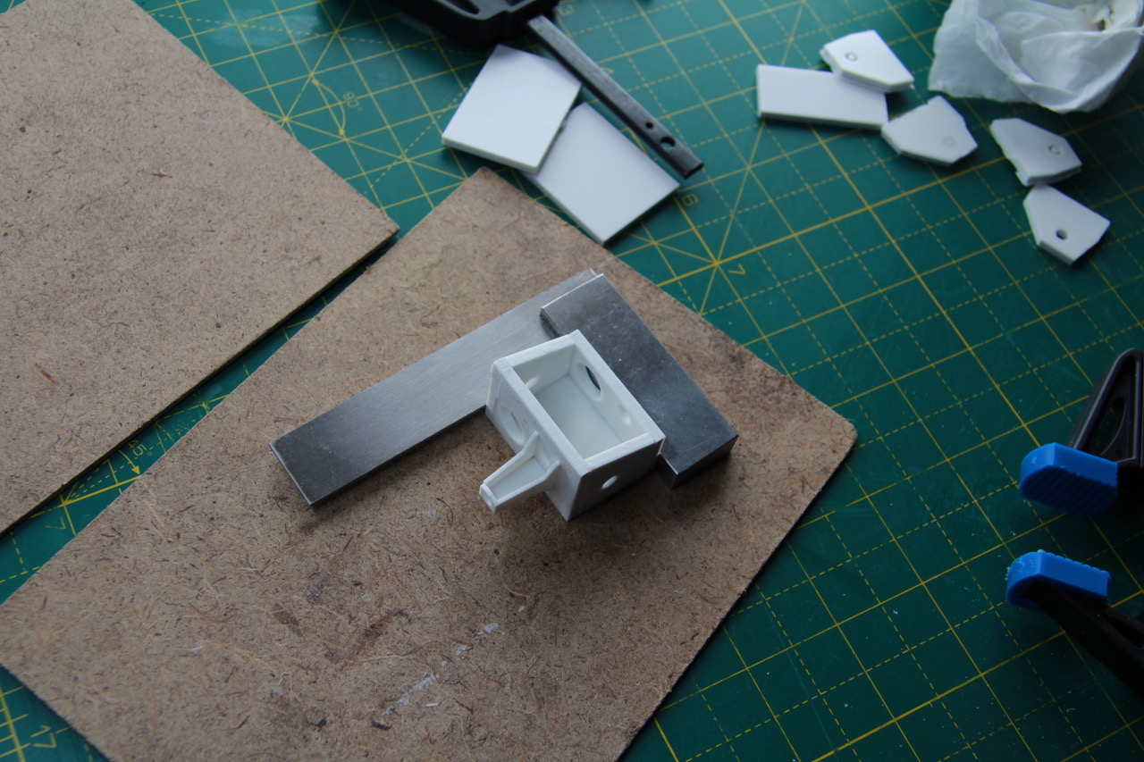

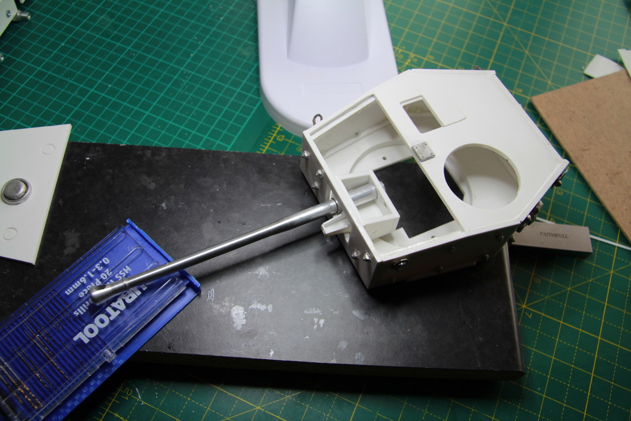

A little more progress. While I ponder the future drive system, electronics, and wiring options, I'm getting to work on the Gun Mantlet. This is how I assembled it. I've yet to fit the pivot brackets inside the turret, as I'm mulling over the dimensions of the potential firing mechanism. It could be Clark's recoil and elevation setup..but that would also require a Clark MFU..probably. Or, it could be the standard Taigen IR/recoil unit. I have a spare Taigen
MFU and TX, and if that could take the Beier soundcard (I think it does..), so much the better. :think: Don't think airsoft unit would be an easy match, although there's about as much room in this turret as the Pz 4. Also the barrel has a bore of 5mm or so. Too small for standard BBs. :|
MG assembly in mantlet
Mantlet frame
Mantlet frame
Gun support complete
Gun and gun sleeve in Mantlet
Have Gun will Tra..verse! For oldies..
Just to get an idea of the practicalities of having the gun in place... ;)

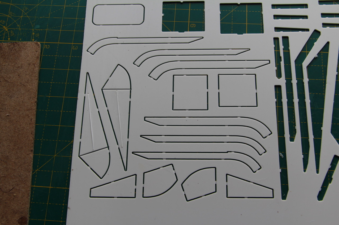

and a little bit further with the Mudguards...The front units are built using the same method us the rear ones. Firstly, a layered (3 layers) spine, or former is bonded together. After that, the main panel is glued to the spine.
Because the mudguards are quite thin, and because styrene is not as tough as ABS, I've begun adding reinforcement here and there. The unwanted portions of the sprue sheets are ideal for this.

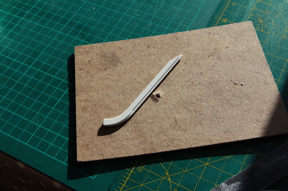

Extracting the right parts

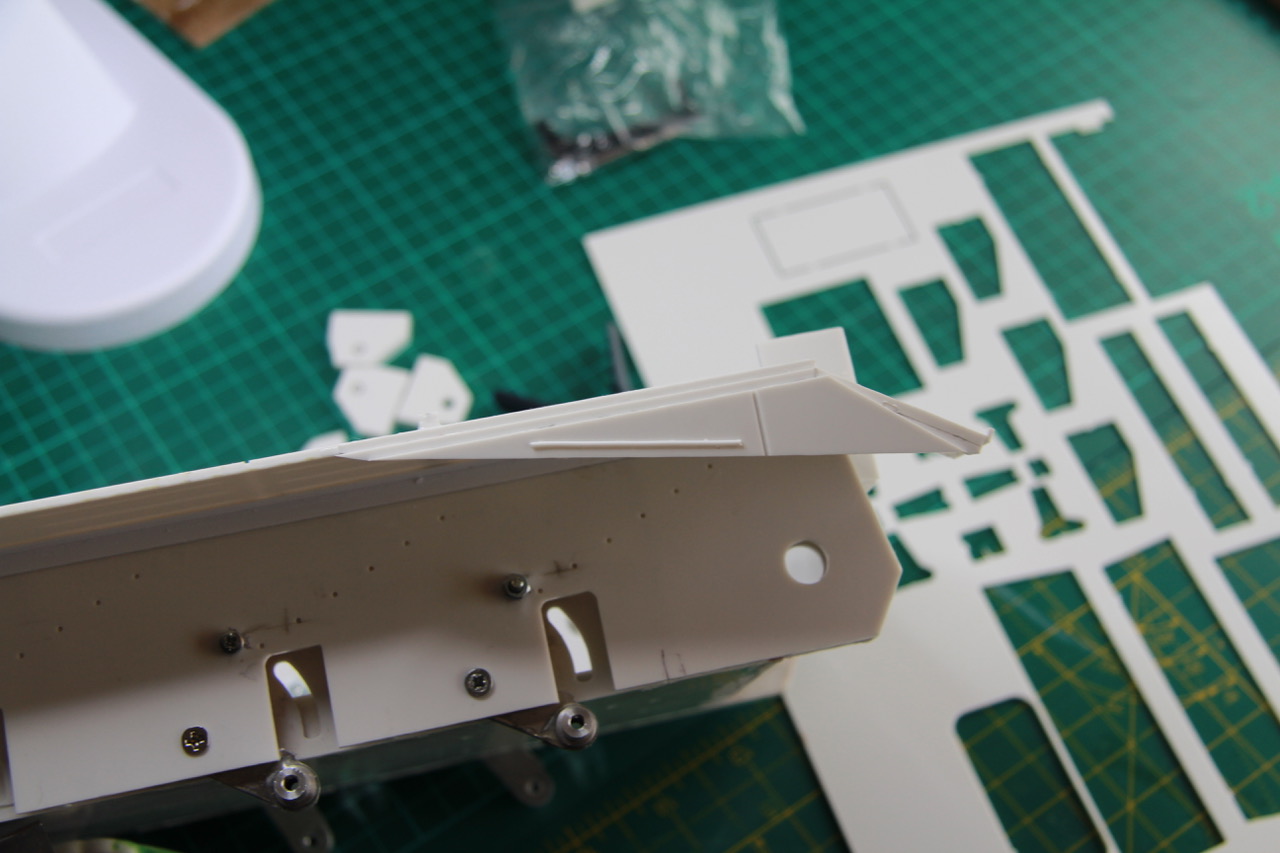

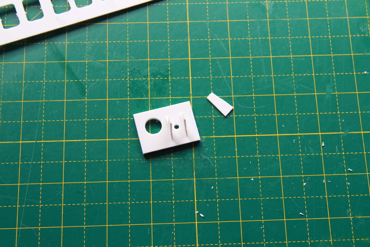

then bond the three backbone bits together:
Three struts bonded together

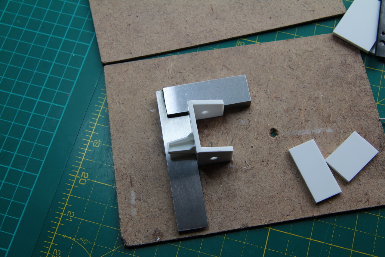

Mudguard support brackets

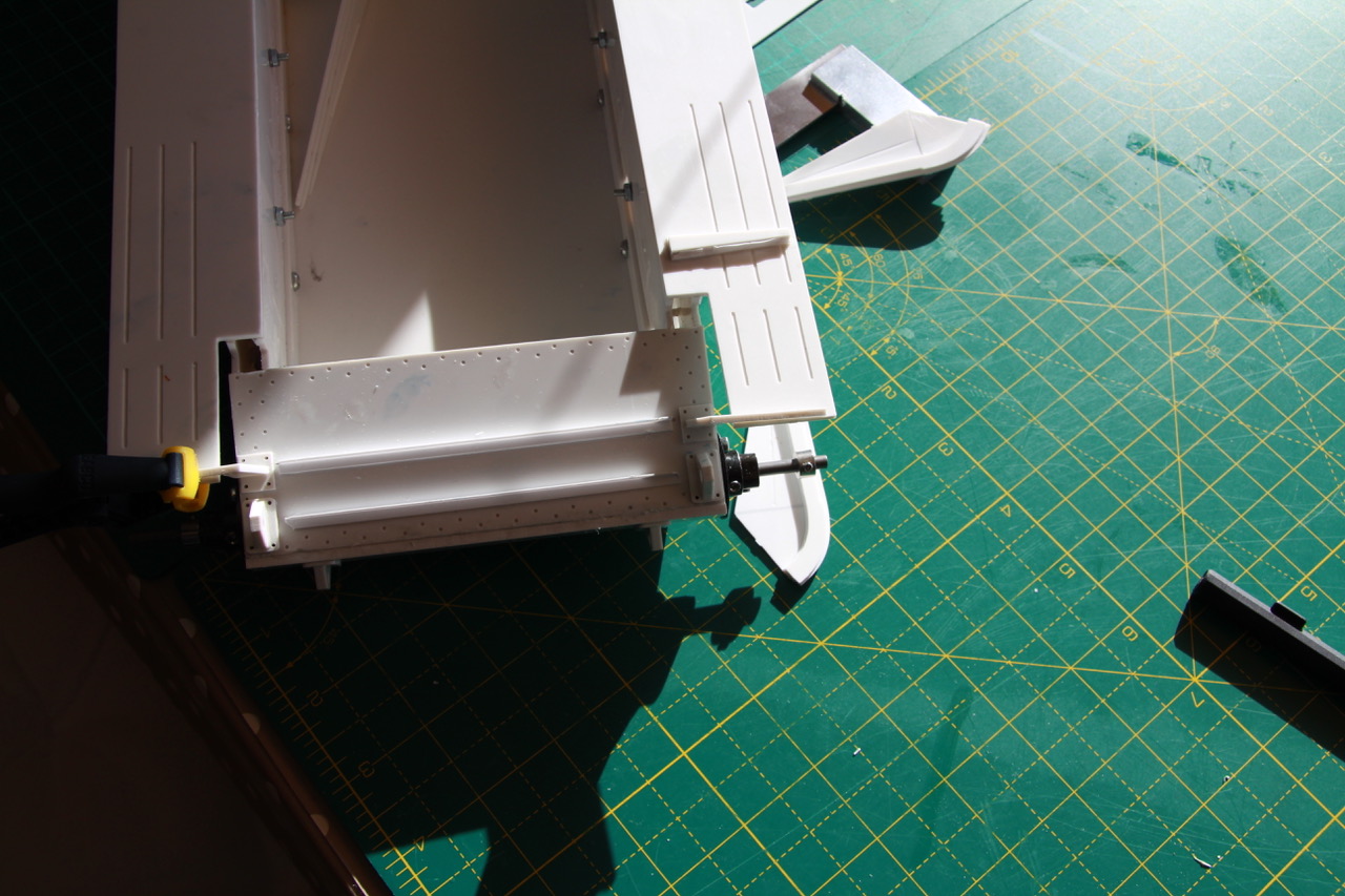

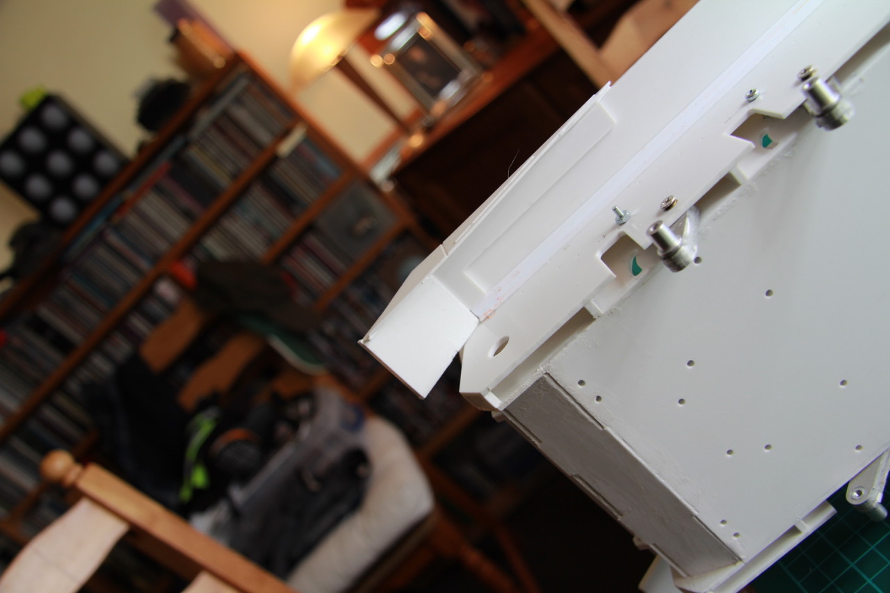

While they're drying, I fit the rear Mudguards..and add some 'L' shaped reinforcement made out of waste sprue.
Mudguard in place
Mudguard in place
Reinforcement underneath the joint, and along the main guard to hull panel:
The Ludwig kit doesn't make reference to bolstering the joint lines; but it seems to be a wise precaution to me. :think: I don't want the tank splitting up under the stress of going into action :lolno: :haha:
A little extra strength..

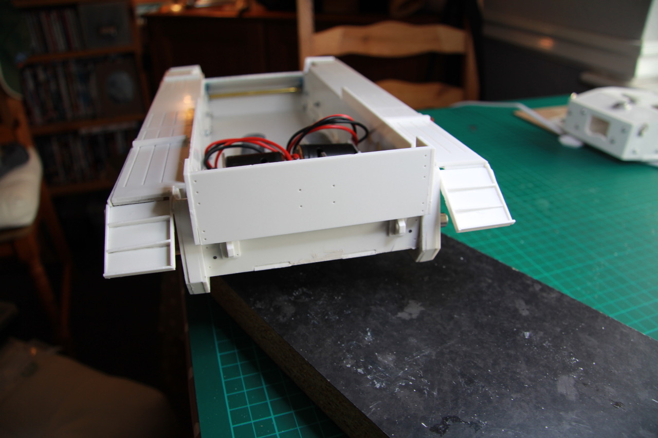

Finally I have the rear of the lower chassis pretty complete; apart from sanding, and more judicious filling (Mr Surfacer etc.) and sanding.
A recognisable rear booty..
