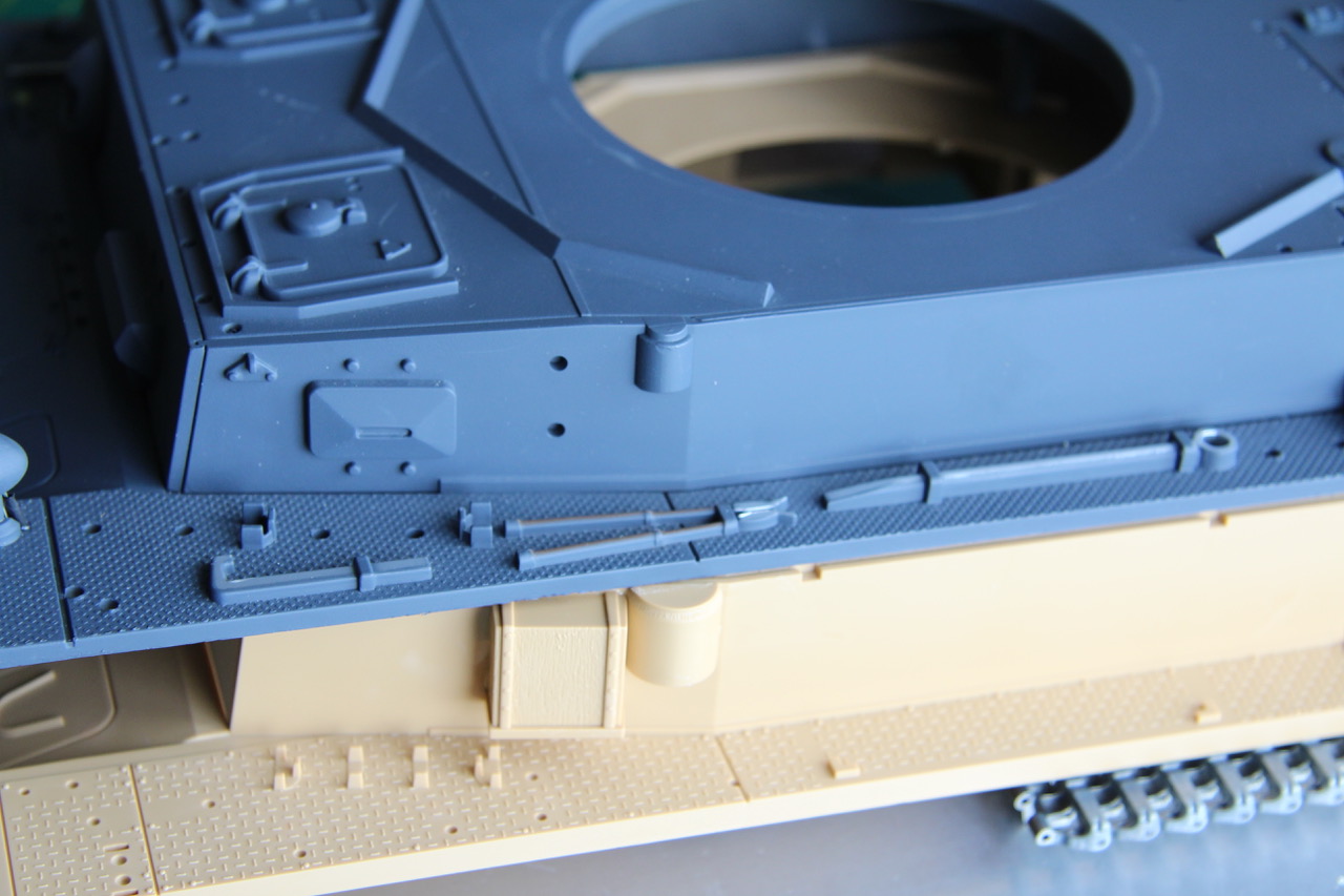

Thanks a lot B-Man for the shots of your tastefully kitted out Pz IV :thumbup: Is the zimmerit coating from Atak? I downloaded the Pz IV manual in pdf format, but saw no listing for zimmerit in the parts section. My King Tiger came with a zimmerit option, though,but I thought Tamiya hadn't produced one for the Pz IV. Anyway, nice job :D

Thanks for the kind words gents. The zimmerit was "lovingly hand crafted" with milliput rolled into thin sheets and then stamped with an old plastic levering tool from a smartphone opening kit that I sanded to shape. I researched long and hard to try and avoid doing it but from what I could see all panzers from that stage of the war would have had zimm applied so I had to bite the bullet if I wanted to keep it reasonably accurate. It wasn't that difficult to do but took a while due to the tool I was using. A roller or Atak kit would have sped things up but I'm happy with the result.
I'm not usually a Tamiya man but I was lucky to snag this one off eBay as a half built kit for a bargain and was very impressed by the quality overall. It was a nice kit to build (or finish building in my case). For the retail price of these kits though I would have thought things like working lights and opening hatches would have been standard. The lack of a zimm option for an Ausf J is disappointing and no side schutzen is a missed opportunity. That said it's a solid and reliable model, a fun build, and a great runner.

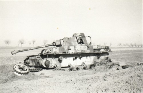

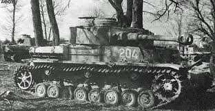

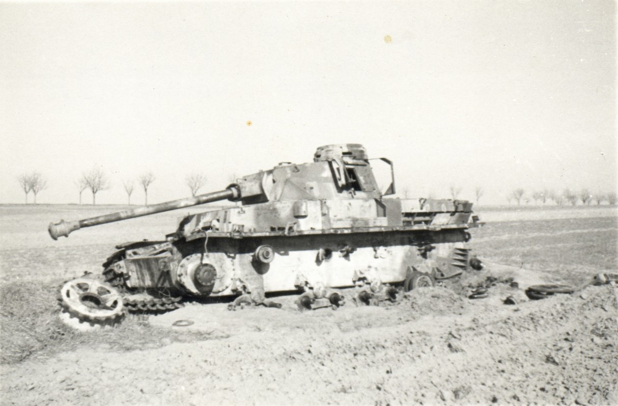

Suitably intrigued, I found a few pics of late model Ausf. J's with only three return rollers:
Roller challenged Panzer IV ausf J
Three roller Panzer
Three roller Panzer
PzIV  economy three roller version
Pz IV ausf J three roller version.jpg (13.8 KiB) Viewed 5592 times
Sooo...if you're short of return rollers, this is the version to build :thumbup: It also makes for a neater, less controversial line up :haha:

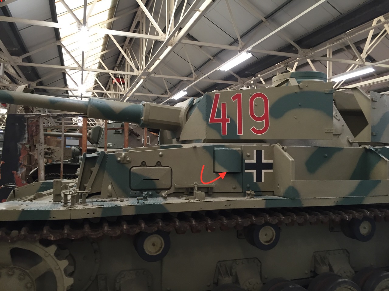

Casting a more critical eye over Pz IVs in 1/16 scale, I noticed this anomaly on the front left bulkhead of the Taigen/ Heng Long upper Hull. I really don't know what happens behind this slice of cylinder, or why the Panzer IV needed it, but it appears on every version, I think. Unfortunately, the embedded, moulded-in version on the Taigen Upper hull, seems to have shrunk drastically in the wash, so to speak. :eh: :eh: Maybe it's some sort of shielded vent.. :think:
Compare:
Tamiya-Taigen upper Hull- another detail difference
The Taigen/HL hull (top) represents the half cylindrical part (anyone know what it's for?) next to the wooden block, as the size of a tin of beans. The Tamiya hull (below) gets it right.
Here is is on the real thing, in a pic I took of Bovington's Pz IV mish mash (part indicated by red arrow..)
Panzer IV left front bulkhead detail
Tamiya's part comes off a sprue, so if you want to use it instead of the shrivelled moulded on Taigen part, then get your saw out, if you want your HL/Taigen hull to look more like a good model. and less like a toy... :shifty:
or..buy the Tamiya upper hull. :thumbup:
