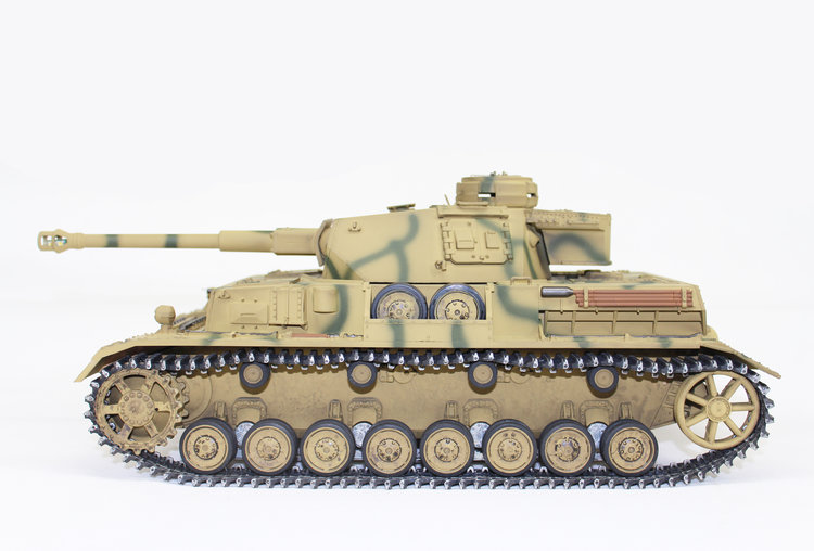

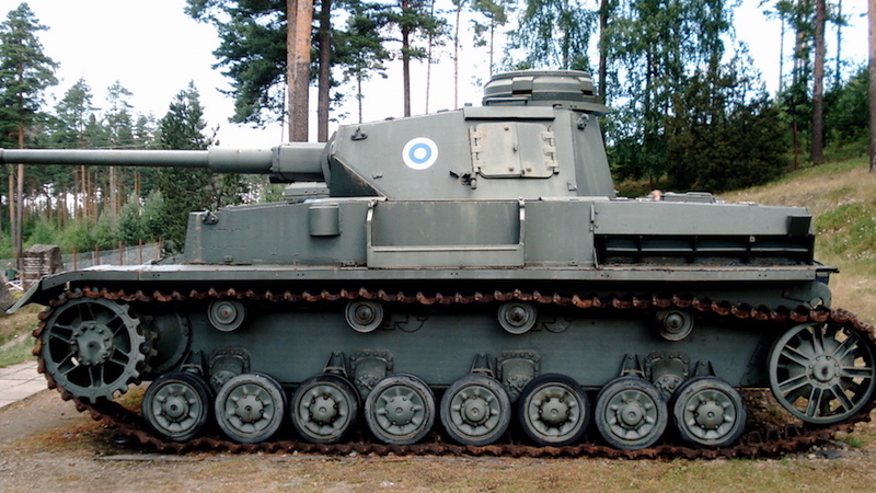

:clap: Nicely done, Arnie. I agree that the Asiatam has the most accurate representation of the front drive sprocket in terms of size and position. Compare the front sprocket on this Finnish Panzer IV ausf J. with the 'G' metal end from Taigen:
Finnish Panzer IV
Finnish Panzer IV
Taigen PzIV metal ed. ausf G
Taigen Panzer IV ausf G metal edn.jpg (78.86 KiB) Viewed 8649 times
The top of the drive sprocket should be in line with the tops of the first three return rollers, and not below them as on the Taigen.. :problem:
