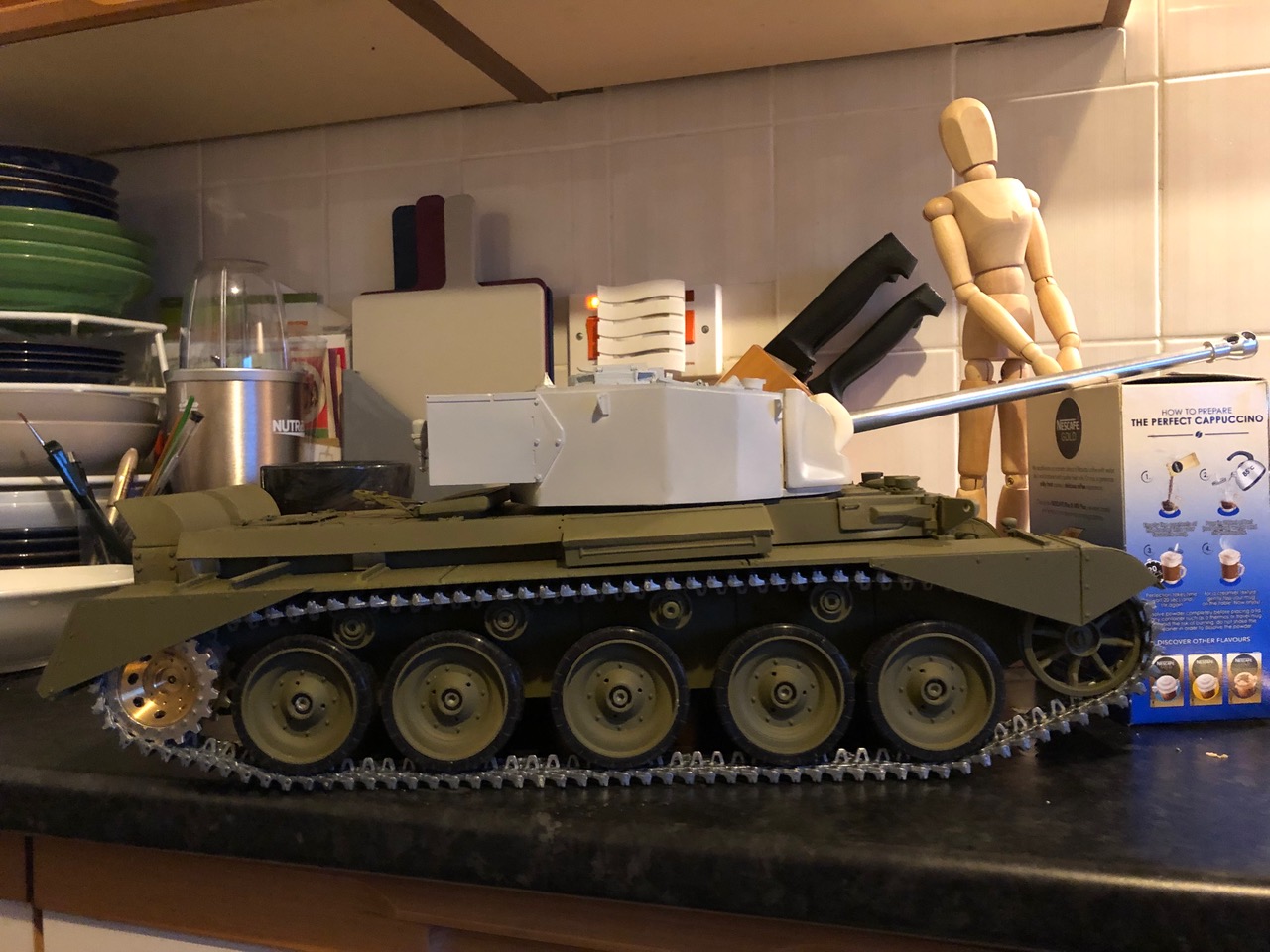

Having spent what seems like an eternity looking at the
Comet Turret, something began to dawn on me lately (yes, I
know life has other things to offer
), and it's that the front, sloping section of the roof
is too shallow on the Ludwig model.
Have a look at the angles involved here:
- Comet model-frontal slope of Turret roof

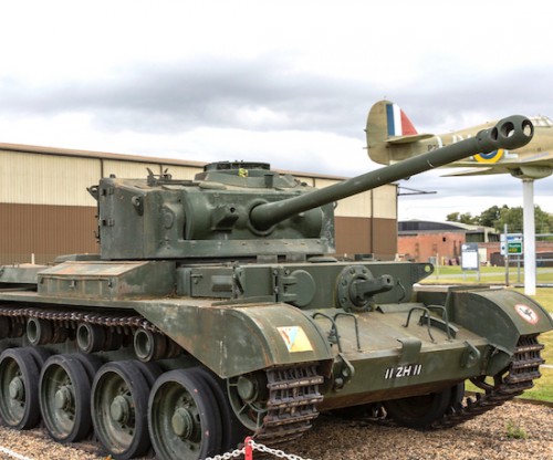

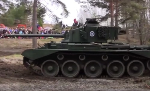

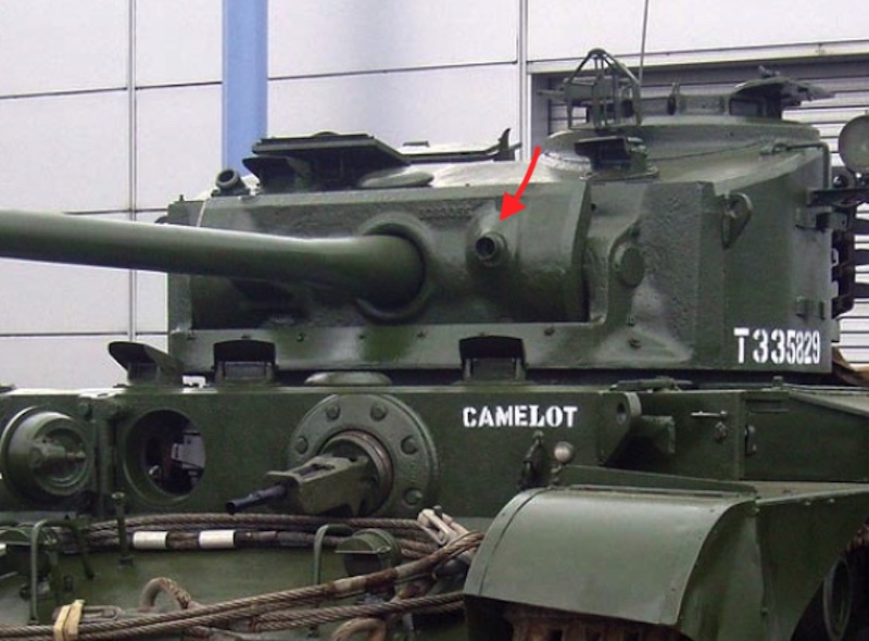

Compare it with these real turrets:
- Comet-Finnish comet- turret slope
- Comet-showing rake of roof front section

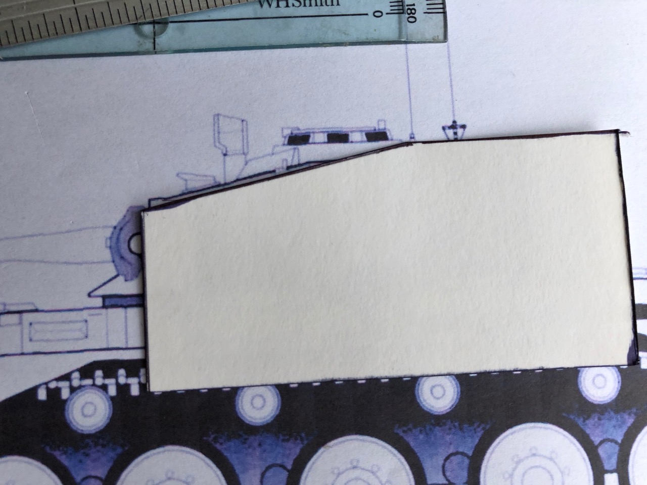

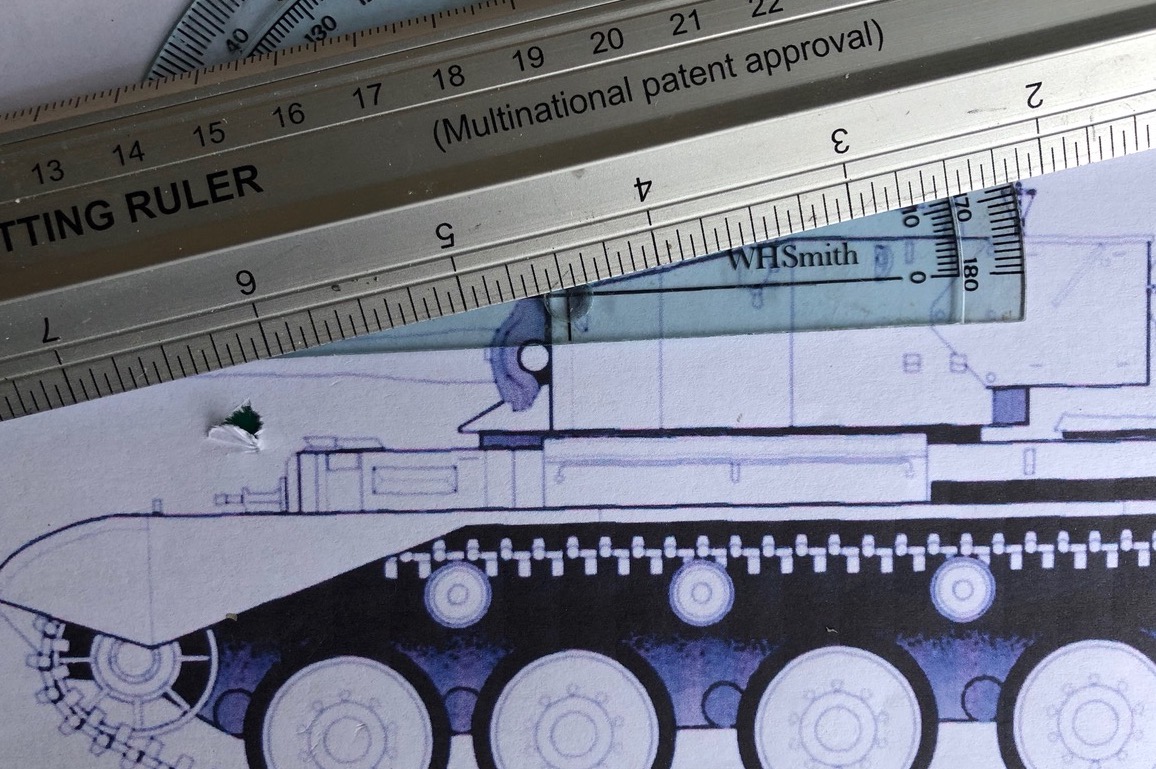

Then I compared these with the blueprint for the
Comet. I also used a semi-circular protractor to get an idea of the angles involved.
- Comet blueprint- inclination of frontal turret roof plate

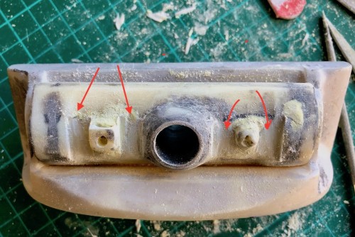

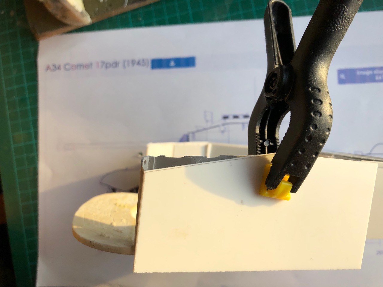

So...I made a template based on the slope angles apparent in the blueprints, and pics of actual Comets n my computer screen. Then, I set 'em against the model to see how much surgery might be needed:
- Comet-roof inclination
- Inclination that appears on the model
The model is short, in the slope department, by a few degress.
Och well, time to get the saw out. This perceived flaw will bug me forever, until i do something about it.

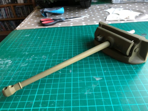

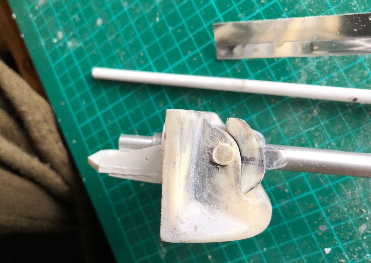

Oh, I forgot to mention, that early in the build, I bonded the front sloping section of roof in place. That was when I was still blindly following the build manual. I'd forgotten what a pain the Cromwell was, when installing a gun and Clark recoil with a section of the roof in place. Duhhh...
That required double-jointed fingers, and a magic trick, to insert the gun in that confined space..
Bits of the manual should be avoided, or read very carefully- and not in the order the instructions appear in. I should have remembered that. When I did, i managed to remove the front roof plate without damaging the turret. Just as well, eh?
