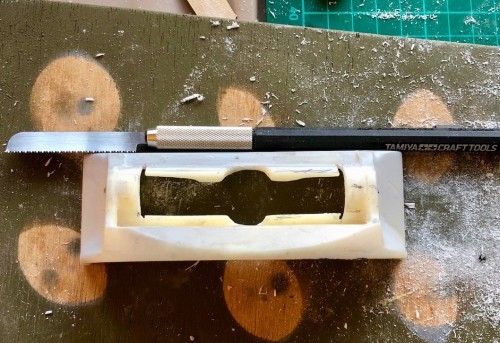

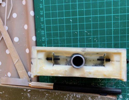

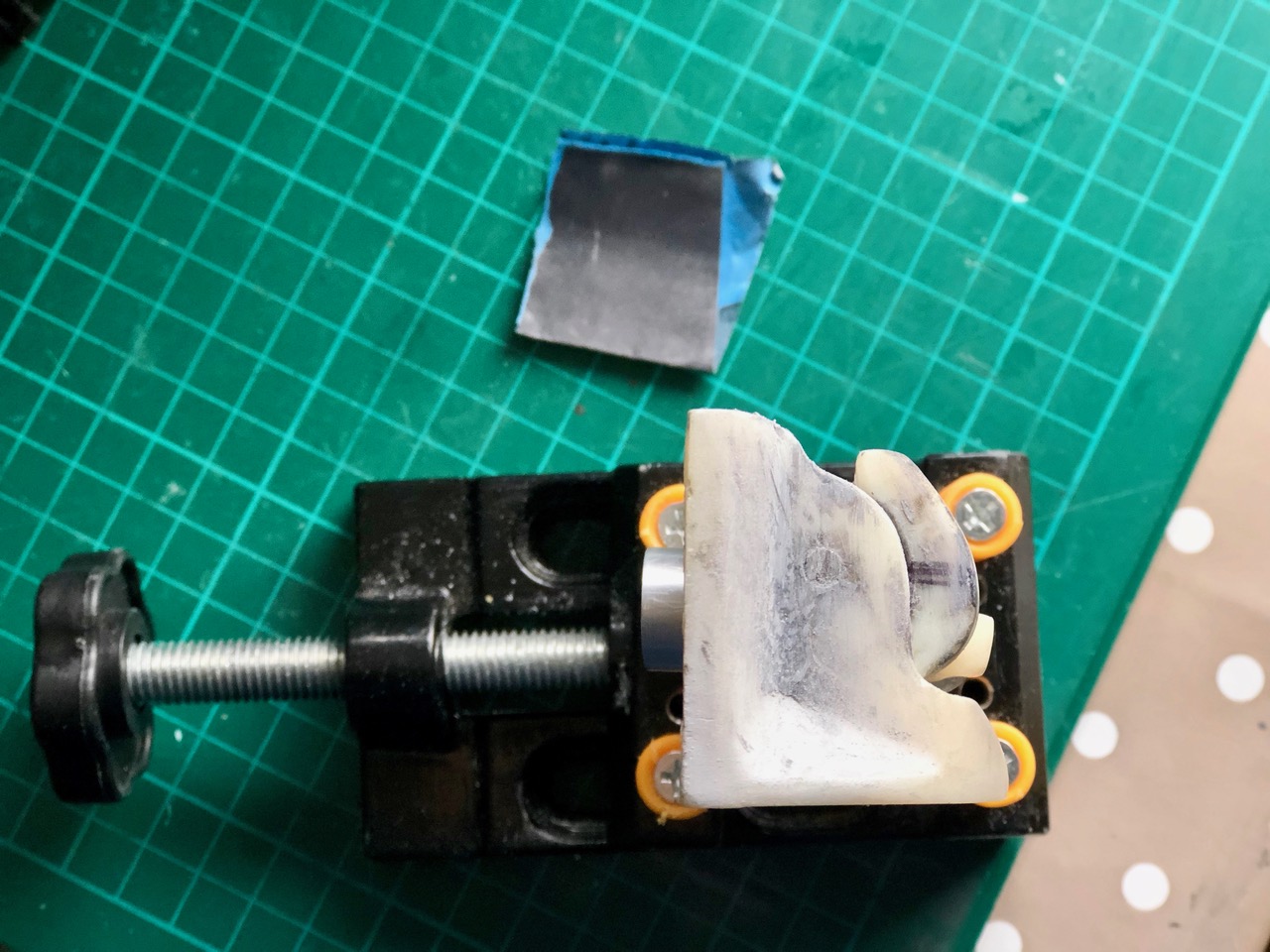

Well, I have the mountings, finally. The gun-holding mantlet now moves with ease
Phew...what a pain

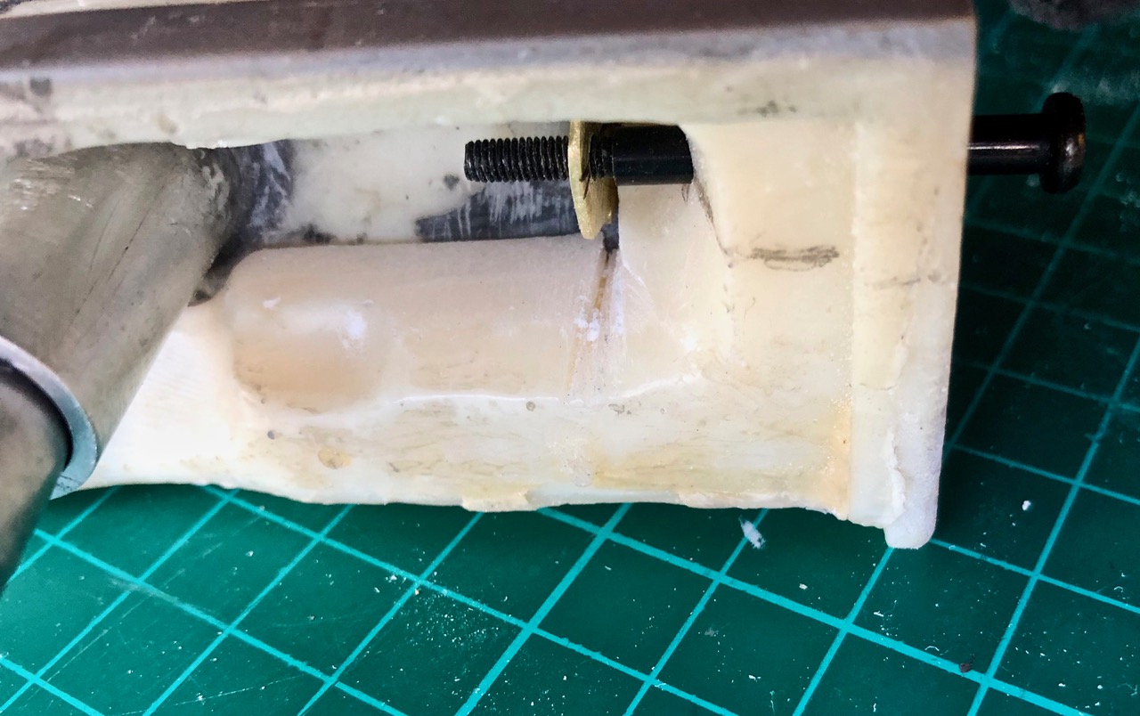

I'm using Mato Tiger 1 axles for the trunnion pivots/swivels. Finally, by using dividers, rulers, and No. 1 eyeball I located the optimum position for the pins in this setup.
...and with the Mato Tiger axles fitted ( but not bonded in yet)
I'm happy with the outcome so far.
Why? well:
1. The assembly is now more like the real deal, in principle, anyway,
2. It actually moves smoothly now, and should allow about the right amount of barrel elevation and depression.
Should being the operative word...
The mato axles will be shortened on the outside, to be flush with the mantlet surface. That's after being bonded in place with JB Weld metal epoxy.(Great stuff!!)
I could put bearings on the inboard shaft, an lock them in place with nyloc nuts. or, I may just use a nut and washer.
I'm happy with the outcome so far. 1. The assembly is now more like the real deal, in principle, anyway,
Overall, coming up with this solution has taken more time, and more patience than any other part of the project. But, semi-scratch building being what it is, it would surprise me one little bit (een lutte beten in Platt Deutsch)..if some other conundrum crops up to top this one for frustration.

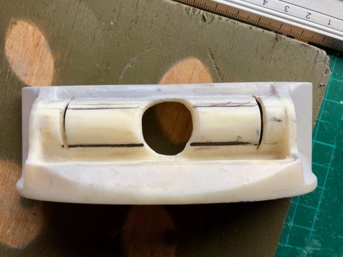

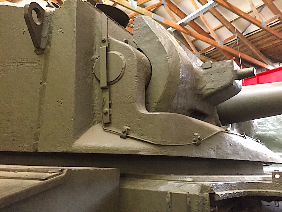

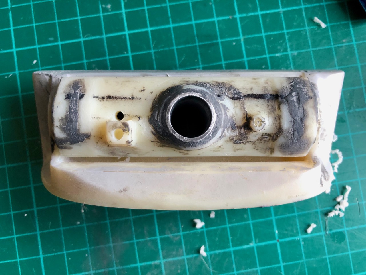

Going back to the suggestion, Tim, that the profile of the resin mantlet should be flatter, here are a couple of pics of the resin and real mantlets, in profile. Here's the resin one. Note how the MG should be up by the centre line of the barrel (if not slightly above it). I'm going to saw it off and reposition it.biertje wrote:Hi Roy
Spend some time on the PC with the WOT files and i think I'm quite close to the oritginal now.
I'll try printing a set this week for a test.
Also found out that the resin mantlet and the one in the bronco kit are way to pointy and should be more of a flat plate.
One other important ting to remember is that the comet was armed with a 77mm gun and not a 17pounder so it should also have a shorter barrel.
Keep up the good work and you wont need my help at all in the end![]()
Greetings Tim
Click on pics to ENLARGE them... Just to add a detail; the mantlet moves perfectly now, and should allow about the right amount of elevation.
The next stage, is to find some means of attaching a recoil, and elevation unit, to the barrel and barrel tube housing. That will take some though, but I may begin with Christian's flatpack solution.

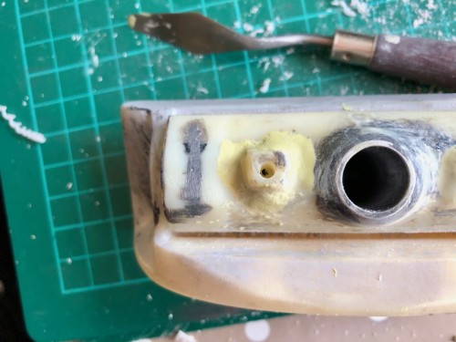

Right, well, getting the mantlet to elevate smoothly has boosted the old endorphins. Now, I think I can move the MG and optical sight without ruining the resin. I just have to cut them out, carefully, and replant them in the correct positions using Milliput. First, I'll drill the holes that will allow a light-emitting MG to be fitted, and maybe some ersatz lens for the optical gunsight.
As ever, click to ENLARGE the pics
When the Milliput base for the relocated MG, and optical sight, has cured, I'll sand the Mantlet to get form the most credible of contours. I may even bring the MG out a little further.
