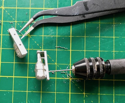

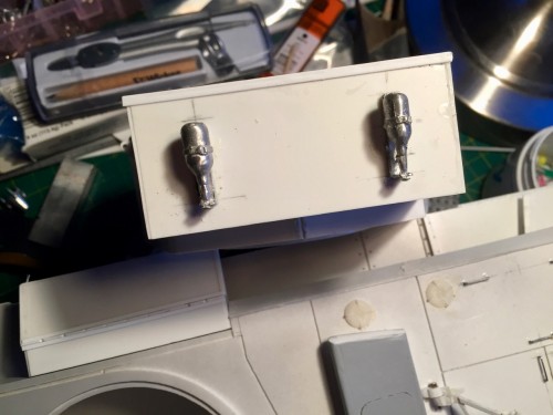

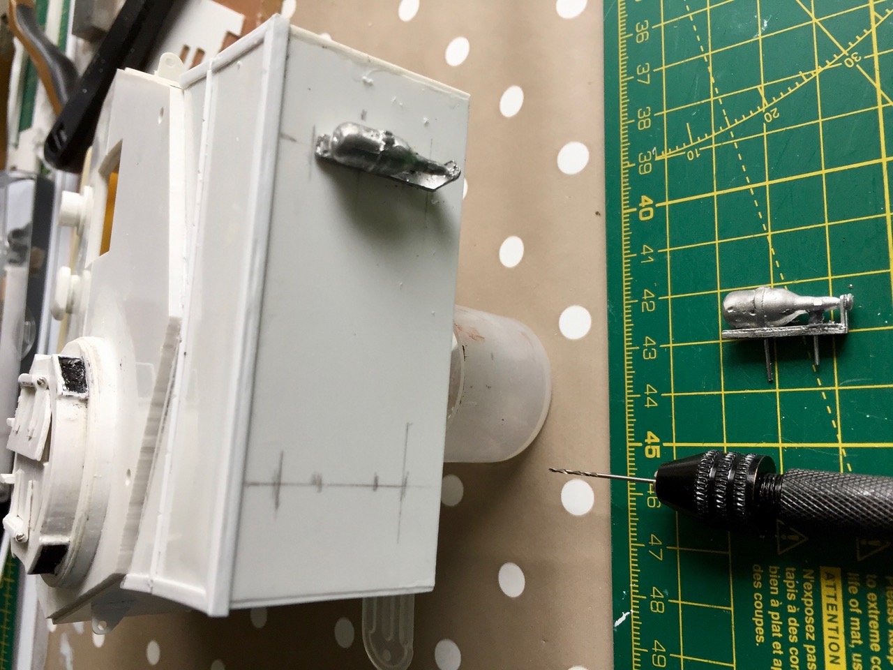

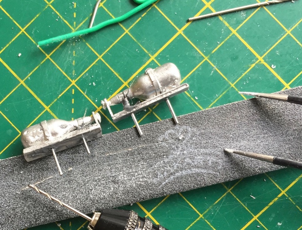

A little update. I have a brace of metal fire extinguishers to fit to the turret. As they're quite weighty, they need pins, as well as epoxy, to keep them securely in place.
A wee bit of drilling with my trusty pin vice. (Click to ENLARGE pics...) I chopped up some paper clips, and embedded them in the extinguishers with JB Weld (metal) Epoxy. I've found it works very well on alloys and white metals. The Brit pattern extinguishers came from Christian Ludwig, by the way.

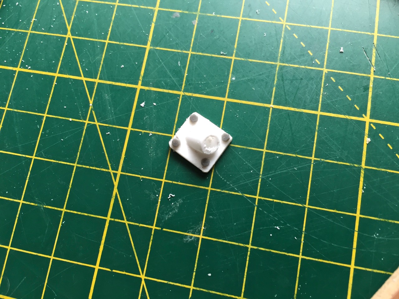

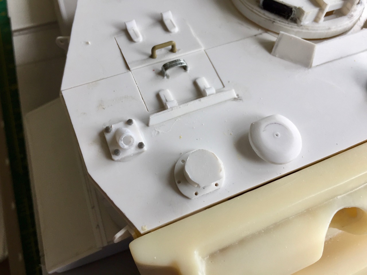

The Comet Turret also has a 2in Bomb Thrower No 1 unit near the Loader's hatch. The unit is based on the British 2 in mortar, but its range has been limited to 150 yrds, partly because of the short barrel. It was used for close defence situations, and for firing smoke shells.
You can see it highlighted in this pic: Then I added some Meng nuts to the base. meng nuts are resin based, I think, but I stuck them on with ordinary Revell Pro cement. They shouldn't stick, but they appear to. I didn't want to use superglue as it doesn't work that well with styrene, and mixing up 2-part Plastic Fusion epoxy seemed like overkill for four wee nuts. I'm just hoping they don't fall off. However, I did a test yesterday bonding a 2mm meng Nut to a piece of styrene sheet, just using Revell Contacta Pro and I couldn't prise it off. So... Fitted in situ, it looks like this (do bear in mind that all these parts will be cleaned up, prior to painting):
I'm, duplicating some of these pics, because they're apt to disappear after a while, if posted from Imgur... I've seen one or two threads lately (Estniche's Tiger 1 build, for example) where most of the pics have simply vanished into the ether.

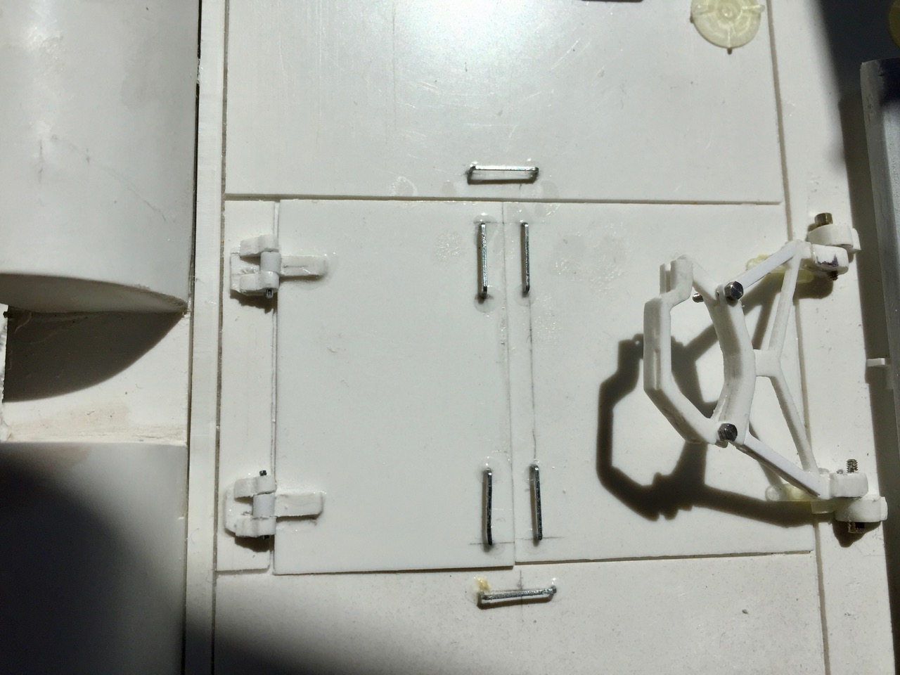

You'll also see I've added a defensive strap in front of the Loader's Hatch, and begun the process of making my own (openable) hinges from scratch, as there's no online source for WW2 Brit Tank hinges
German hinges-yes. Brit hinges -no.
Doll's house hinges just don't look right. Someday, I'll go back and correct the ones I fitted to my Cromwell.

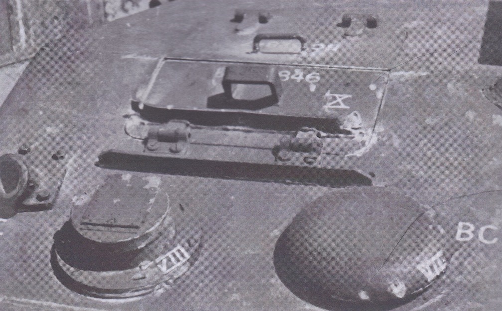

This illustration, posted earlier, shows the Loader's hatch fitted with two 'splash' defensive strips. The second one-straddling the hinge on the foremost hatch door, has bullet holes in it from field trials. On production models, I think this second strip was omitted. In any event, I've only fitted the frontal strip.

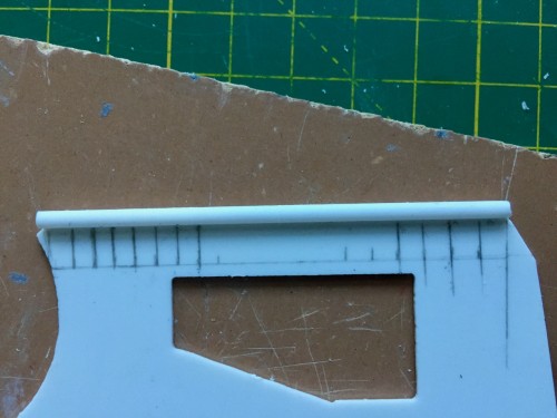

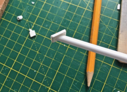

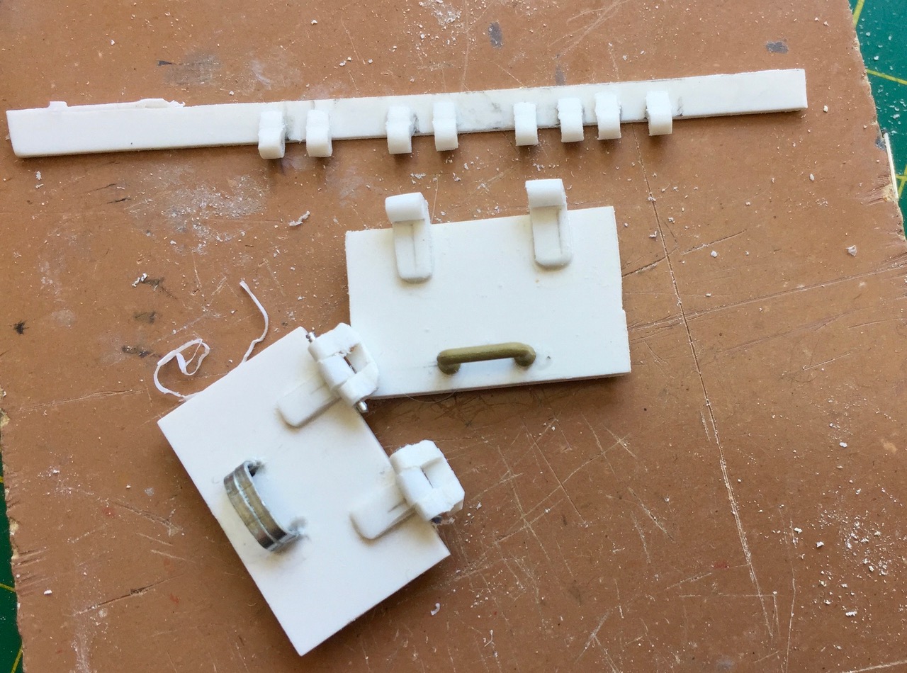

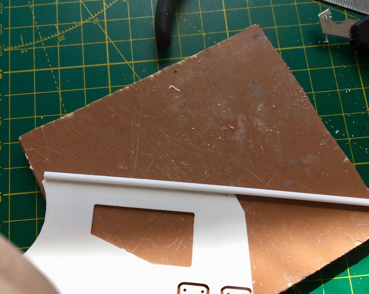

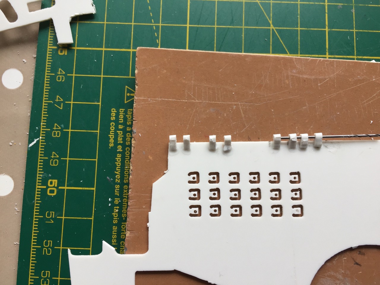

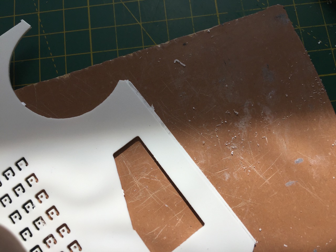

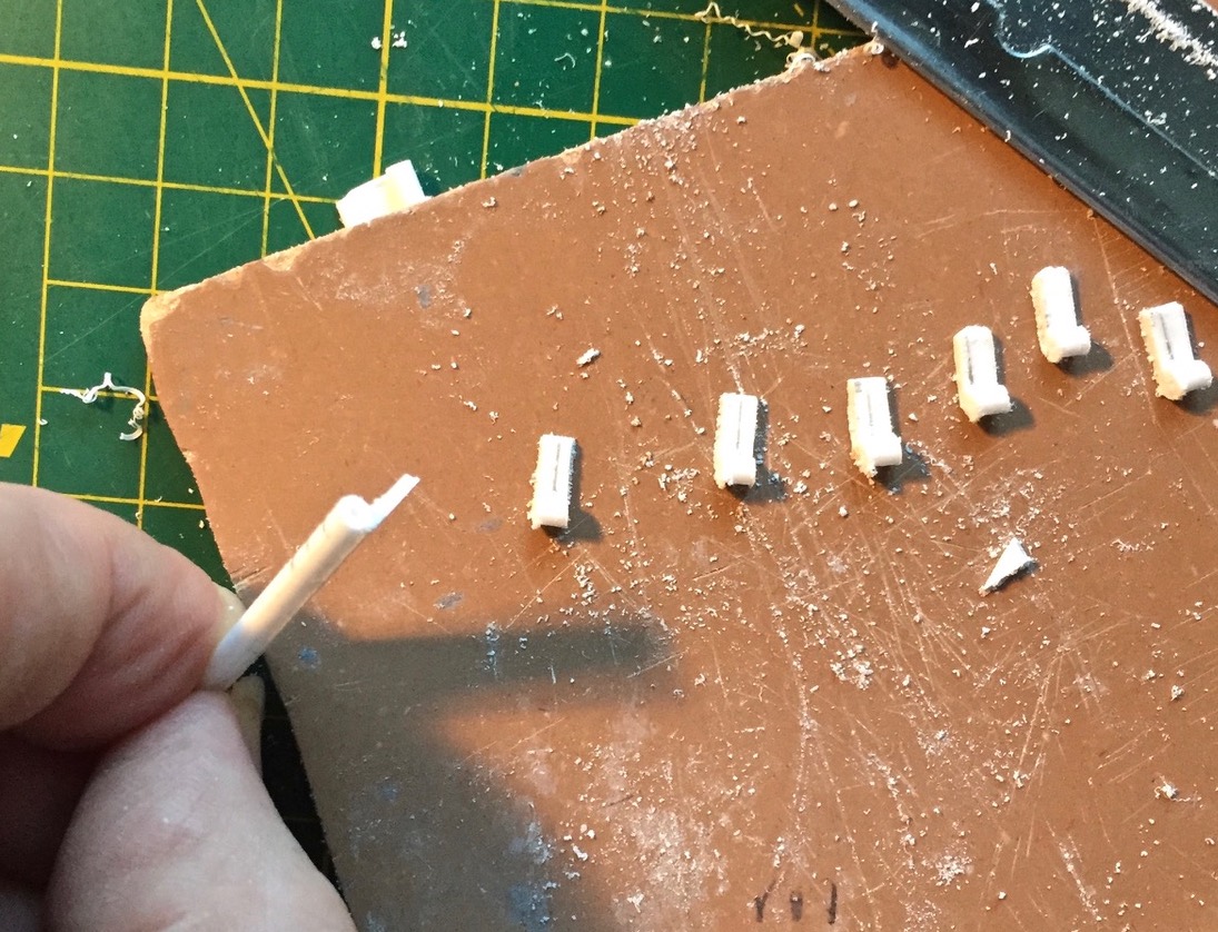

So, this is how I made some. I used blueprints as a rough guide to their dimensions and shapes. Even finding online pictures (especially desirable closeups) of turret, and engine deck, hinges is a frustrating process.
First, I picked some junked 1mm styrene, and scored an edge away, to increase the area needed to bond tube to. The tube in question has an O.D. of 2.5mm, and an I.D (Inside diameter) of 1mm Then I bonded the tube to it: ..and then marked out some rough divisions. I need six hinges altogether. That's four for the Loader's Hatch, and two for the Engine Deck hatch.
Looking online, it's possible to find usable hinges for WW2 German tanks, at Shapeways, Asiatam and elsewhere. Sadly, but unsurprisingly, this isn't the case with WW2 British armour- at least not in 1/16 scale, anyway.

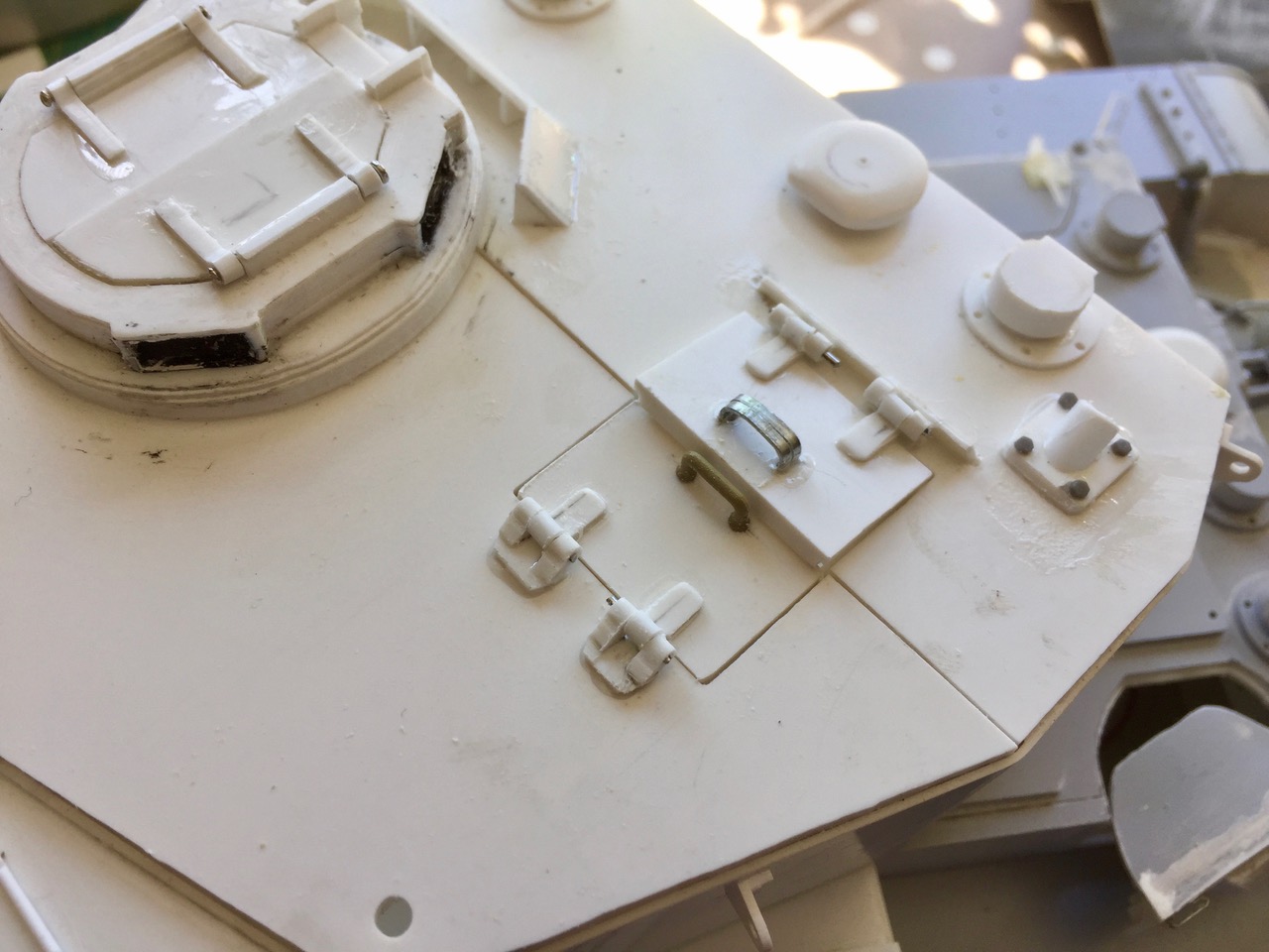

and hinges fitted to Engine deck hatch. Ultimately, this will mean that the Commander's and Loader's hatches will be openable. The storage bins and the engine deck hatch will also open.
