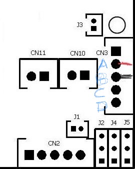

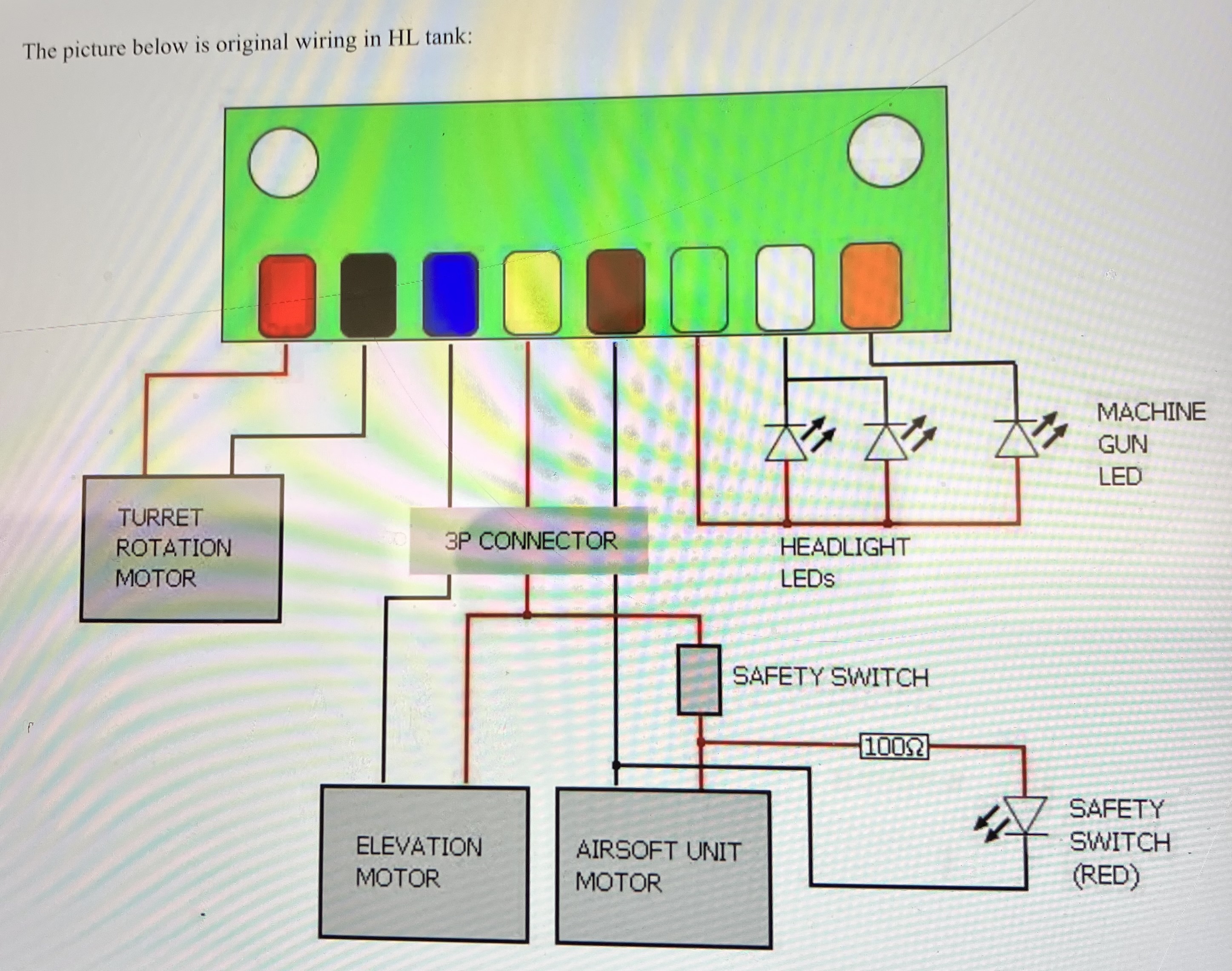

On CN 3, A and B led flash, C and D switch flash control. Parr against with servo for reversing? I don't remember if necessary? or if the board that manages it? for information, attached Heng Long type electrical diagram, sometimes can help?

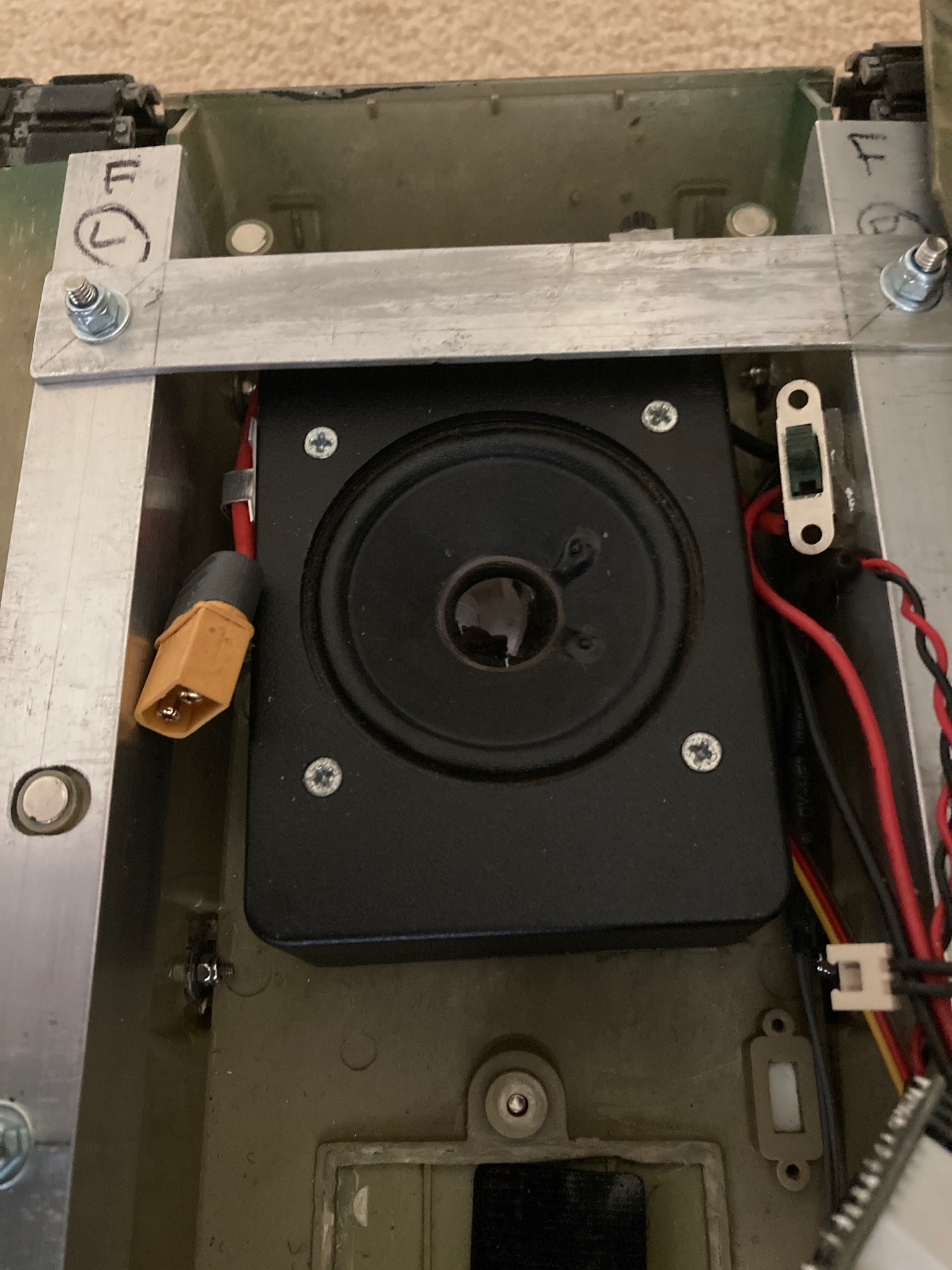

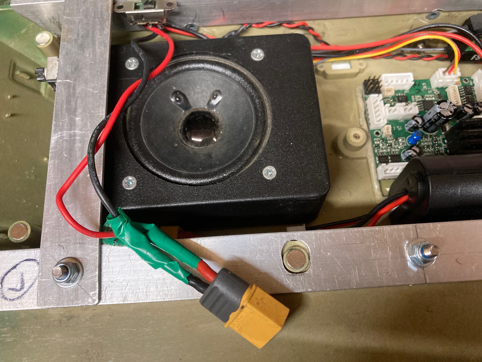

Used Challenger Strip and Rebuild.Tidy the Wires.
While I am waiting for a spring conversion for the FS-i6 to arrive in the post I think I will tidy up the wires.
The motor wires are longer than they need to be and are currently bundled together under the front motor cross brace so they can be shortened the next time the gearboxes come out for a service.
I also need to fit a slightly longer wire from the on/off switch to the XT60 plug to give a tidier connection to the LiPo.
Some new 16swg silicone wire has replaced the jointed piece from the on/off switch to the XT60.
I used the old plug because I don’t have any with the little “pull” tab on it, and I think it is a nice idea, so I will get some on order so I can update my LiPo batteries as well to make them easier to pull apart (with arthritic hands) when they get a bit tight.
My usual source of good quality XT plugs has (in recent years) always been Hobbyking - but when checking today to order some, I see that they no longer have any listed on their site, so I have had to buy some from AliExpress instead.
- Much neater routing - and no joints.
- BAEB944A-43DF-4713-9293-0E0B807BE9DC.jpeg (654.04 KiB) Viewed 1087 times
- Not a pretty site previously.
- 2C8DB3AA-9BF4-4EEF-A7F9-93C8CD8EC39C.jpeg (712.3 KiB) Viewed 1118 times

to have the rotation as you wish? Have you tried inverting the channels on the RX? hence my remark about using servos to identify who is doing what? on mine, I have rotation on the left horizontal handle and front/rear on the left vertical, and the right in neutral, on the other hand recalls to the automatic center, I think that we should not trust the order of the channels in relation to the plate? Personally for a function, I had to invert the 2 on Ch3 and 3 on Ch2. Personally for the soldering, I would recommend the "Thermo Sheath" which is nicer than the green tape (personal opinion
