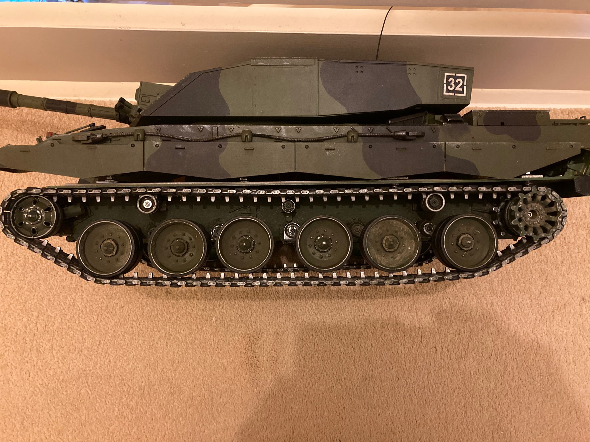

Used Challenger Strip and Rebuild. TRACK TENSION
Post by zooma »
The earlier picture of my used Challenger 2 showed that the tracks were quite loose and sagged onto the return rollers, so I intended adjusting them before running them once I got the tank back together again.
After re-fitting the same tracks (with no adjustment) they no longer sag.
The only difference is that I have fitted the angle alloy chassis brace and this has stopped the moulded chassis bending under the weight of carrying the heavy metal tracks and driving gears.
Without chassis frame.
With chassis frame fitted.
