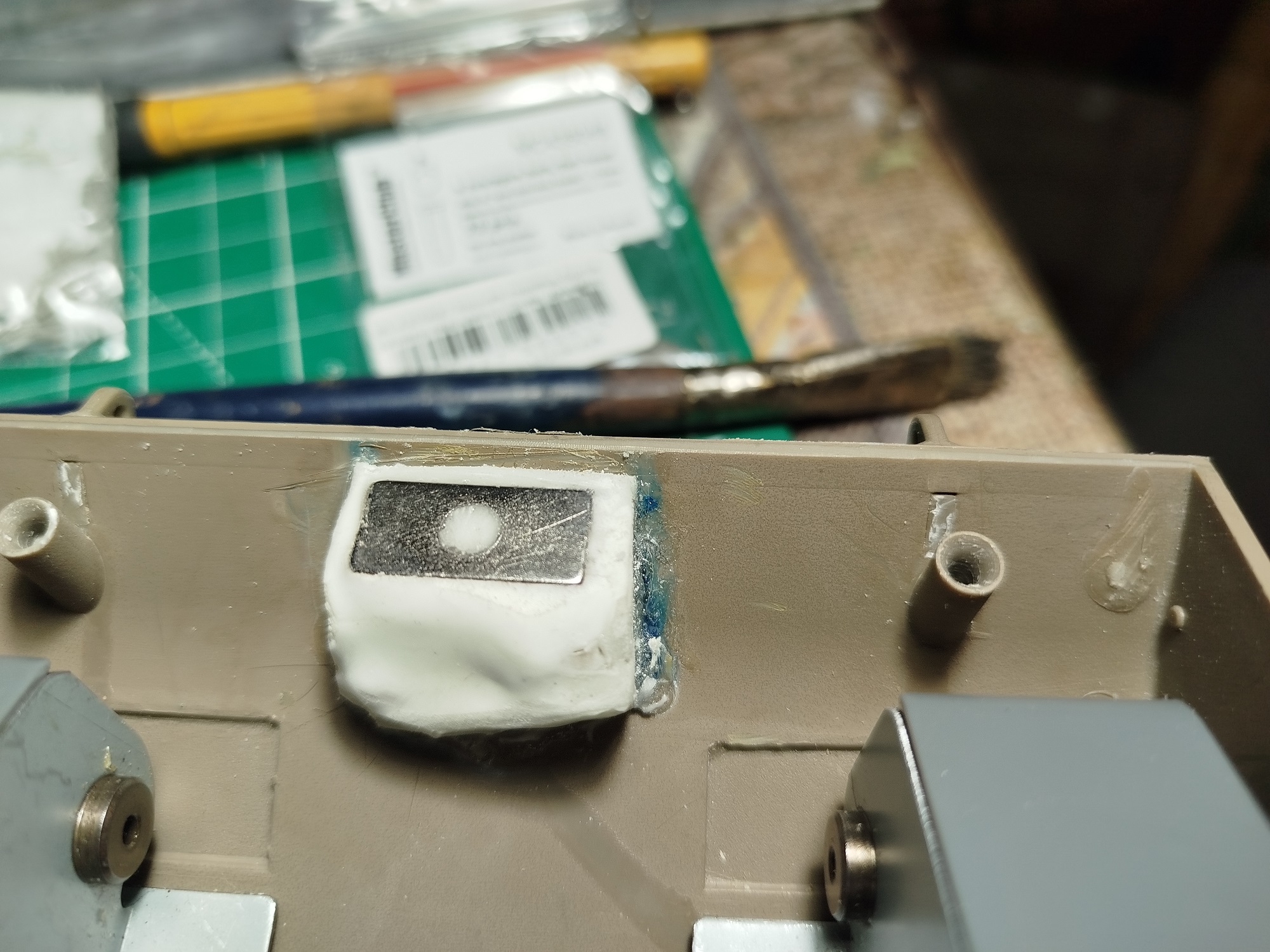

These are not carbon tubes, but regular 2.5 mm screws, so that they fit into the holes in the bottom without any obstacles, I made a conical seat and they fit in there easily.
When gluing the magnet, the formwork burst, sorry for the crookedness....

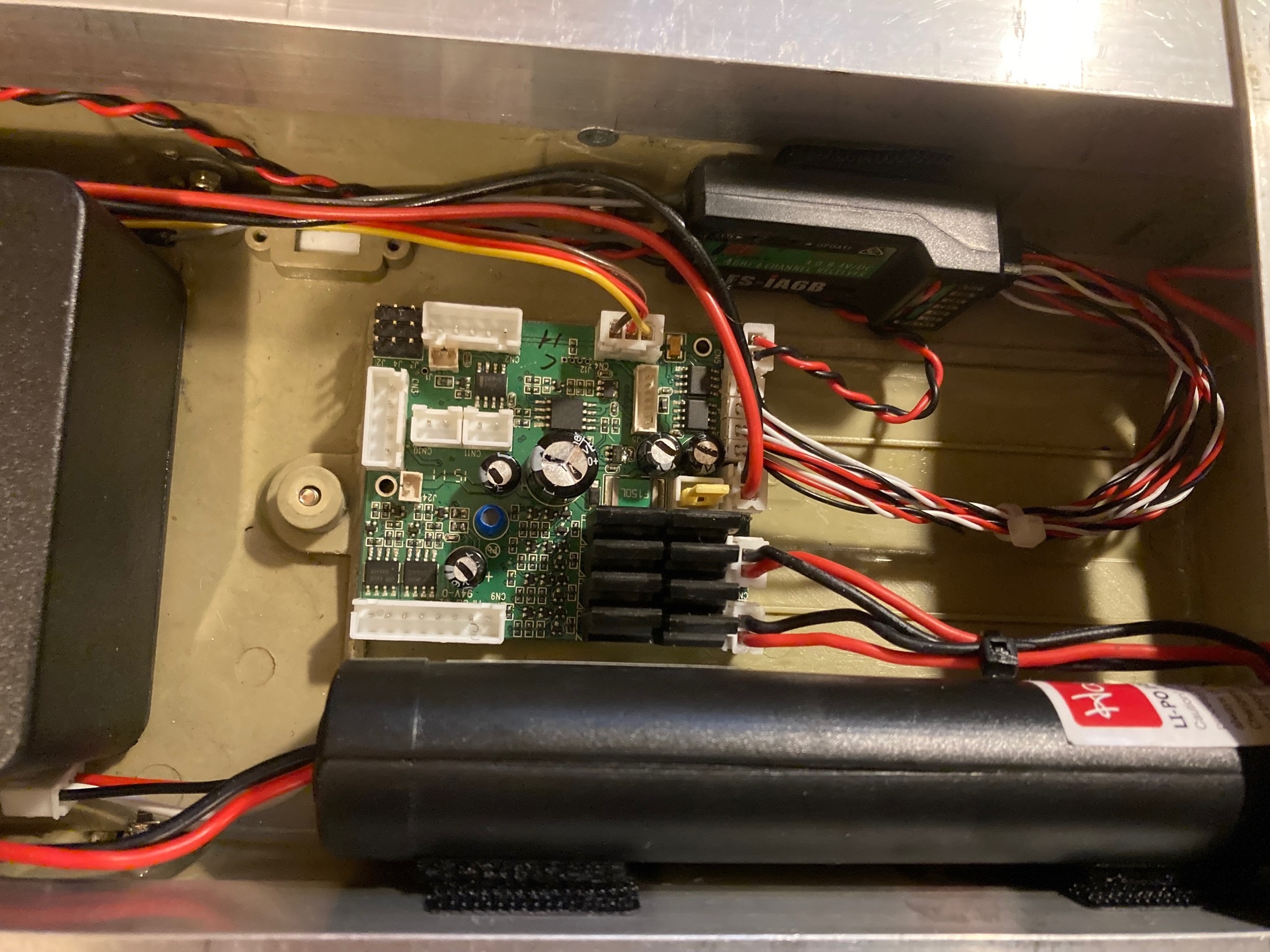

I have fitted the FS-1A6B receiver and the TK24 board into the hull.
The receiver and the LiPo battery have been attached onto either side of the hull with Velcro.
Motors are plugged into the TK24 as well as the power supply (with an on/off switch) and the volume control,
I re-wired the XT60 plug with a fresh pair of 16 SWG wires and soldered them onto the on/off switch so everything I need to drive the tank is now in place and connected.
At this stage the hull top and turret are not connected as I don't know how to access the various functions from the left hand stick yet.

Used Challenger Strip and Rebuild. Power-up!
The battery was connected and the TX was switched-on followed by switching on the tank.
The FS-16 radio and the TK24 board are both unknown to me, and I have no instructions for either so I am fumbling about to see what does what.
The RX switched-on OK, but the right hand stick did nothing.
When twiddling with the left hand stick the motor sound, main gun and two different machine gun sounds were discovered ...and the drive to the motors was gained (but I dont know how!).
Moving the RH stick showed that the motors were turning in the wrong direction, so I pulled up the TX menu and selected "set-up" followed by "servo reverse" and after some experimentation I found that channel 2 was the one that operated the motors so I reversed it and now both motors run in the correct direction so I will be able to drive the tank when the tracks are fitted
Before I connect the hull and turret I need to find out how to use the left hand stick to switch on/off the various functions, and how to turn the turret and raise and lower the gun without unintentionally switching everything else on and off !
I will see if I can find any information about how the TK24 board works online - but anyone reading this that can advise how they operate their TK24 left hand stick would be welcomed to share this information as practical experience is always better than an online tutorial..........although that is what I am hoping to find now!
