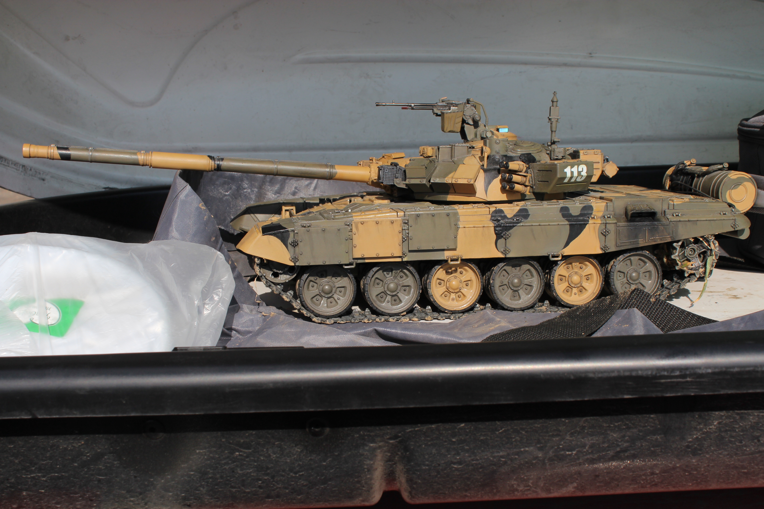

I didn't drive on parquet...
the entire chassis is metal
- IMG_6340.JPG (1.67 MiB) Viewed 961 times

The caption to your picture (of a T90 !) says "the entire chassis is metal".
For somebody that has argued against chassis reinforcement - an entire metal chassis is an expensive (but very nice) over-kill Pavel. Have you fitted an alloy chassis to your Challenger 2 as well?
By comparison, fabricating a chassis reinforcement from angle alloy is a simple construction that anyone can achieve at very little cost that does not take much time or need any special tools to make or fit.
The simple frame that I have bashed together can be ADJUSTED (or removed) quite easily to give more or less flex or twist by making simple (cost free) changes to its rigidity.
If I can get the amount of chassis control (that I think I need) from a frame made out of scrap angle alloy (like mine has been), I will be very happy as it would be something that I can replicate on any tank at any time for almost zero cost.
The well used KISS (Keep It Simple Stupid) phrase sprung to mind as I started to write this as chassis control can be added to a model tank very simply and for very little cost.

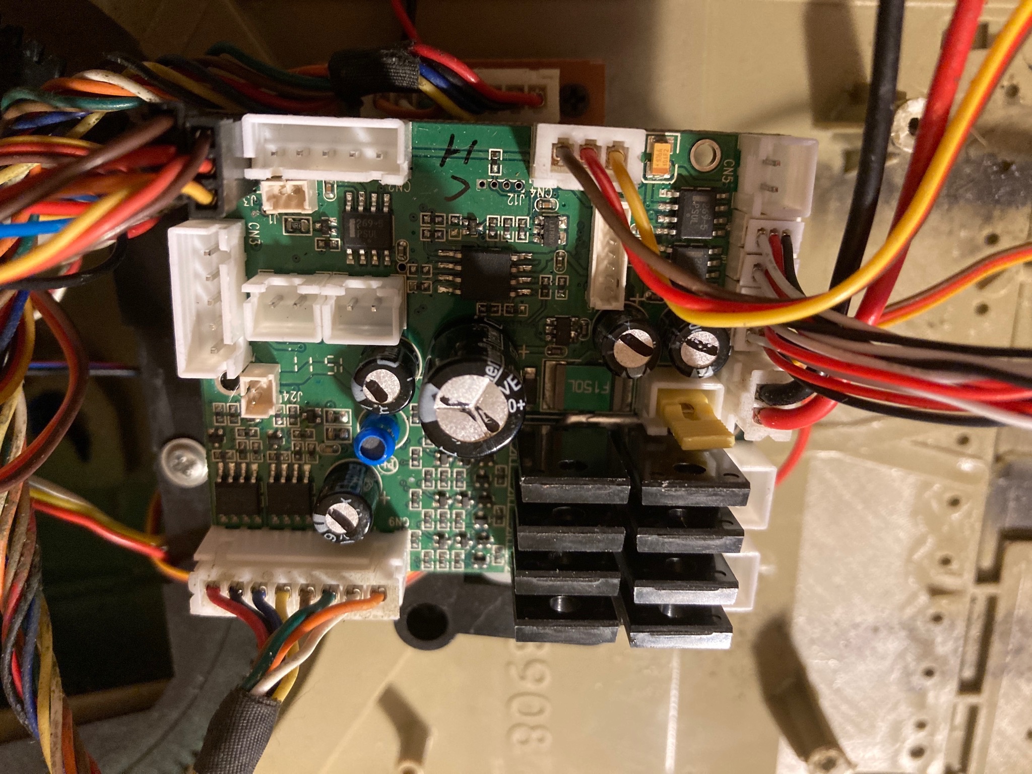

Used Challenger Strip and Rebuild. Refit the Electrics!
The electrics will be placed into the hull and tested next as I did not get on very well with it when I first acquired this well used Challenger 2.
The circuit board that came with the tank is a TK24 -CH that does not have an S.bus connection and I had trouble "calling-up" the various functions when I wanted to use them.
All the functions worked OK and the board produced an really excellent Challenger 2 engine sound, but finding where to find any of them on the HiTec 6 channel transmitter was not easy and could not be replicated the next time that I tried to repeat the process.
The right hand stick unit worked well every time to drive and turn the tank, but the left hand stick seemed to suffer from overload as every other function had to be found on it.

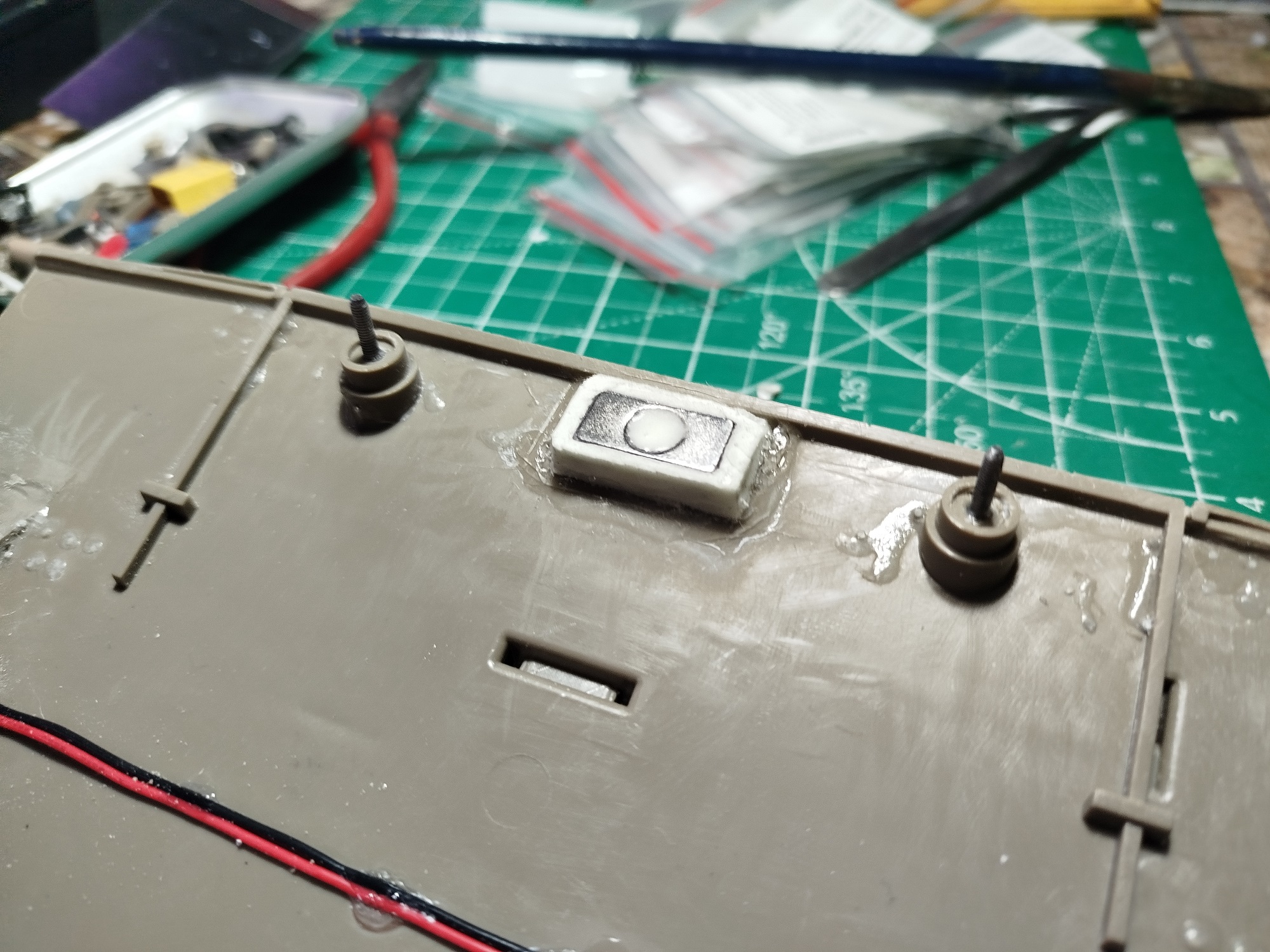

Re: Used Challenger Strip and Rebuild.
No, dear colleague, I have not reinforced any chassis!
Once, having bought into the admonition of colleagues, I bought a homemade chassis for the T-72 made of 2 mm steel, which needed to be covered with cut panels from a plastic chassis.
I did not engage in this stupid activity, and the hull is lying in my attic, no one wants to take it from me even for free....
Everyone checks the torsional strength of only the lower part, but once you install the upper part and try to twist it together, you will understand that this is not realistic.
If you say that magnets will not create strength, then look at how I did it...
And you are unlikely to be able to move the hull even a hundredth of an inch...
The caption to your picture (of a T90 !) says "the entire chassis is metal" - that's what threw me - I thought you really had a tank where "the entire chassis is metal"......Pavel wrote: ↑Sun Feb 02, 2025 11:11 am No, dear colleague, I have not reinforced any chassis!
What I do like is your alternative method of controlling the chassis movement with a combination of large high strength magnets and carbon fibre location pins that look like they are positioned to engage in the original screw hole turrets. Nice idea.
I can see how the locating pins can be inserted into the existing screw hole sockets to give a good positive alignment, and (with good strong magnets) this would help replace the rigidity that is lost when the tank is being run without the original screw fixings.
When these original screw fastenings are replaced with magnets alone, most of the original chassis control is lost as the magnets allow some "movement" that the screws would have been more likely to arrest.
What you have achieved is to return the tank to its original monococque construction where the top half of the tank (deck) provides an integral support to the lower chassis so that it can control chassis flex naturally - whilst retaining the benefits of a quickly removable top to give easy access inside the tank.
As I said - that is a nice idea.
I would like to try your idea on my next "long chassis" tank project as I think it will work quite well - but its effectiveness does rely on the upper hull moulding being nice and solid and not having any flex in I
As I have another Challenger 2 "on the stocks", I can build it to include your chassis fixing ideas - not just another long chassis tank - but one that is exactly the same as the one that I am currently working on here with an alloy frame to control the chassis flex.
