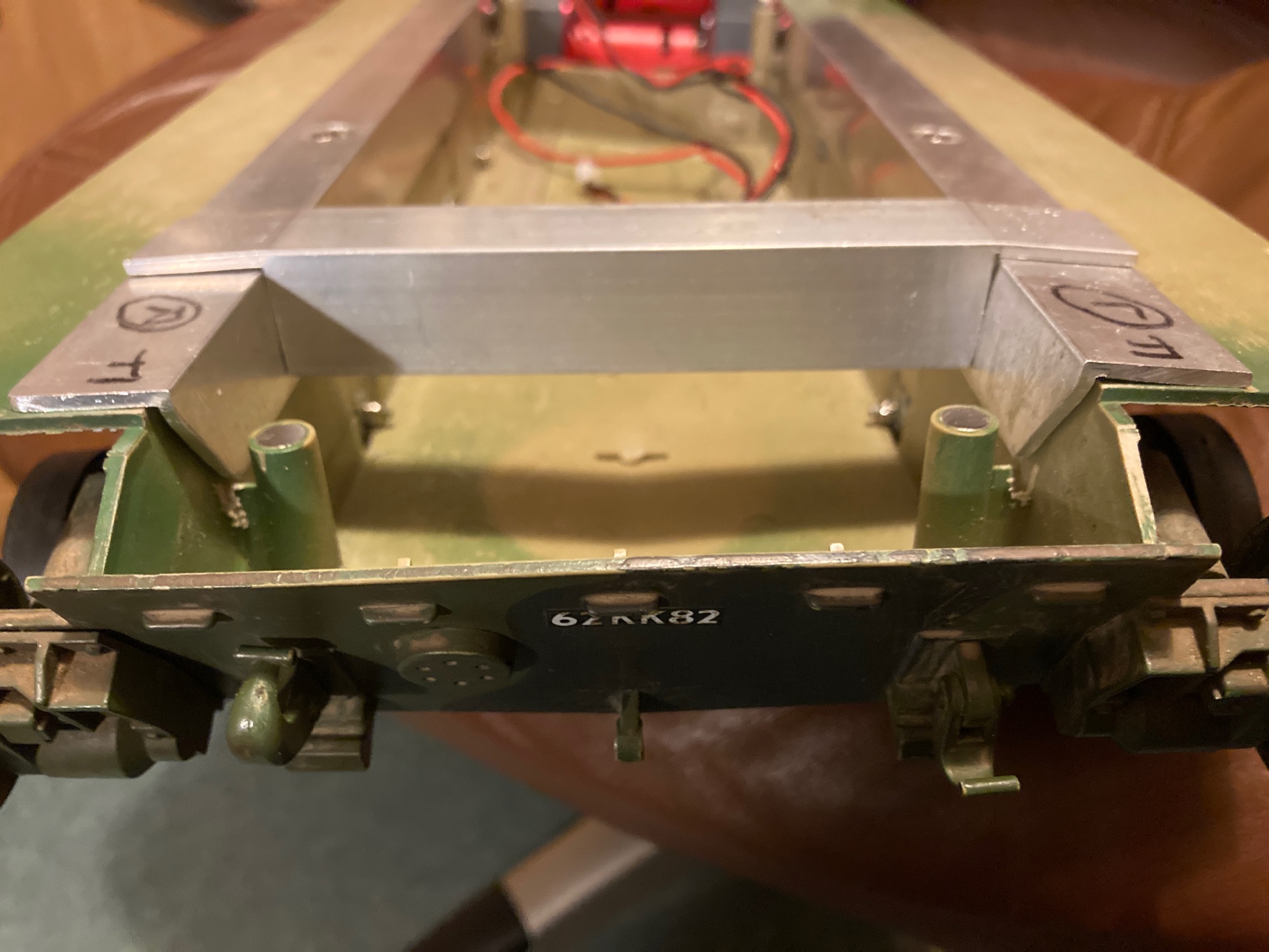

Used Challenger Strip and Rebuild. Making the Angle Alloy Frame Fit
Once the angle alloy is cut to length and small adjustments are made to it and the moulded hull to allow it to "sit" nicely, it becomes obvious that the hull sides are not at 90 degrees to it's flat tops - but the angle alloy has a 90 degree angle that cannot be easily adjusted to match the angle of the hull sides.
The angle alloy needs to fit flat on the top of the hull and inserts (tongues) of the cross pieces need to be made to touch, but not push the side rails outwards.
When cutting the two alloy cross pieces, I had to experiment with the shape of the "tongue" part that fits down in-between the side rails. Once the angle had been determined to allow the top for the angle alloy to sit flat on the top of the hull without distorting the hulls original moulded shape it was copied to make a pair of them.
The fit of these cross pieces was checked by allowing them to "drop fit" between the side rails without pushing the moulded hull outwards. Once this was achieved the tops of them were bent to make a "tab" on each end to fit flat on top of the side rails.
A final check of the finished pair of cross pieces was to fit each of them at the front, and then the back of the hull. This was repeated with each cross piece facing in the opposite direction to prove that they were a mirror image and made no difference where they were to be fitted or which way they faced.
The centre of each tab was marked and drilled to take a 4mm button head stainless screw to be fitted with the head on the underside to give as much clearance with the tracks as possible.

- Cross bar in position ready for fixing.
- 8E3E768B-5A1C-4FF0-9E4D-5E8FBCF66B92.jpeg (597.62 KiB) Viewed 1356 times
- Cross bar shape. Note angled sides and mounting tabs.
- 9BB38965-4A82-4D57-ACBE-02C3FB73915D.jpeg (995.25 KiB) Viewed 1356 times

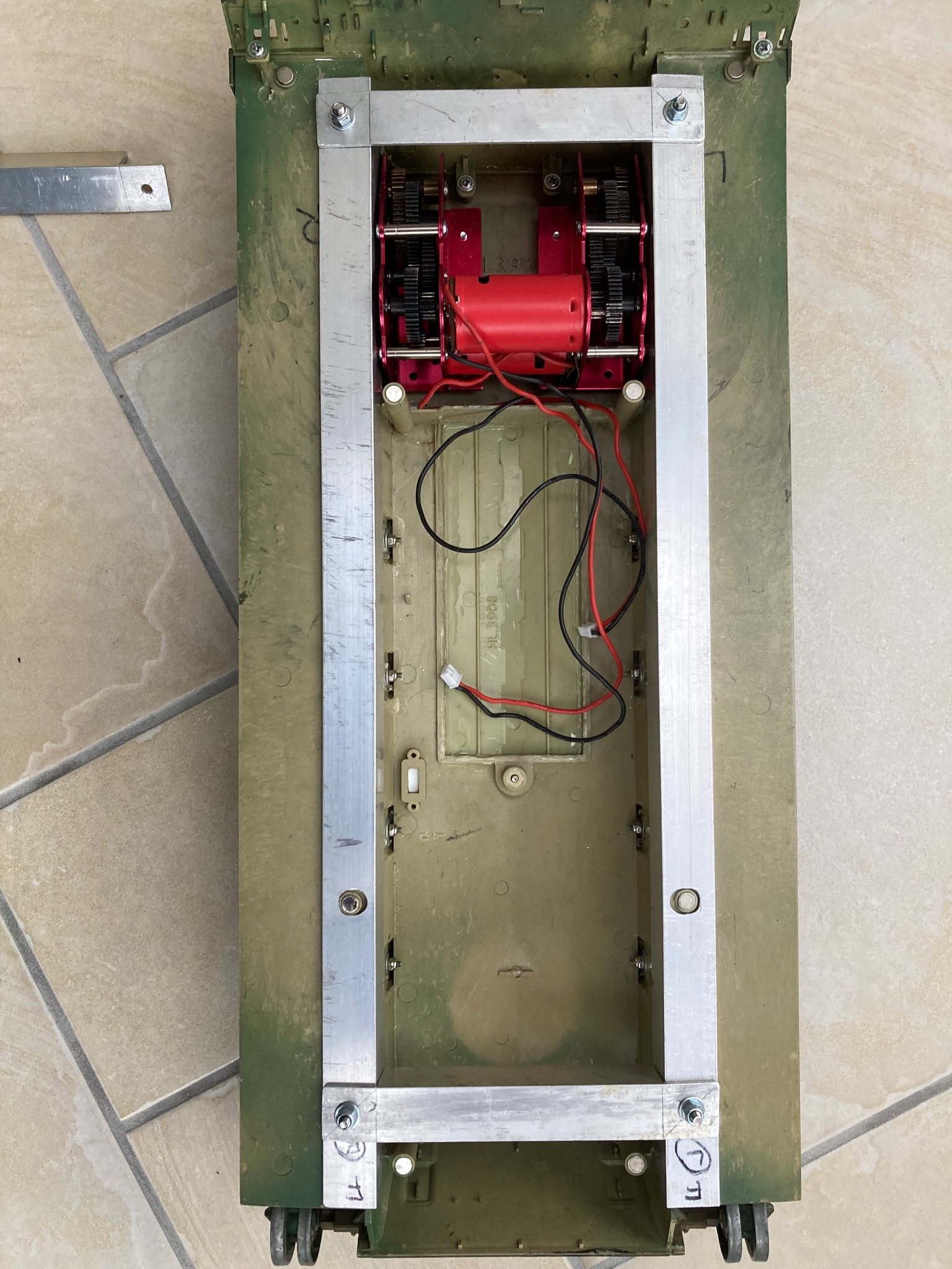

Used Challenger Strip and Rebuild. ZERO Chassis Flex
The turret was checked to see if it could turn freely with the "turret turning motor assembly" clearing the extra cross brace if it was fitted in front of the gearbox position - and it did - so I have fitted it and also added an extra pair of 4mm screws between this extra brace and the front brace.
With four 4mm screws now securing the long chassis rail on each side (8 in total), and the additional third cross brace added, the chassis now has ZERO flex or twist even when applying a fair bit of muscle to each end of the chassis, so hopefully this will help to stop the tracks being thrown off when being driven over very rough terrain.
The front cross brace was also turned through 180 degrees (to face the other way) and that has allowed the speaker box to be moved forwards (underneath it) by almost 20mm to maximise the available space for the Clark TK24CH board and the LiPo battery pack inside the tank.
Once the 12mm x 4mm stainless Button Head screws arrive I think it will look quite tidy, and with 8 fixing points now holding this frame to the moulded plastic chassis I have doubled the number of screws that can help to "spread the load" across it a little better than the original 4 would have been able to do.
I have enjoyed making this chassis brace along similar lines to the one that Meter rat made and fitted to his Heng Long Challenger 2, and I hope that it will perform as well as his has done.
If this chassis reinforcement works well, I will make another one (slightly modified) to fit my Challenger 2 "Rat Catcher" project that I am slowly working on in the background, but first I want to get this used Challenger 2 fully "sorted" and back in action again.
- Extra cross brace frames the engine compartment.
- 44F7B3D4-FA9A-4D64-9ECE-46D62D96C490.jpeg (661.93 KiB) Viewed 1264 times
- Three cross braces plus two extra security screw holes prepared.
- 645DF559-6F5C-439D-8D57-4878D76EEE17.jpeg (682.07 KiB) Viewed 1264 times
