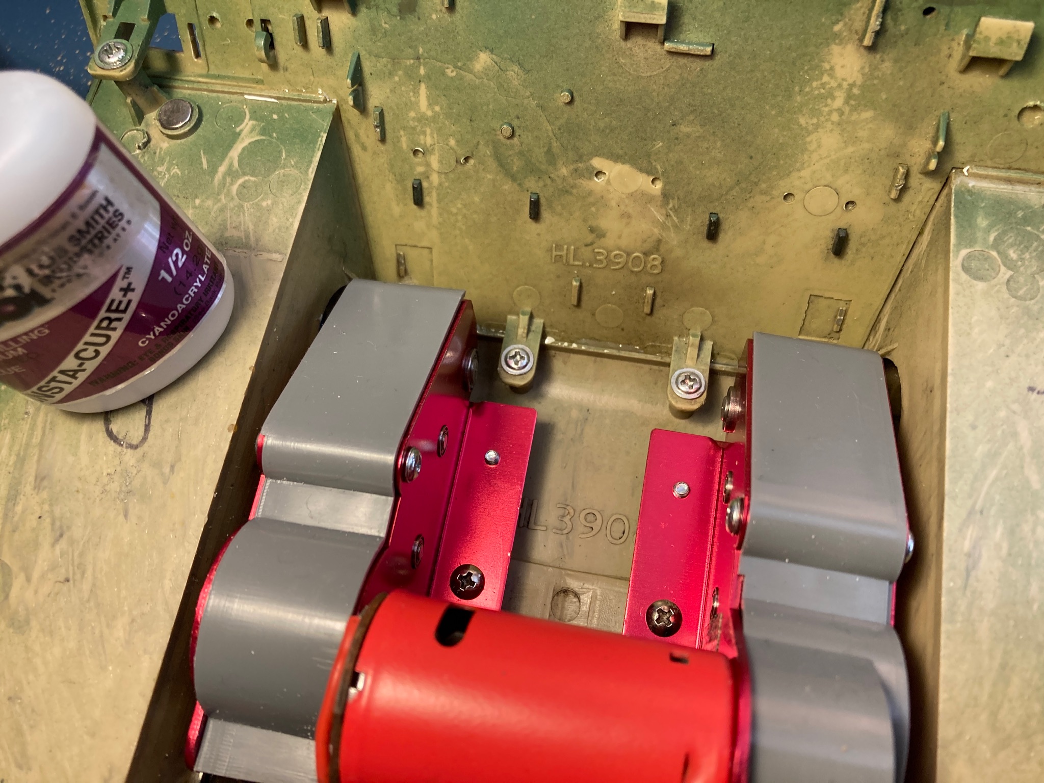

Used Challenger. Rear Hull Plate.
The rear chassis plate and all the surface area's that it interfaces with have been cleaned and it has been reinstated with the original 4 mounting screws and glued all the way around to seal it.
Hopefully this will stop any ingress of water and mud etc that had been able to enter the hull through this joint previously.
I have also fitted a pair of the grey coloured gear covers to help keep any excess grease from being thrown out.
The above two small mods should help to keep the inside of the hull clean.
- Rear hull plate glued and sealed. Gear covers also fitted.

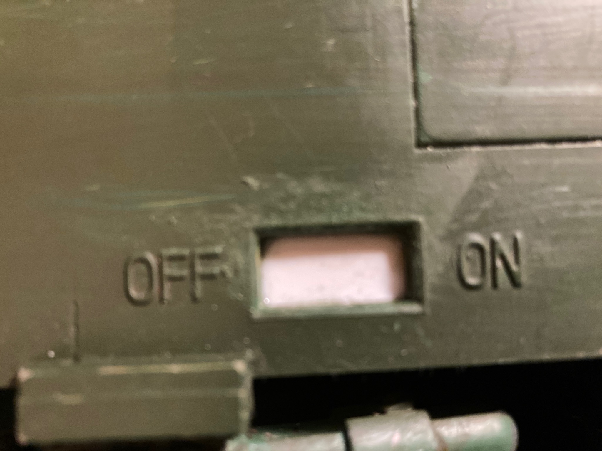

Re: Used Challenger Strip and Rebuild.Block the Switch Hole.
A piece of 2mm plastic has been cut and glued into the hole where the switch usually resides under the tank!
This was left open and so any mud/water etc could find its way into the hull through this open hole, so now it has been blocked to help keep the inside of the hull a little better protected.
- The plastic plug is a good tight fit and super-glued in.
- FC3A81CD-6EDD-487C-BA78-E5E986ECB7B0.jpeg (556.21 KiB) Viewed 852 times
