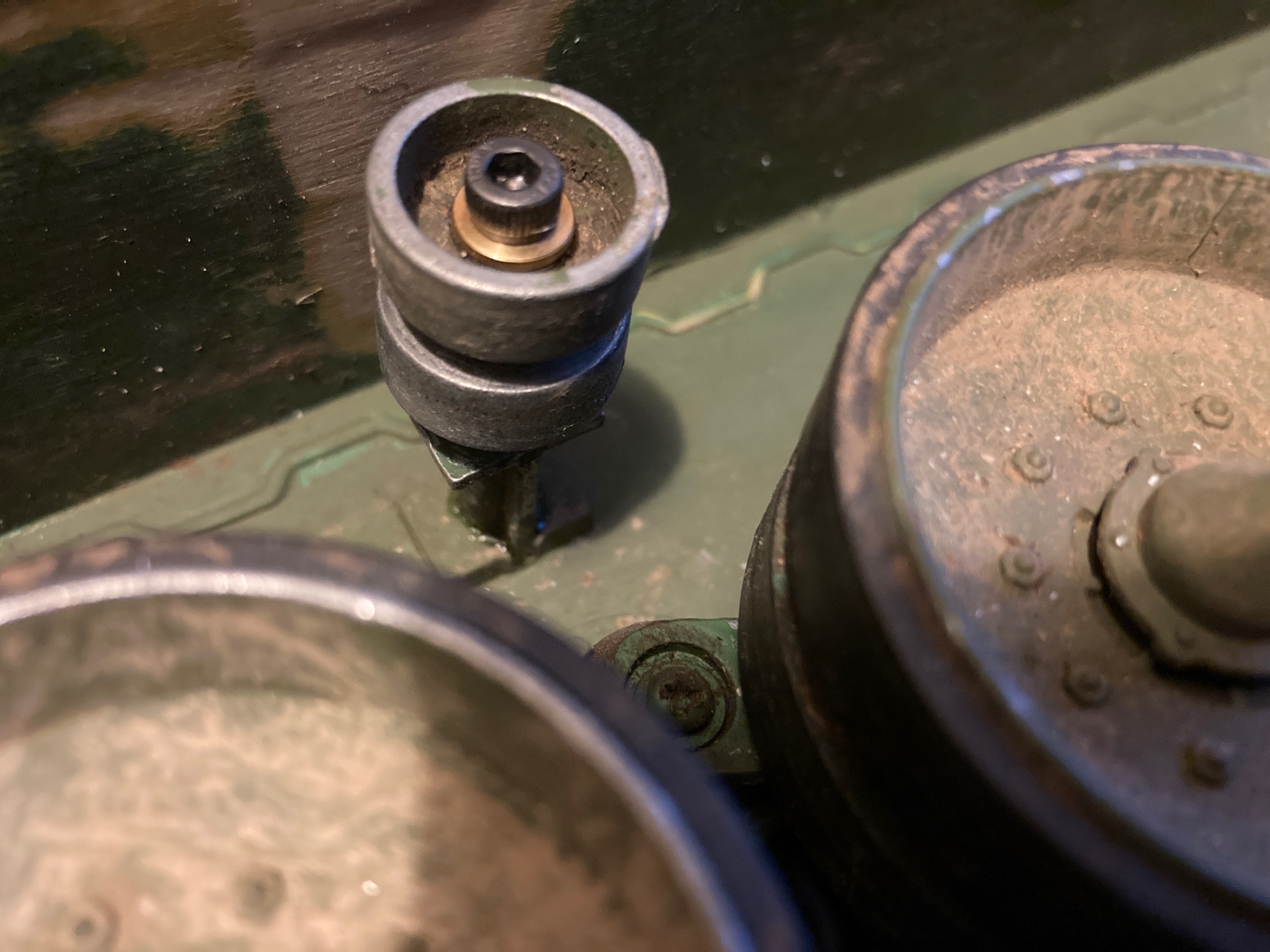

Used Challenger Strip and Rebuild. Broken Return Roller.
As working my way around the tank I noticed than one of the return rollers was held on with an M3 cap head bolt with a thick brass "washer".
This stood out against the tiny small dome shaped screws that were used on all the other rollers - so I decided to take a look and see what was going on.
As I started to unscrew the cap head bolt, it more of less fell out in my hand revealing that the axle part of the metal casting had been snapped off, and this bolt had been used with a brass eyelet to cobble it together.
Just AFTER I had found and ordered the materials to make a better job of this repair (!), I recognised that these metal wheels were identical to the ones that I had recently purchased from HAYA to fit on my new Challenger 2 tank (!) so I contacted Andrew and was pleased to find out that I could have bought a full set of these alloy roller mounts for less cash that I had just spent on the materials to make a decent repair of the broken one (with enough material left over to repair all the others if they proved to be fragile in use).
I ordered a set from Andrew at HAYA to make a nice simple repair.....and the materials that I have ordered will come in handy for something.....hopefully....in the future....maybe.
- Botched repair looked odd.
- 83BCA00D-6155-4E8F-A1B0-2EFB82C93EEA.jpeg (604.64 KiB) Viewed 931 times
