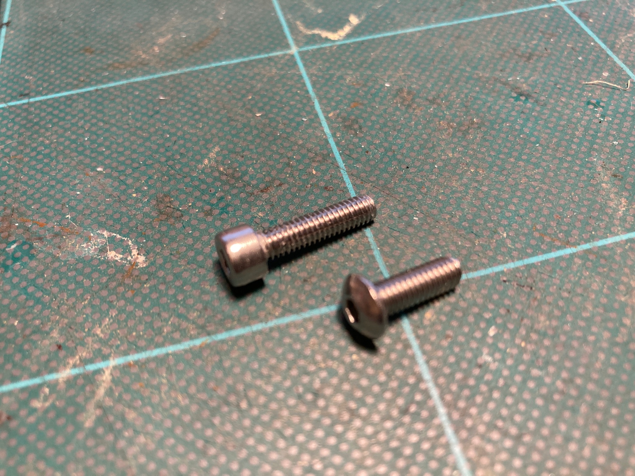

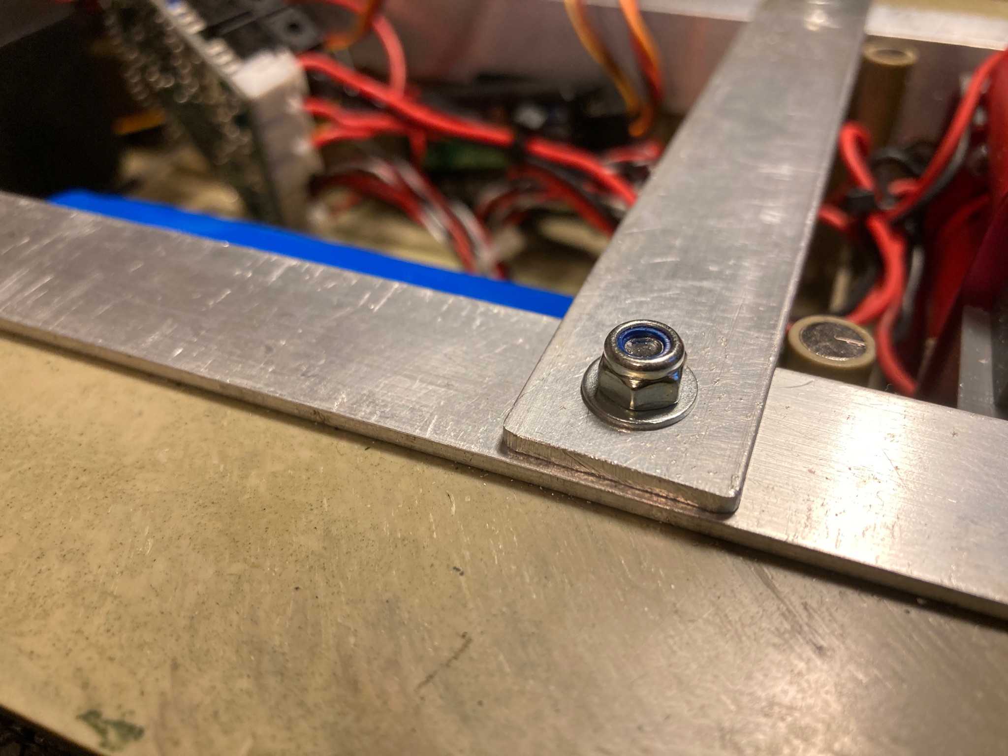

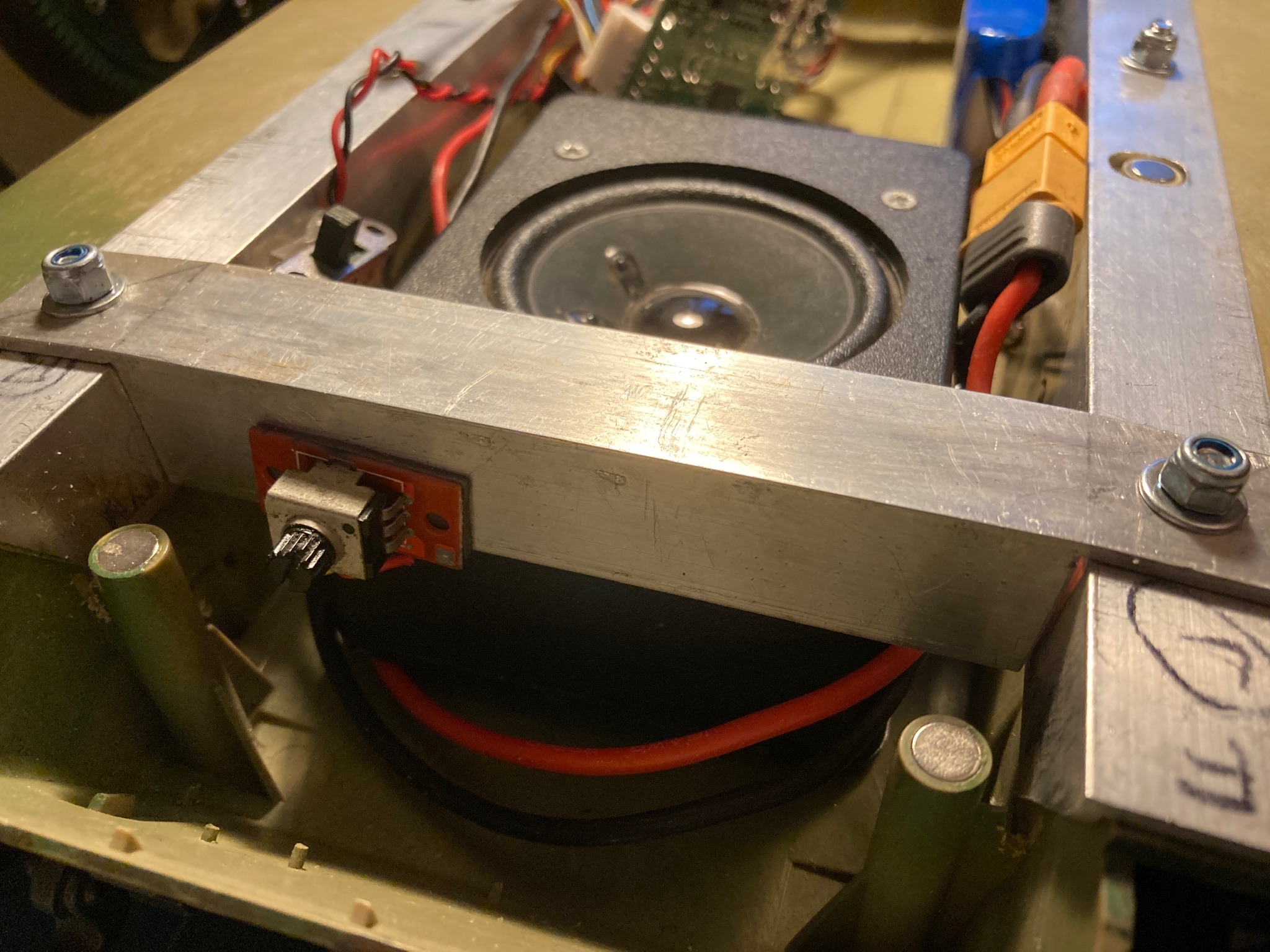

Used Challenger Strip and Rebuild. Turret Turn Problem Now Sorted
The 16mm stainless steel cap head screws (that I had temporarily used to hold the alloy chassis frame to the moulded plastic hull) have been removed and replaced by new shorter stainless steel 12mm long button head screws.
These new shorter screws give a much neater fixing and also gives more clearance to the underside of the hull where the tracks turn very close to these screw heads underneath.
Changing the screw head shape from cap heads (cheese heads) to the new lower profile button heads (round heads) will also allow any part of the track that may come into contact with them to slide over them rather than crash into the vertical side walls of the cap head screws.
This change of screw head shape will give smother running when the tracks flex over rough terrain or when running with a less than "taught" track tension.
The turret no longer "walks" the top deck forward over the lower hull (when it is turning) as the shorter central chassis frame mounting screw does not come into contact with the underside of the ring gear. Marks on the underside of the ring gear show that it had been touching this central mounting screw before it was shortened.
- Volume control and front mounting pillars.
- AED08397-38A9-4591-ADB9-94B2D81113C1.jpeg (656.69 KiB) Viewed 2154 times
- Shorter central mounting screw now clears ring gear.
- AA41E0D0-50FE-4BEB-BCA1-037718D20AAD.jpeg (557.43 KiB) Viewed 2154 times
- Neat shorter screw fixings - much tidier.
- A565F7AD-E781-4898-BCB4-913BBEDDA786.jpeg (583.54 KiB) Viewed 2154 times
- TK24 allowed to lift to help stop cables and joints being fractured. Note only 3 fixing screws for ring gear!
- B574B09B-5DE1-47A1-8ED9-630821BD46DC.jpeg (807.15 KiB) Viewed 2154 times

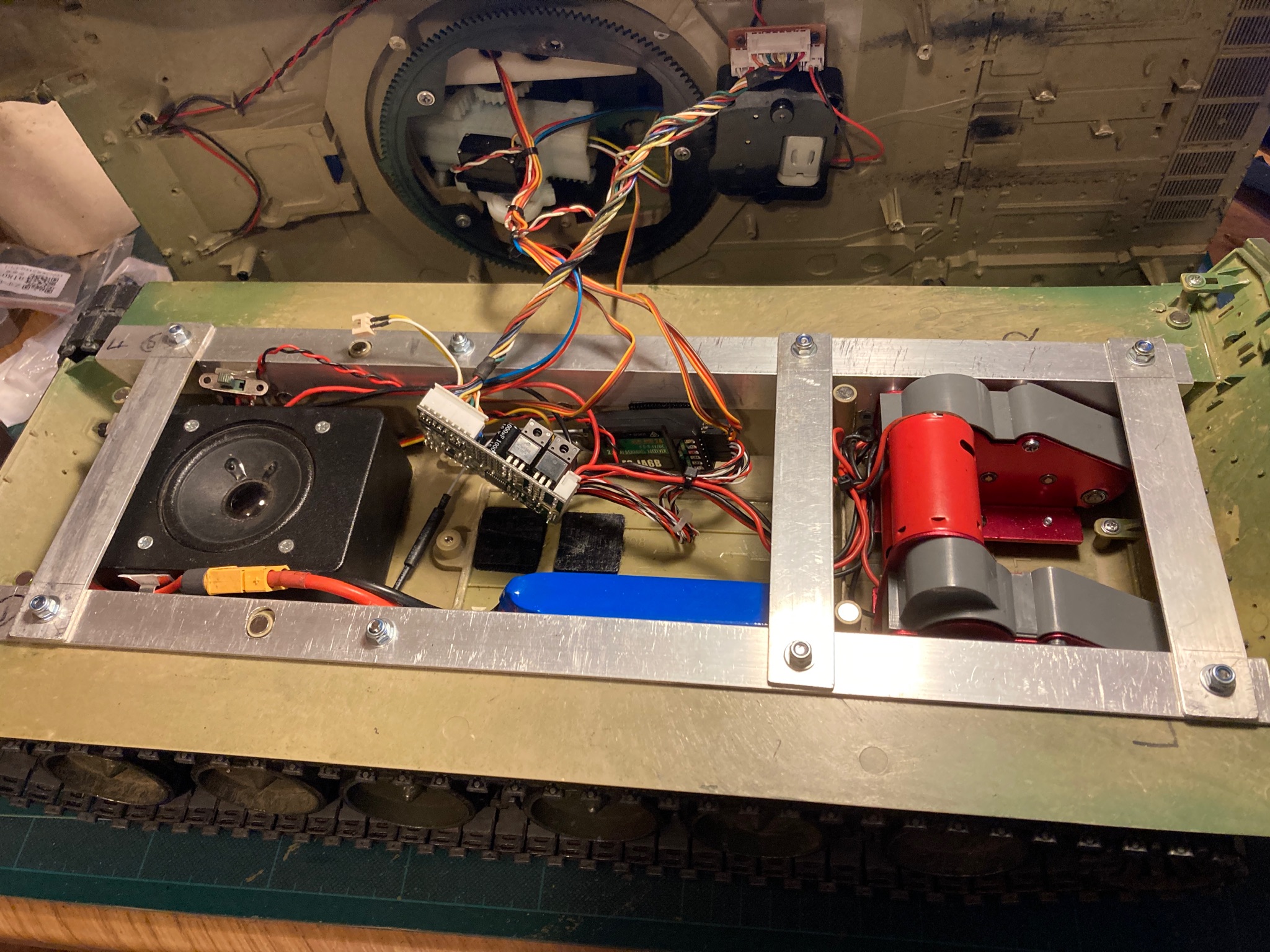

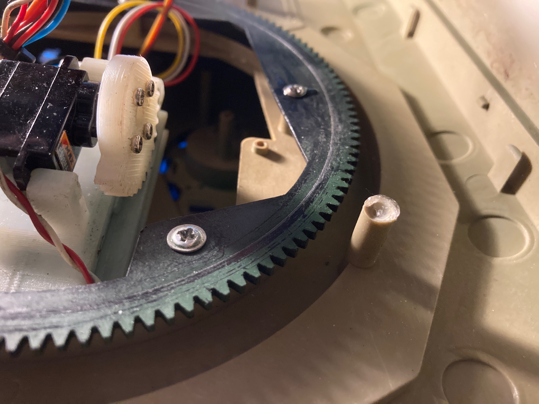

Used Challenger Strip and Rebuild. Holding the Deck onto the Hull.
The Challenger 2 was designed to have the upper and lower halves of the hull held together with 8 self tapping screws.
These 8 self tapping screws also help to prevent hull flex as when the two halves of the hull are firmly screwed together they form a fairly rigid monocoque chassis assembly.
When the drive battery is relocated inside of the hull and access is needed to change the battery and to gain access, these screws are often removed and replaced with magnets of some sort or other.
This particular used Challenger 2 is in a bit of a mess as far as these fixings points are concerned.
Most of the 8 moulded pillars that would have had the ST screws inserted into them from the underside have been split, fractured or broken off - no idea why - because most owners who converted to magnet fasteners would have made good use of these pillars as a magnet support or a mounting reference anchor point.
Even one of the 5 moulded pillars that the ring gear is screwed onto has been snapped-of (!) and one has has the screw thread stripped - leaving only 3 of the 5 fastening points to hold the ring gear in place!
I need to make a fair bit of repair or reconstruction around these pillar areas to create a platform for mounting either a) fixing studs to locate into the remaining lower pillars that are still present in the lower hull, or b) possibly to hold matching round magnets to grip onto the small round magnets that have been inserted into the lower pillars....or c) a combination of both depending on the damage inflicted in any particular area and the best way to repair/reconstruct it.
..........and d) reconstruct and repair two of the five moulded pillars to hold the ring gear on securely.
The alloy frame will prevent any chassis flex, so only a suitable retaining system needs to be devised to keep the two hull halves TOGETHER and ALIGNED.
The use of some larger sized rectangular shaped magnets mounted on (or close to) the alloy frame parts will also be considered to give a better "grip" between the upper and lower hull parts with some form of mechanical alignment to prevent any "wander" that most magnet retaining systems suffer from as they fail to prevent any lateral movement - even if they keep a strong enough grip on the two main hull halves to stop them coming apart - they often fail to keep them in the correct position.
- Four of the 8 fractured pillars had screws in them to try to hold the two hull halves together.
- 5172871C-ED73-4F8F-9322-2D052C260CF4.jpeg (647.55 KiB) Viewed 2148 times
- This pillar was cut off. Note the missing ring gear screw screw and pillar !
- 6C26D701-1F2E-463A-B5AD-006B6AA12F73.jpeg (603.27 KiB) Viewed 2148 times
- This pillar is broken off.
- F64FD94D-F350-49D5-8248-ED6E81B7BA82.jpeg (651.78 KiB) Viewed 2148 times
- Two more upper pillars fractured off.
- 8CD42AE4-7139-48A8-81D3-511E3B2F8C04.jpeg (557.43 KiB) Viewed 2148 times

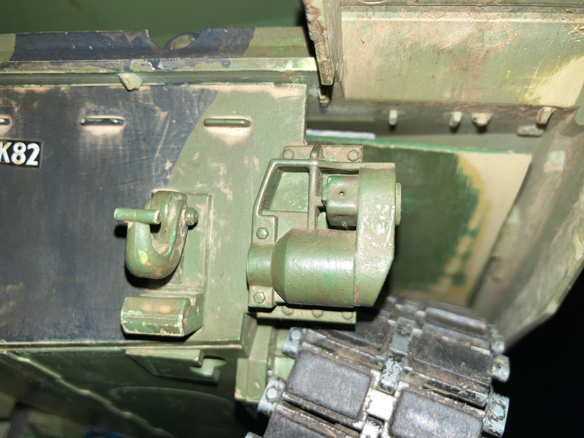

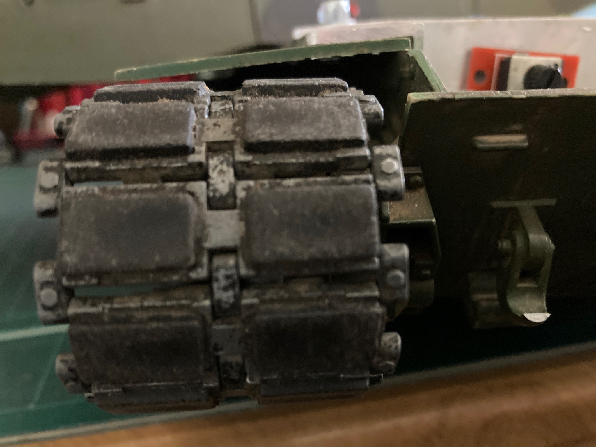

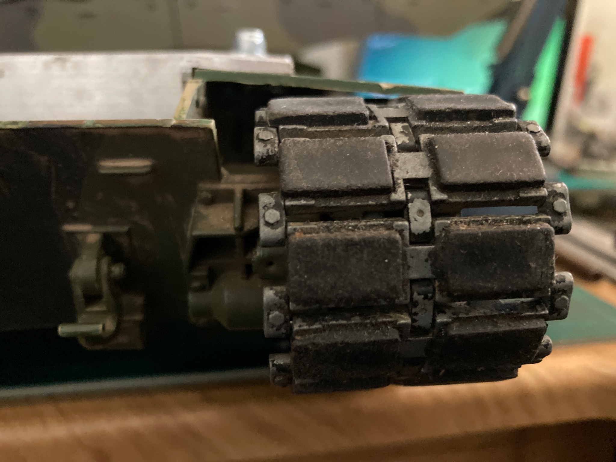

Used Challenger. First Run and Track Rub.
I took this used Challenger 2 to our local club for its first proper run last night, and overall it performed very well.
The TK24 worked OK and I was able to find all of the functions (on demand) so that was very satisfying as it is running with all the drive controls on the right hand stick and everything else (Sound on/off, Drive on/off, MG with flash, Lights on/off, Main Gun with flash, MG2) on the left hand stick.
A strange sound when driving (a bit like a cross between a squeal and a rubbing sound) was inspected and it was found that the tracks were rubbing against the underside of the moulded chassis - at the front above the return wheels.
The metal tracks are rubbing at a point just on top of the front return wheels. I am not sure what to do about this as the I don't have adjustable track tensioners on this early model so they are fixed in the position that they would have left the factory with.
In all fairness, I remember the seller saying something was rubbing somewhere - this must have been the area he was referring to as I can see no other places that are rubbing anywhere. The rubbing away of the plastic and paint in this area suggests that this has been the case for some time.
I had wondered if adding the metal frame could have contributed to this problem - but if anything - the fame is helping to lift this part of the hull away from the track at this point!
I notice that the front return wheels have a "negative camber" and so they are mainly rubbing on the outside edges of the tracks.
My first thought is to cut away the flange in the area that the tracks are rubbing it. I can't see this doing any harm and at the moment I can't think of an alternative - other than letting it continue to rub as it must have been doing this since it was new?..........or maybe since the metal wheels and tracks upgrades were fitted?
The RED motors powered the tank along nicely, but it must have been a bit like driving with the brakes on! I rather suspect that the tank will run smoother and faster once the drag brake has been removed.
Checking my other Challenger 2 (that is waiting for some attention when this used model is finally "sorted"), I noticed that the metal tracks on that one also run VERY close to the underside of the moulded chassis at the same point above the front return wheels. This is a much newer model that does have adjustable track tensioners, so maybe that is the difference between the tracks rubbing or not rubbing at this position when metal tracks are fitted?
- Right hand side not quite rubbing the tracks.
- 01BC054B-5013-42CB-82E7-E31B3719DFA3.jpeg (588.63 KiB) Viewed 1978 times
- Left hand side rubbing the track. Note negative camber.
- 322C5CE3-F605-4038-9670-AEC28CC99D67.jpeg (616.94 KiB) Viewed 1978 times
