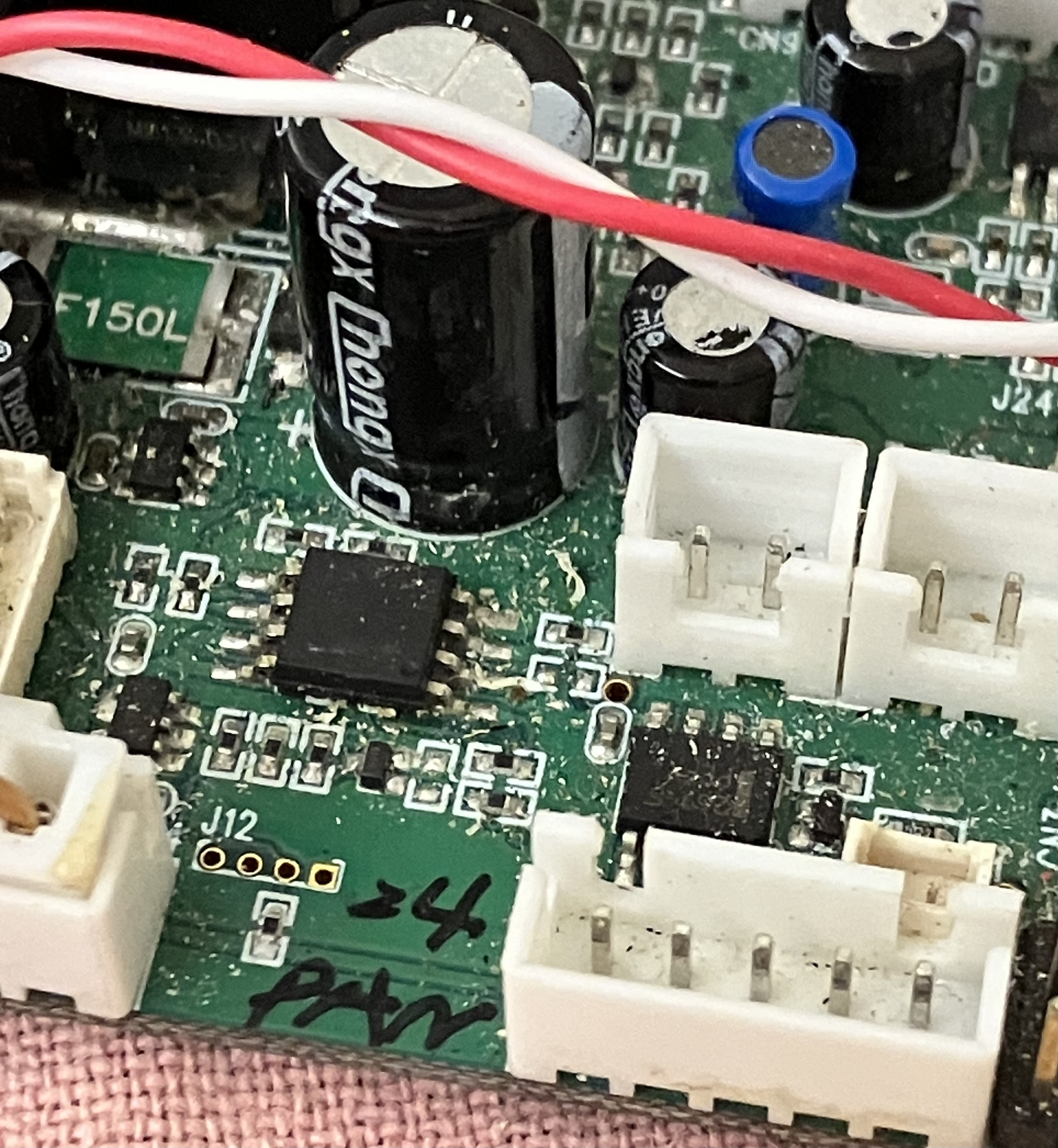

TK24 CH Under Control - At Last!
After checking the board that is in my used Challenger more carefully, as well as having the TK Series stamped on the back, it also has CH written on the front in fine black pen so I am fairly sure that it is indeed a TK24 CH.
Today I experimented some more to try to find a positive way to switch on the DRIVE and the SOUND and think I may have finally cracked it!
By moving the left hand digital trim upwards until the top of the marker falls directly in line with the top of the "box" that underlines the name of the model, I am able to switch on the DRIVE by moving the left hand stick fully across to the left and I can switch on the ENGINE by moving the left hand stick fully across to the right.
Both the above operations completed with the left hand stick held by the spring in its centralised position WITHOUT the turret turning.
Previously, with the left hand vertical trim set at neutral, any movement to the left or right would turn the turret and make switching on the DRIVE or SOUND functions difficult to achieve - and impossible to achieve on a regular basis even with a lot of experimentation with the stick position held just above the neutral position. The turret control took over completely every time.
With the trim dialled in to the slightly raised position (described above) I can switch on the DRIVE and the SOUND before any other functions take control of the left hand stick unit.
Following the above two functions activation, I can either turn the turret with the stick held slightly downward against the string tension as I move it from left to right, or I can slide the digital trim back down to neutral and just operate the turret turning with the stick held in the neutral position by the stick units spring tension.
I can also turn the SOUND and DRIVE off by sliding the trim up to the new designated position and activate these tow function without the turret turning. Absolutely brilliant - total control AT LAST. Who would have thought that such a small trim movement could make such a difference?
All of the other left hand stick functions remain unaffected.

The TK24 is a little different insomuch that the DRIVE has to be switched ON and it can also be switched OFF. This makes it possible just to run the engine sound on its own and rev the engine without the tank moving.
The location of the operations is different too:- Left stick lower left is the main gun with flash and lower right is the (unwanted ) MG2, and left stick upper left is MG with flash and upper right is headlights on/off.
This leaves the tricky switching on/off of the DRIVE and SOUND that has to be performed on the left stick when in its central position - the same stick position that is used to turn the TURRET left and right !
Separating the DRIVE and SOUND switching from the TURRET turning is where the left hand stick suffers from OVERLOAD and the operator/driver suffers from HEADACHES as separating these two functions requires a lot of patience and a delicate touch!
Basically those last 4 described functions (DRIVE, SOUND, TURRET left, TURRET right) all work from the same stick unit and on the same plane and are only separated by a fraction in height. My solution is to try to find a reference point that can be repeated on demand by using the digital trim and referencing the position with its location against a line that is already printed on the screen under the model name.
