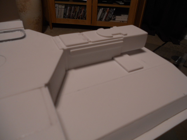

Did the rear winch housing today, which turned out to be rather more complicated than it looks, I skipped one part of the upper detail as I didn't realise that there is supposed to be a recess between the two sections on the upper surface. The pics I am following for this build are sketchy to say the least, but hey ho, I am now learning to triple check everything.

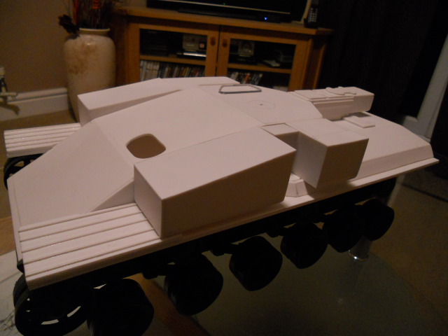

The detail is truly maddening. I spent hours making all of the drivers hatch hinges etc, and it all worked including the hydraulic damper, then as I glued the very last part into place with a cocktail stick one tiny dribble of superglue ran down and locked the whole thing solid. Luckily it was in the open position, but I daren't try and get it working again as the whole thing is quite fragile and I just know that something will break.

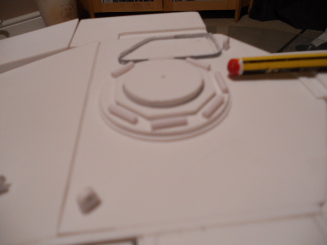

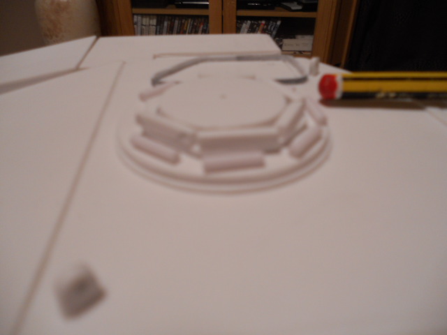

I then moved on to the commanders hatch. Again, hours spent cutting circles of styrene, one of which is an eight sided jobbie. It is being built in situ, using a micro drill in the centre to align the layers. Trying to guess at what Armourama had cast in resin from the pics on 1/35 build sites was taxing to say the least, and as with all tanks, pics of the upper deck are always rare. I was looking at the periscopes, when Iain sent me through a couple of links he had found. What the pics don't say is whether they are from a Mk2, 5 or 7, but they all appear to be similar.
http://data.primeportal.net/hoare/charv ... HATCHS.htm
These confused the hell out of me late last night, but taking a fresh look this morning I realise that the periscopes are only at the front. However, there are cut outs at the rear of the cupola, and what I don't know at the moment is whether there shouldn't be any persicopes there, or whether someone removed them?
The Armourama build pics appear to show periscopes all of the way around, so I am going with that idea.
http://armorama.co.uk/modules.php?op=mo ... _id=118387
So this where I am at the moment, just need to bevel off the periscopes and glue them on, then start on the next layer.
