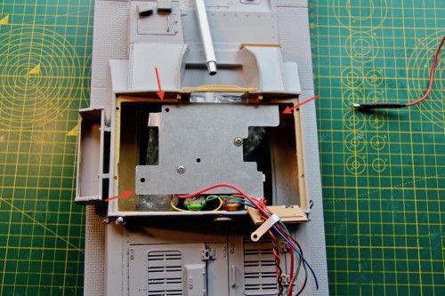

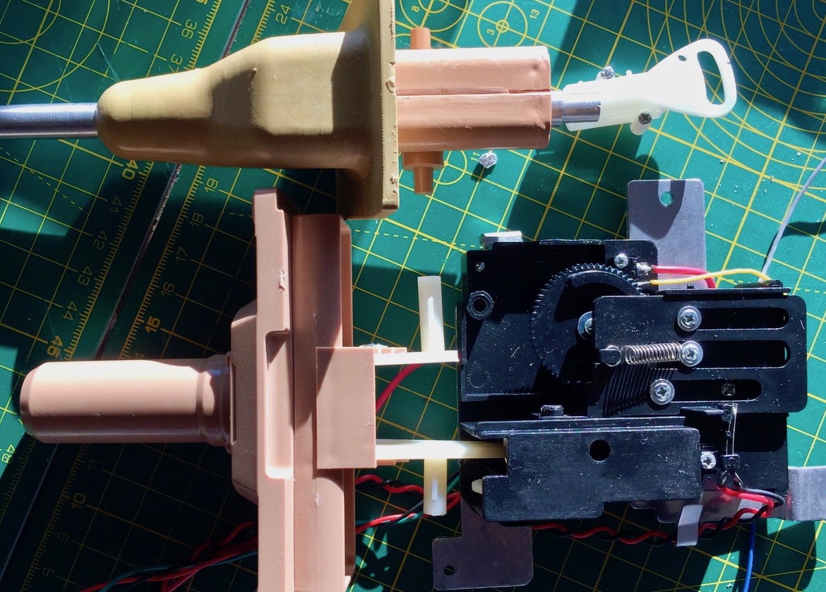

This next stage is going to be the trickiest. For one thing, I've not had much luck with the Asiatam/Taigen all-in-one recoil elevation units so far. The one I bought for the Cromwell was too problematic to fit in the end, but simply wouldn't work properly. One of the motors was a dud; but I really couldn't be ar*ed to send it back. The one here is for the Tiger 1. I chose that one because it has a useful looking metal bracket with which to cobble together an internal fitting arrangement, in a casemate space entirely bereft of fitting lugs and flanges. Fitting one of these will be as difficult as it was with the scratch build Cromwell, as that was also devoid of all embedded fitting lugs.
Things haven't got off to a great start.. :/ (The Asiatam Curse inflicting it's supernatural evil once more >:< ), as the white and blue leads that are meant to connect to the units on/off switch managed to fall off when I unpacked it from the box it arrived in. The soldering on these units is diabolically bad.
Anyway, the first thing its to make a working breech and Saukopf (Sow's head) pivot support.
These are the bits supplied with the kit, together with the Tiger 1 recoil unit:
StuG IV - Gun assembly components
If you're wondering why I didn't buy the Pz 111/IV unit, the answer is simple: apart from the colour they're dimensionally identical. The Tiger 1 unit does come with the alloy bracket though. That's why.

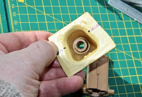

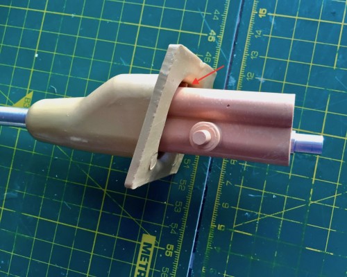

This is how the breech unit fits into the Saukopf:
Asiatam StuG IV breech and Saukopf assembly pic A
The internal (f) lugs are meant to mate with the (m)boss on the breech, as per the red arrows.

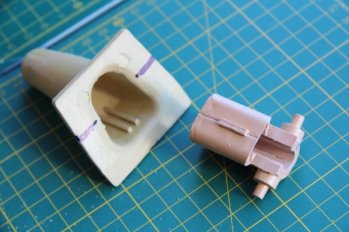

Two things become immediately apparent. Firstly, when the breech unit is pushed into the old Sow she has the effect of clamping down on the barrel. Thus making it impossible to slide in and out... :shifty:
Secondly, when offered up to its designated aperture in the casemate, there is not nearly enough leeway for the recoil unit. In fact, it won't fit.

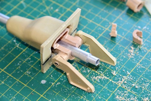

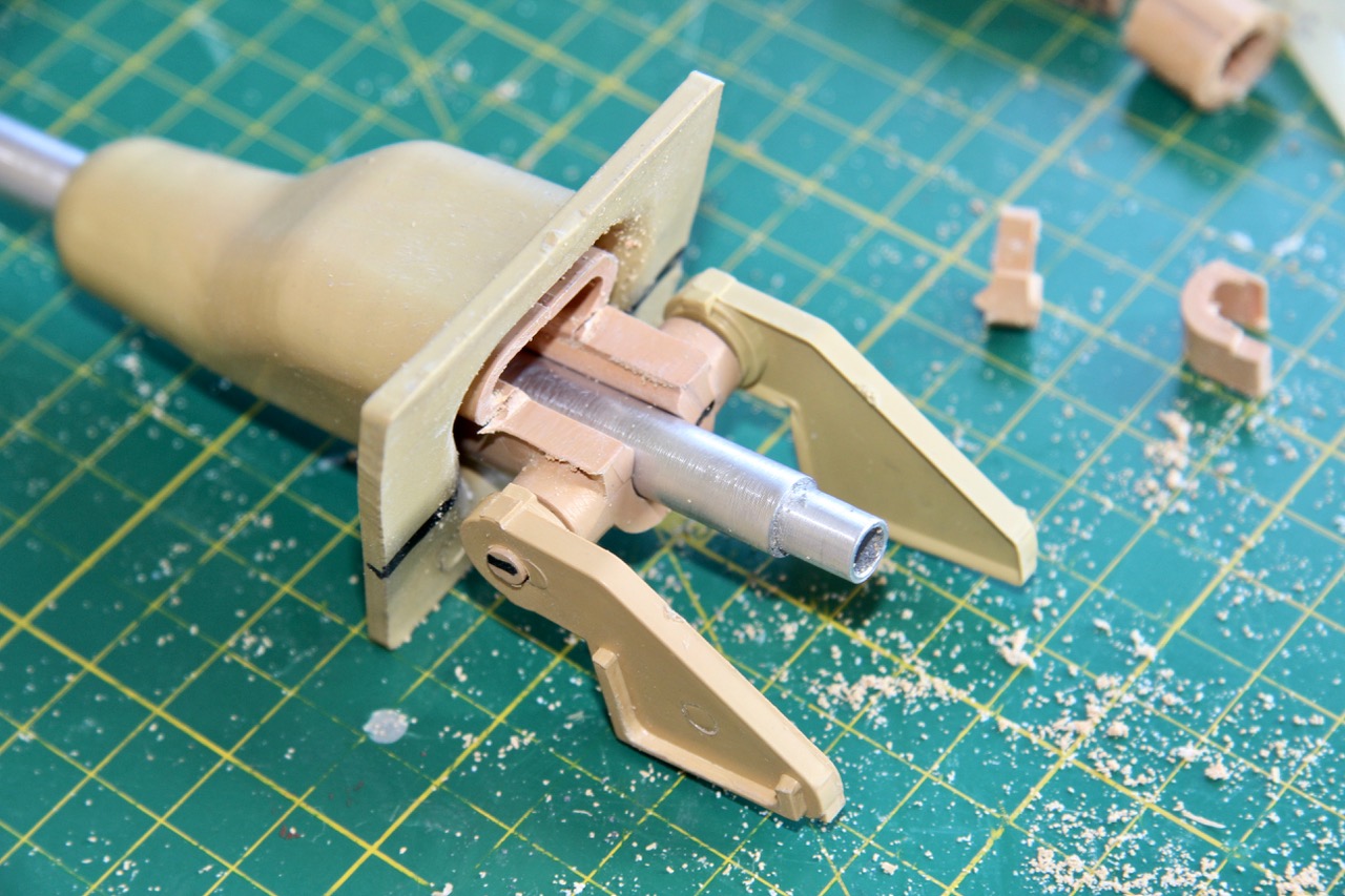

Thus, some surgery was needed on the breech. I cut part of it off and bonded it into the snout as a sort of bearing for the barrel.
StuG IV- bearing for barrel in Saukopf snout.

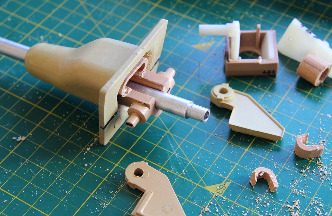

Then shortened and trimmed the remaining breech unit drastically:
StuG IV-modified breech fitting

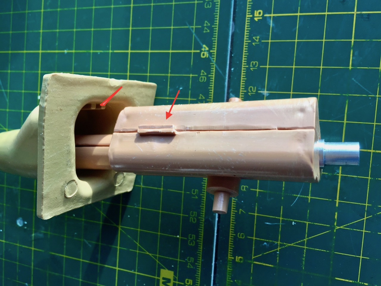

This was then bonded in place with Epoxy. Later, I filed and sanded the unit to allow the barrel to slide..with ease ( greaseless fit :lolno: )
Put together, the assembly looks likely to intrude on the casement space a lot less:
Modified breech assembly bonded in place

and this is what it will attach to:
StuG IV- recoil unit in provisional position
The arrows indicate where I intend to make some plastic lugs to bond onto the Casemate, which will then serve support the Recoils's metal frame. That's the plan, anyway. :problem:

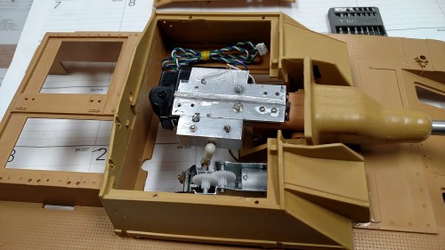

I've spent quite a while trawling the 'Net for successful installations of this unit in the StuG IV, and was surprised to find that that Arnie is probably just about the only guy to have had a measure of success. Correct me if I'm wrong.
I hope he won't mind my posting a pic of his assembly here. The ones from his thread were ransomed by the Photo highwayman, Dick 'Photobucket' Turpin @) Note that Arnie looks to have bonded his Casemate roof in place.
Note too how unbelievably limited the space is to work in. Miniature fingers are needed.Just remembered, that Painless also had some success with this unit too, although I cannot recall whether he got recoil and elevation (again..no anatomical allusions here :-< ) He's a very resourceful fellow, though :thumbup: :thumbup:

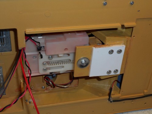

Another contributor on RCU and here on RCTW had a solution using Tamiya recoil and elevation components; but while it had promise initially, I think it disappointed later. I might be wrong. I've seen numerous other attempts to make this unit work in this context, and they all failed, it seems. It's the Everest of recoil fitting :eh: :D
Asiatam StuG IV with a Tamiya recoil setup
