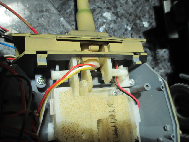

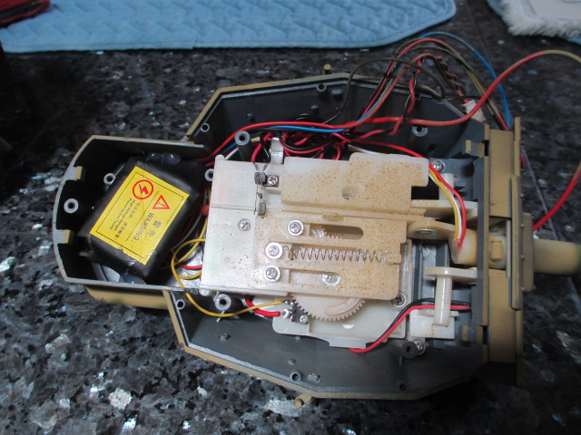

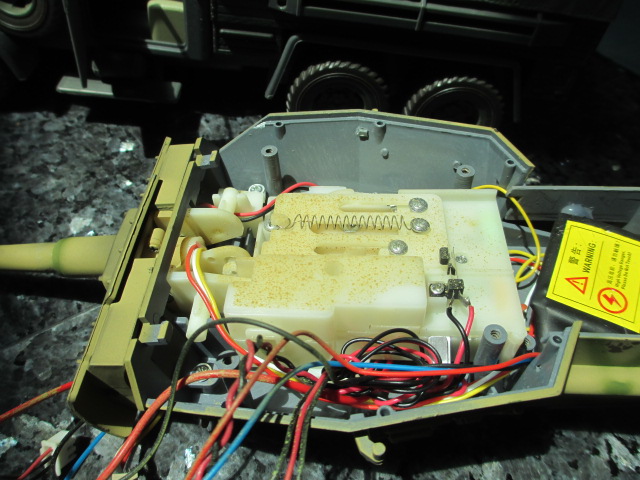

I am about to move one of those from a Taigen PzIII to a resin StuG casemate. I have a pic of it installed in the PzIII turret if that is of any use?

Thanks Painless, but I already have it in my PzIV myself. So much easier, when the mount that comes with the unit, is actually designed for the turret you want it in hehe
I was more looking for, if anyone had any tips on what to mod inside the KV turret, to have it in the correct hight and such
But I might just wing it

Winging it is the order of the day. ;o) Good luck, I'll be following along.
