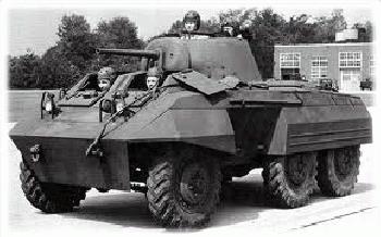

I'm building a M8 at the minute with an unpowered centre axle as the wheelbase is too short to get power from the HL gearbox...I think an unpowered steering axle would also be able to be fixed in the centre of the chassis making Saladins, Saracens etc do-able...

frankie wrote:I'm building a M8 at the minute with an unpowered centre axle as the wheelbase is too short to get power from the HL gearbox...I think an unpowered steering axle would also be able to be fixed in the centre of the chassis making Saladins, Saracens etc do-able...
One of the interesting things about this 6x6 is that it has a separate motor for each axle. That means no drive shafts to shorten. I think if you were to shorten the wheelbase by cutting the frame between the first and second axles you could make a Greyhound. Again, I think the biggest issue will be proper tires.
