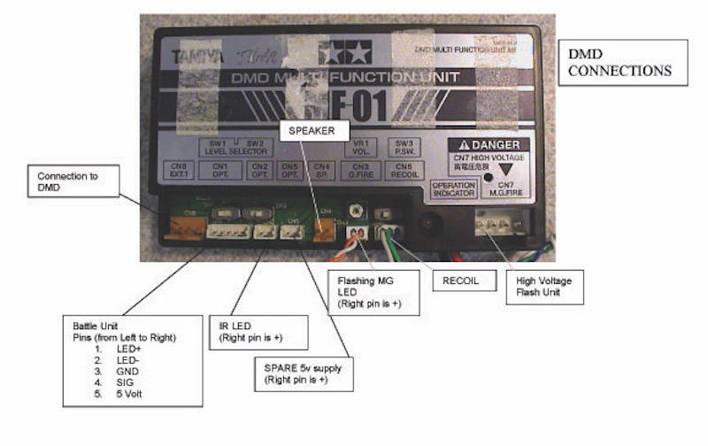

Ad Lav wrote:It’s running Tamiya electrics so unless I get a funky receiver switch for a light then it won’t work. I could swap to an elmod but paying 200 euros and selling the stock electrics is something I can’t be bothered to do.
It’s more about the looks for me! So shallow :D
Mk is due to send me a care package in the next week or so!
Now that I have the static version, I'd also wondered whether it would be economical and practical to fit a light to the rear. (This build will follow completion of the Pz IV, and finishing touches to the Cromwell..so..it's a way off yet. :D )
Axel sells the LED for the M26 Pershing-
https://www.axels-modellbau-shop.de/kat ... mlershing-
But... that's quite a price. :O The Pershing MFU (if you had a spare one like Tom) has the right connector for a light fitting, but the wrong engine sound..unless our Norwegian magician,Stian, can figure out how to flash one in :D
Then again, there's that spare 5v terminal on the MFU. With a suitable resistor couldn't that be used for a convoy light? Mind you, switching it on and off would involve extra electronic wizardry.
Incidentally, I found this useful MFU schematic on RCU recently for the MF-01:
Tamiya wiring connectors on DMD MFU unit
Tamiya Wiring to DMD unit.jpg (81.8 KiB) Viewed 3377 times

It’s a shame lights cannot be simply added to the mf unit like the Sherman/Pershing and kv by means of plugging in and switching on.
I might still go down the elmod route but part of me still wants it to be as Mr Tamiya made it, albeit with some pretty extras.

Quite agree, and one of my beefs with Tamiya is the representation of a light with an inert piece of styrene. :| In this respect, HL/Taigen/Mato have absolutely the right idea. It's becoming a well worn argument now I suppose, that Tamiya haven't tried to keep pace with the competition with electronic add ons. Just ask Rad...... :/ :shh: That said, I do enjoy the simplicity and dependability of their electronic hearts; but you could probably get and NHS pacemaker for less than a replacement
DMD pairing. :thumbdown:
